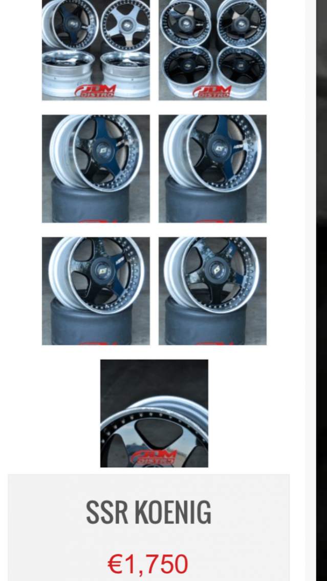

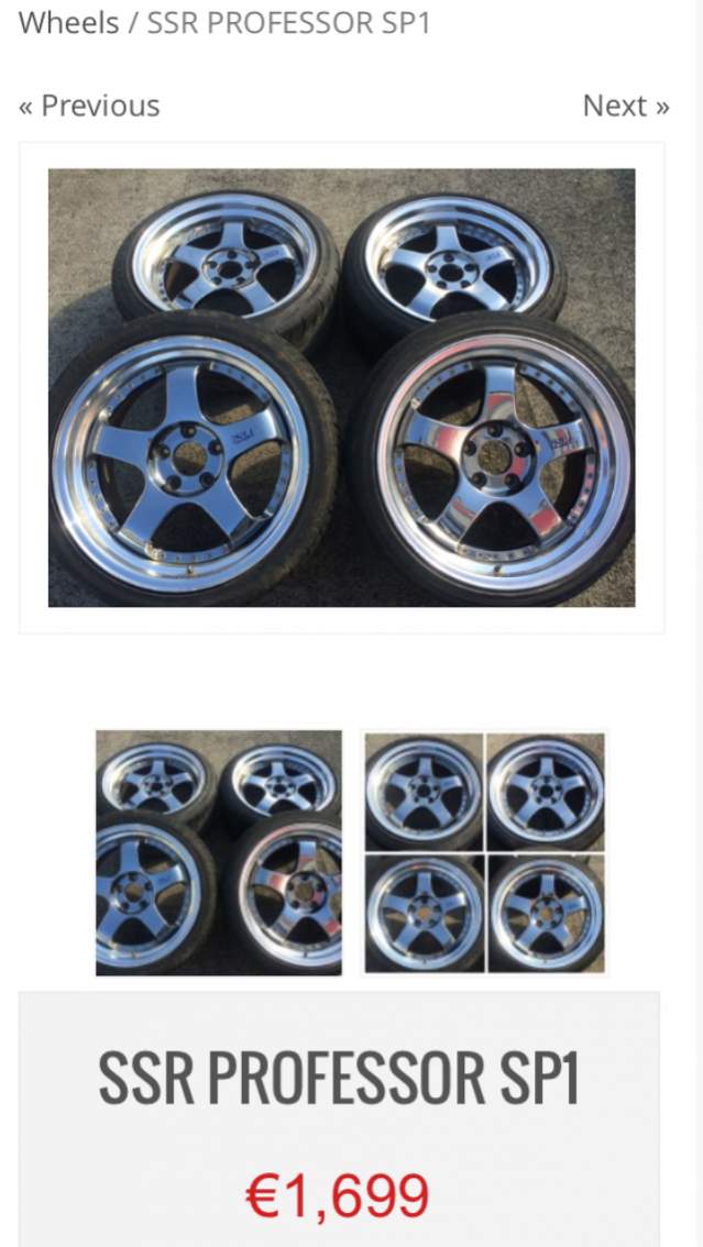

^^ you'd need some HUGE arch rolling exercise to fit those, the rears especially.
That's a pretty good price to be honest. My 19s cost me nearly £3,000 by the time they were landed and duty paid on them.

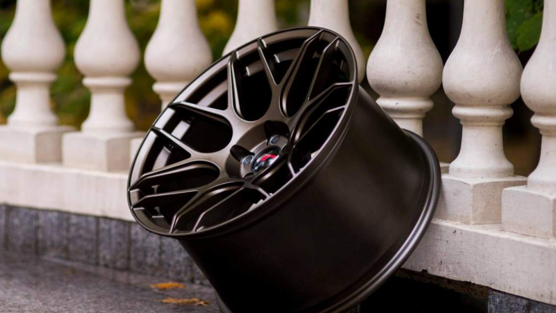

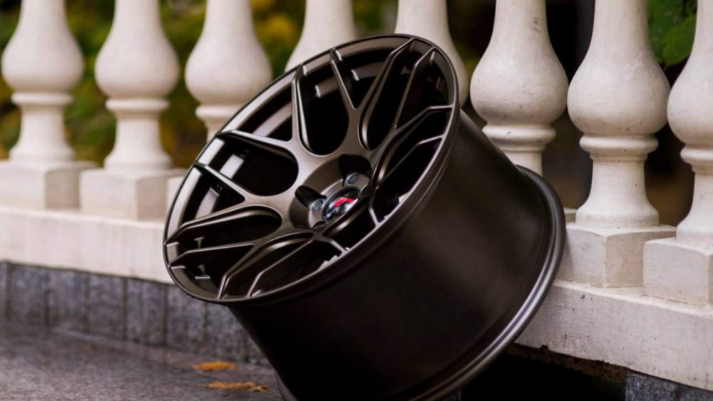

That guy also does cheaper wheels, namely "Japan Racing"
I think these would look real well on a purple Z. Pricing starts at £135 each for 18's:thumbup:

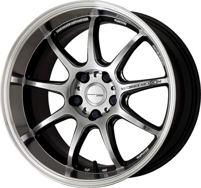

ok,
Thinking about ordering these very shortly, before I do anyone else have any thoughts on my setup.
First off this is the wheels I plan to get Work Wheels Emotion D9R.
Front - 19" - 8.5" ET30
Rear - 19" - 9.5" ET30

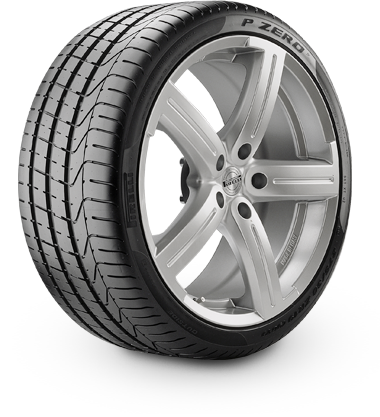

And for the tyres going with Pirelli PZERO.
Front - 235x35x19
Rear - 265x30x19
Suspension setup will be MeisterR Zeta-S and swapping over what remains of my driftworks kit.
So I have adjustable front and rear camber arms, tractions rods, front and rear lower arms, hicas bar.
I'm also getting the rear arches rolled again to make way for the larger spec wheel / tyre.
A nice wheel. Front offset is a little weak though. What other options for widths/offset are there for that wheel? I'd also go a size wider on the tyres and a 30 profile on the front.
