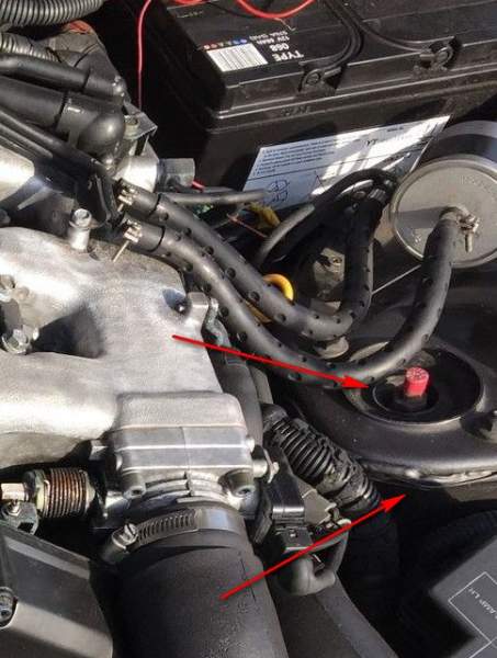

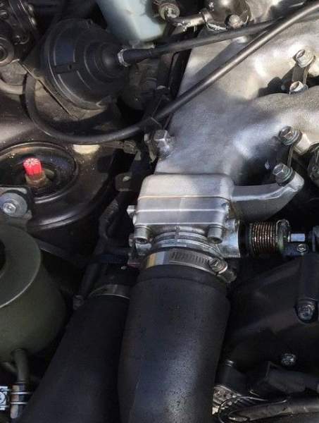

If I could draw your attention to these two potentially important issues (arrowed) on the n/s turret which should be be
taken into consideration (by way of comparison I have included the o/s turret condition):
Edited by AndrewG
What's that suggesting Andrew? Eyes like a shithouse rat!
Suggesting worn suspension and possible damaged to one of the suspension turrets (non OE welding). That damper shaft should sit centrally in that strut top bushing. It could be a result of misalignment, a bent shock shaft indicating a possible accident damaged vehicle.
