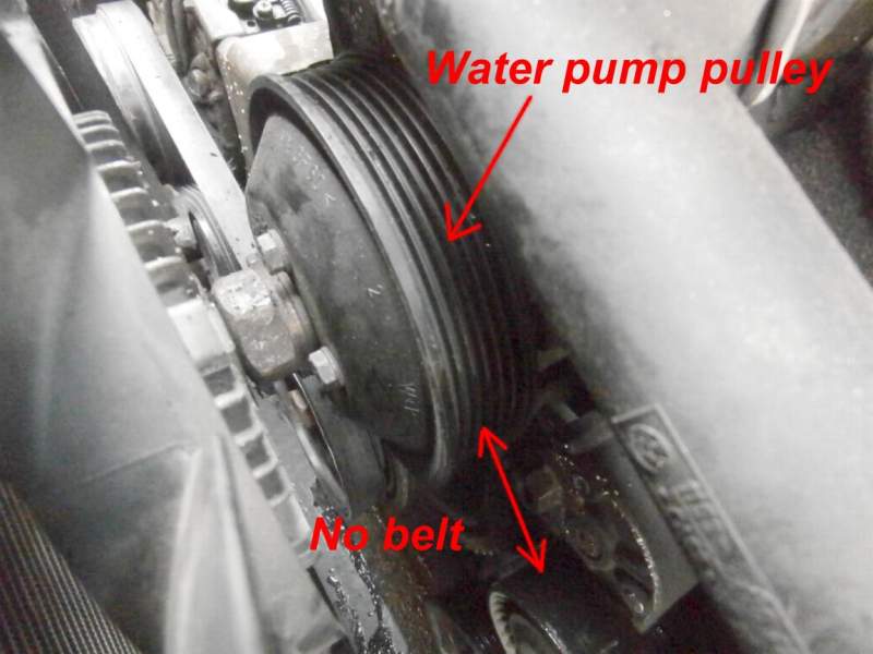

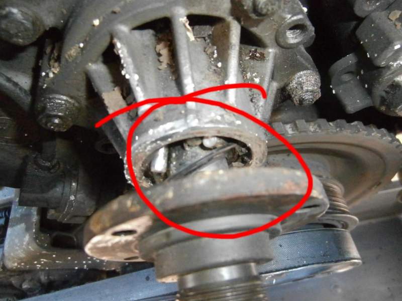

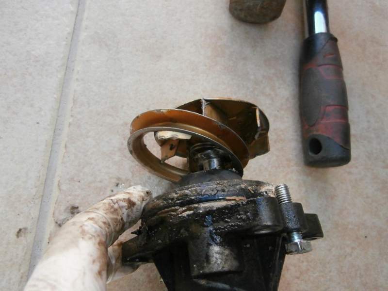

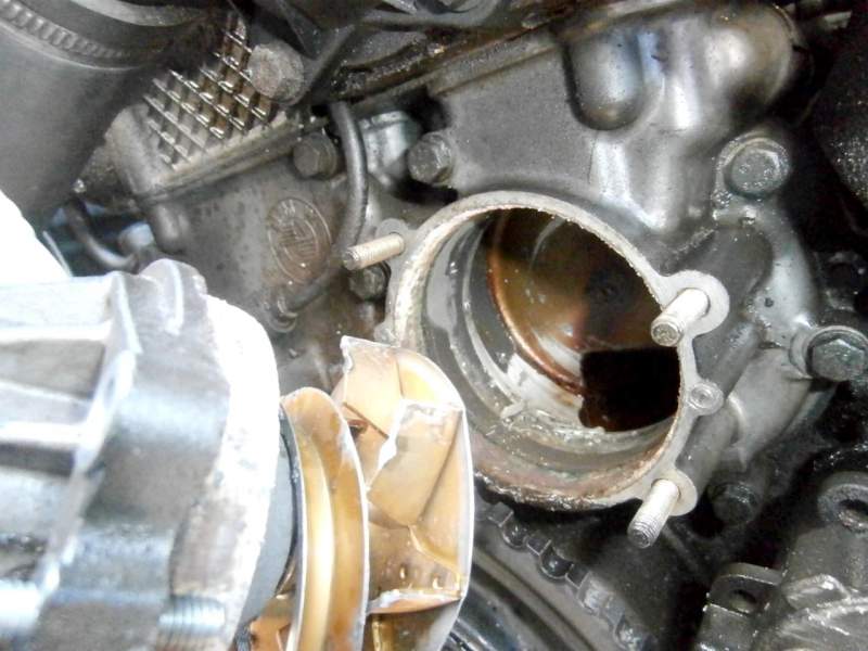

Ok not mine but helping out a local Portuguese owner from the BMW forum in pt, originally recovered from Lisbon with suspected alternator failure ( charge light on ) as soon as I drove it from the recovery truck knew it was more, no power steering ( at all!) no charge ( triggering abs fail).
Quick check around and soon found as suspected a missing drive belt, the one that ran the alternator and p/s pump, nice and easy..... but wait the belt was still there and intact but not on the pulleys?? why would a perfectly good belt come off with auto adjusters? soon found the water pump seized, well in a fashion.

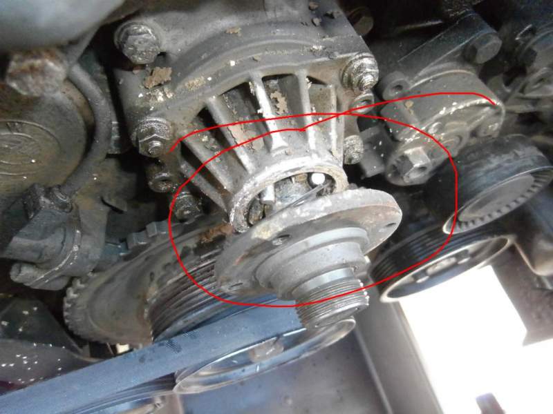

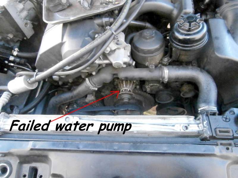

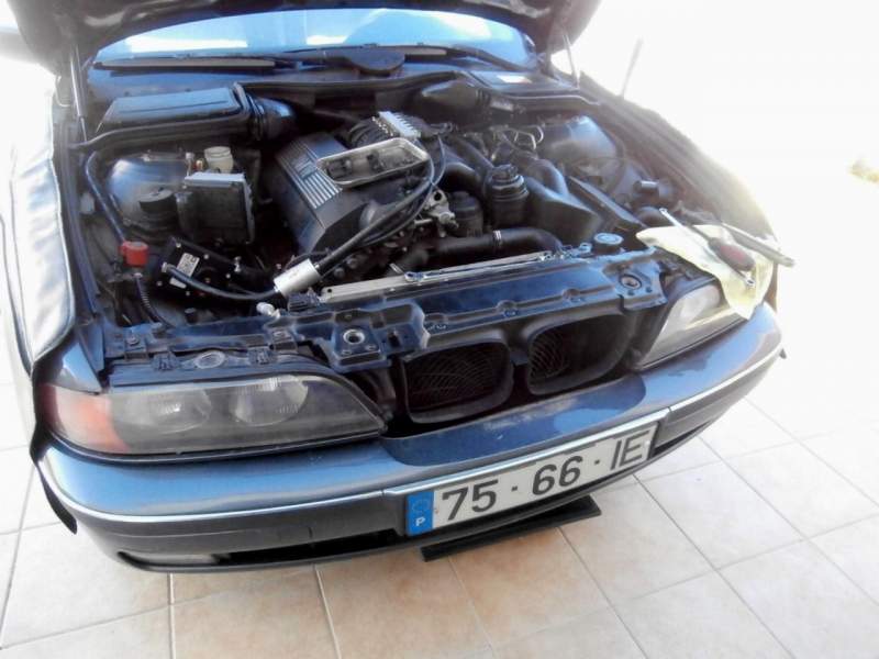

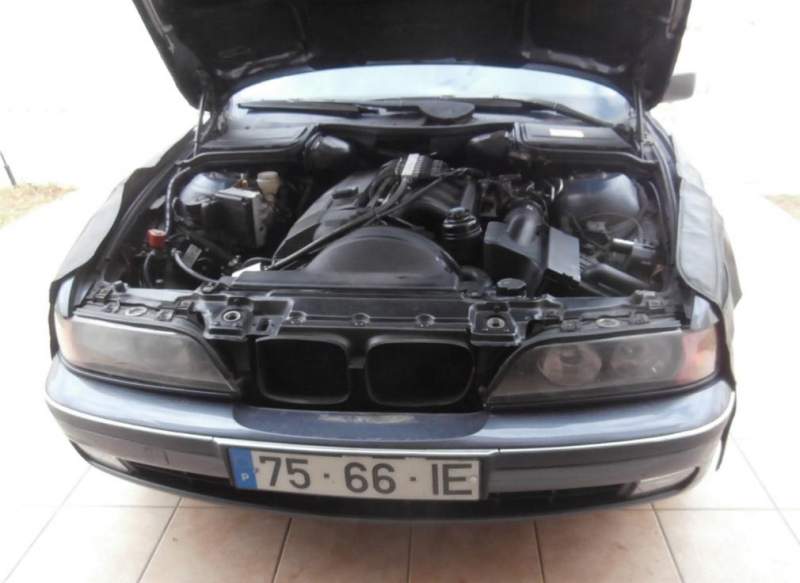

On the 2.8 engine access is real easy, fan off rad shroud off and your there, so nice to have space after 17 years of knuckle scrapping on zeds!! lol so as you will see in the pictures the pump has literally fallen apart, destroying the impeller in the process. The pump housing inside has taken a beating too but not terminal at least, the real question is why had it failed so spectacularly, guess you will never know for sure, the pump was not original and suspect this to be the most likely cause as its not genuine or even a nice oem one, maybe just poor quality?
Seems a common problem on the Bmw forums with the 2.8 engine, I have asked if the owner heard anything and seems he did but carried on in an attempt to get home, it must of sounded like a a 1960`s taxi with all that going on!!

Here are the pump pictures
