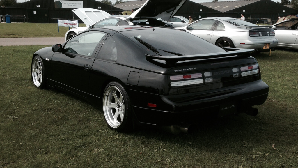

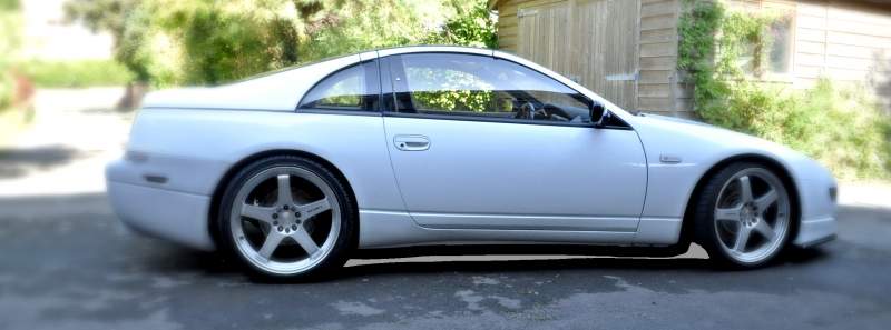

It really does depend on what style you go for. Some styles do look too big, but something with a nice dish usually doesn't, so it hides the fact a little. I run 19 x 9 ET 35 fronts and 19 x 10 ET 40 rear BBS LM
My arch lips are rolled at the back, but just the lips.
Pretty flush

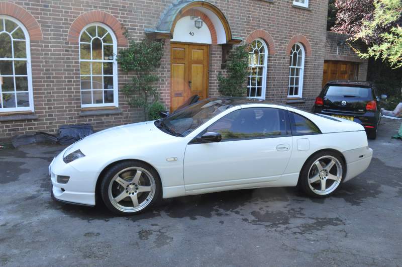

I have 18x9 fronts and 18x10 rears with an offset of 22/25 respectively. I still need my rear arches rolling as the catch but once done they'll clear no problems.
18s look so much better 19s just look to big and kind of odd look at baz,s 18 just the rite size
Thanks to Funkysi and Baz, both your alloys look gorgeous. Funkysi is right I guess it would depend on the style of the wheel.

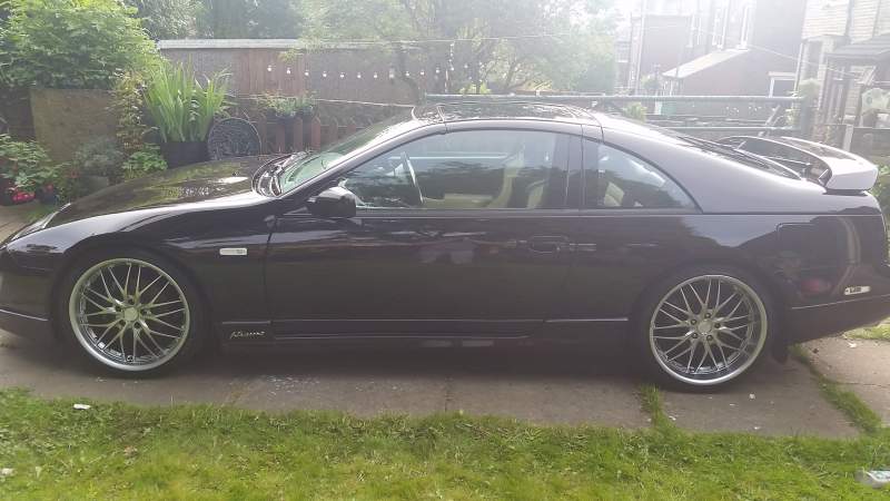

19 x 9.5 et30 rear 19 x 8.5 et 25 for me
275/30 rear 245/35 front
General guide is 19s look a little too big on a swb but ok on a lwb. However as si said depends on the wheels design and also a lot on ride height. Mine is a swb on 19's make your own mind up

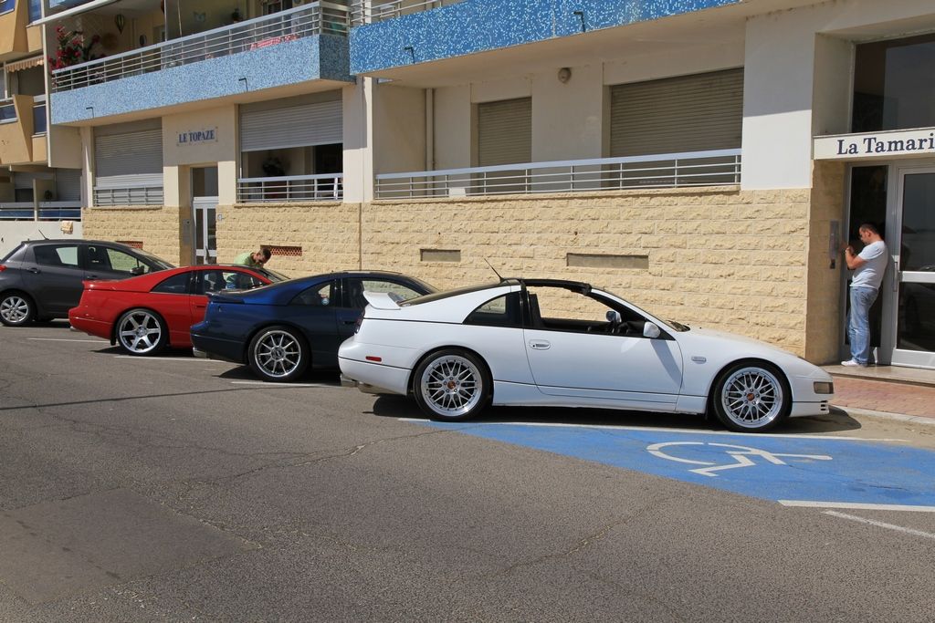

19s can work perfectly. :)
