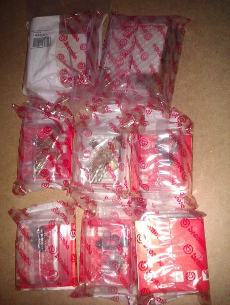

i did a complete overhaul of my brembo's and CZP sorted everything i needed
dan.
[ATTACH=CONFIG]90819[/ATTACH]
dan.

if you contact them through contact page they will sort you out it was Coz Ceh who sorted it all for me.
dan :)
dan :)
