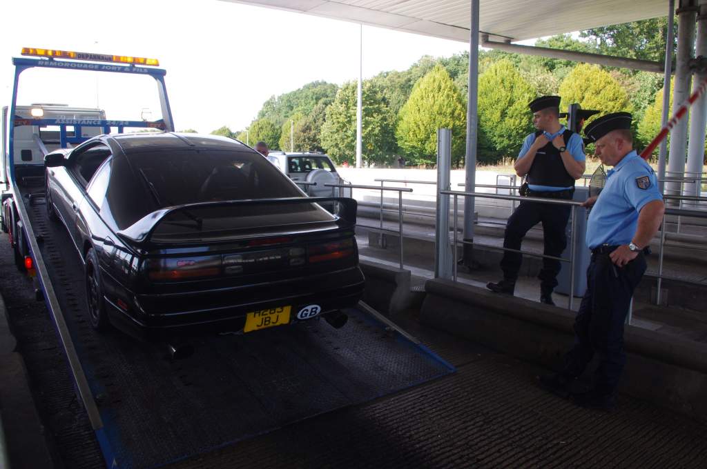

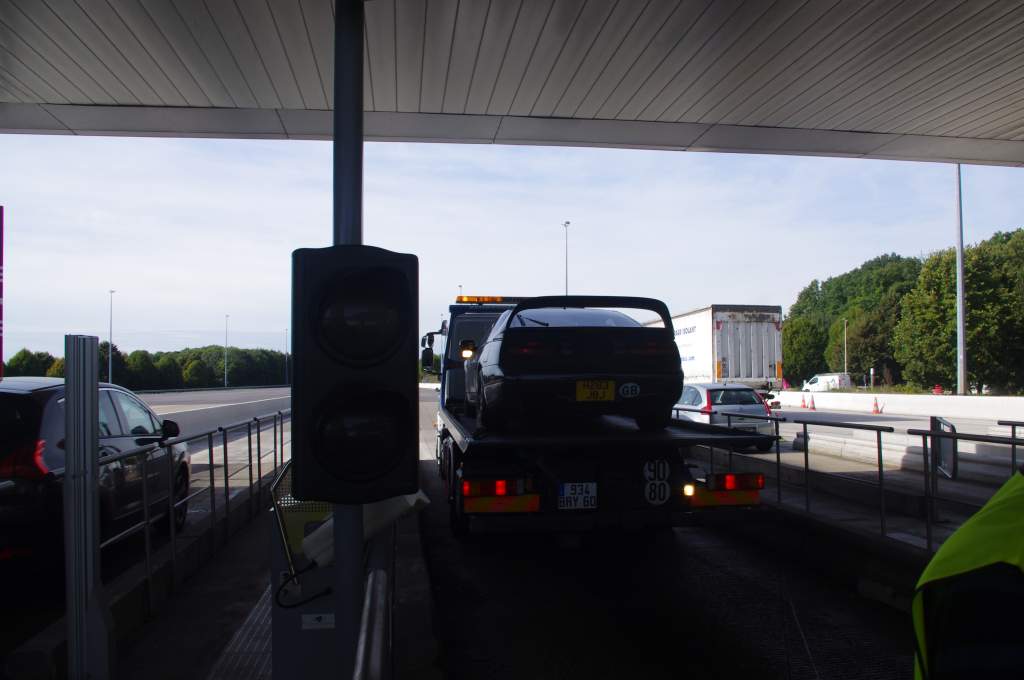

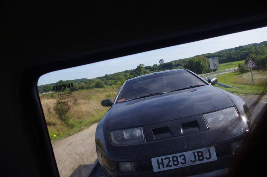

We left Paris yesterday and were making our way to Calais for duty-free, food and an evening out before our late ferry home. As we approached a "Peage" (Toll-gate) I was slowing down and noticed a noise like the de-mist fan was at top speed, as I got to about 20mph just entering the 6'6" wide toll lane the car cut out. We rolled to the machine and my wife took the ticket, I tried to re-start it and it wouldn't. Steam/smoke started billowing from under the bonnet. I jumped out, opened the bonnet and the steam/smoke was pouring out from under the plenum and coming out in the coil pack gaps.
We rang for assistant, got towed off the toll lane to a scrapyard that did towing as a side business and the car is still there. The AA got us a taxi to Paris airport, a french hire car (2015 VW golf) to drive back to Calais, then at the port we were given a brand new (and I mean brand new, it had 7 miles on the clock!) BMW M3D on British plates to use on the ferry and to get home with. Got home last night at nearly 3am.
Zed is still in France somewhere (we don't actually know where exactly because we were on the toll-road when it happened and it was in the middle of no-where. The scrapyard had fields in all directions as far as the eye could see). The AA say that they have to get the car checked, then assessed to see if it can be fixed, and if not it will be re-repatriated. I was warned that it could take a couple of weeks.
In the 30 minutes I had before the tow truck arrived, I had a look around and as there was plenty of golden oil in the engine and the drivers foot well was soaking wet, I guess the heater matrix went, dumped all the coolant, engine overheated and cut out. There was no steam in the cabin, no warning lights on the dash until it cut out and the temp gauge was (and still is) reading normal. I squeezed the radiator top pipe and it felt empty. Its annoying because I checked the water and oil the day before and it didn't need any oil and only wanted a cup full of water.
I'm desperately hoping that it cut out before any lasting damage was done and that a new heater matrix and new coolant will fix it, but I cant even try as its about 200 miles away in another country!

Here is a few from the break-down:

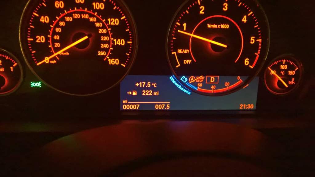

Last picture is the mileage on the BRAND NEW bmw hire car. yes you read it right, 7 miles! The newest car I have ever driven and (I have a suspicion) the newest car I will ever drive!

Guess what! She's back! A 3" pipe at the very back of the engine split and dumped coolant onto the manifold, hence the thick steam. Compression test, oil test, water test, rad check, coolant check all came up clear. I'm going to run her for about 400miles on 99petrol and then get the timing belt and thermostat done. Seems like I've dodged a bullet. Grand total to fix.... £80!
