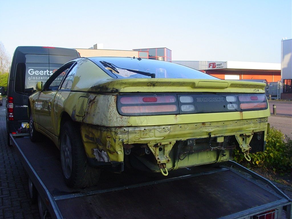

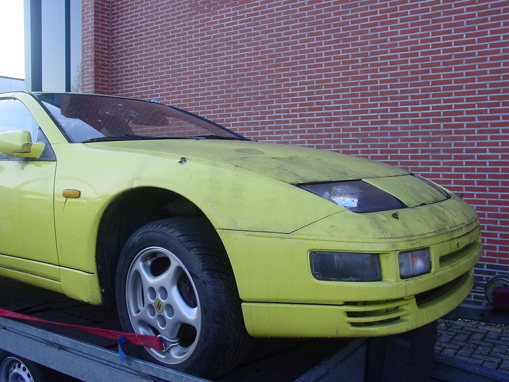

I'm from The Netherlands and own a 1990 Nissan 300ZX Twin Turbo.

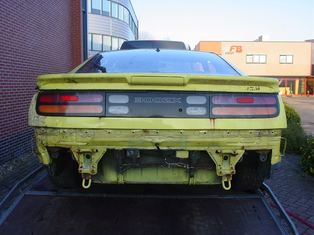

I bought it about 4 months ago, it was offered for parts, I immediately bought it from internet without seeing the car itself in real.
It has no transmission or engine in it (yet), but I didn't cared.
I saved it and want to restore it completely one day to it's original showroom condition.

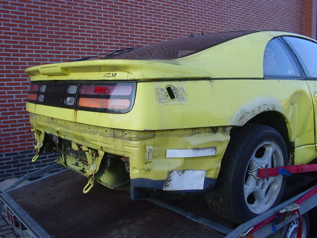

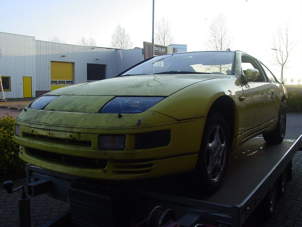

Here are some photos from the day I picked it up...
Most interior parts where stored inside the car, the rear bumper came also with it, so for most part it was complete.
Only one inerior panel is missing and the drivers window. (+the engine and transmission then)

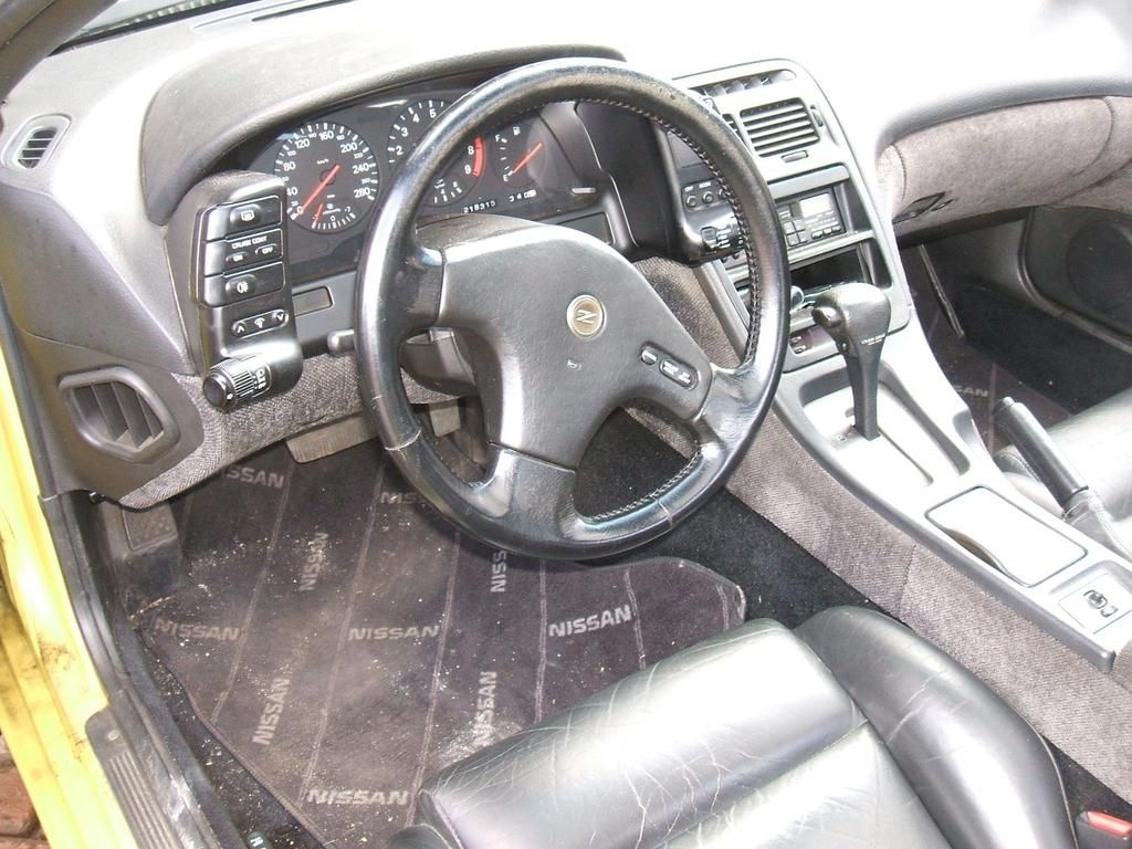

I want to replace the bad steering wheel, but how do I remove the center cover?
Don't want to damage it.
I'm going to make a real beauty from it again.
On the back of the wheel, on the bottom spoke, there is a hole - poke a cross-head screwdriver through that hole and remove the screw. The cover then simply pulls off and you disconnect the wires for the horn and the cruise control once the centre is free of the wheel assembly :thumbup1:
Great, thanks!!

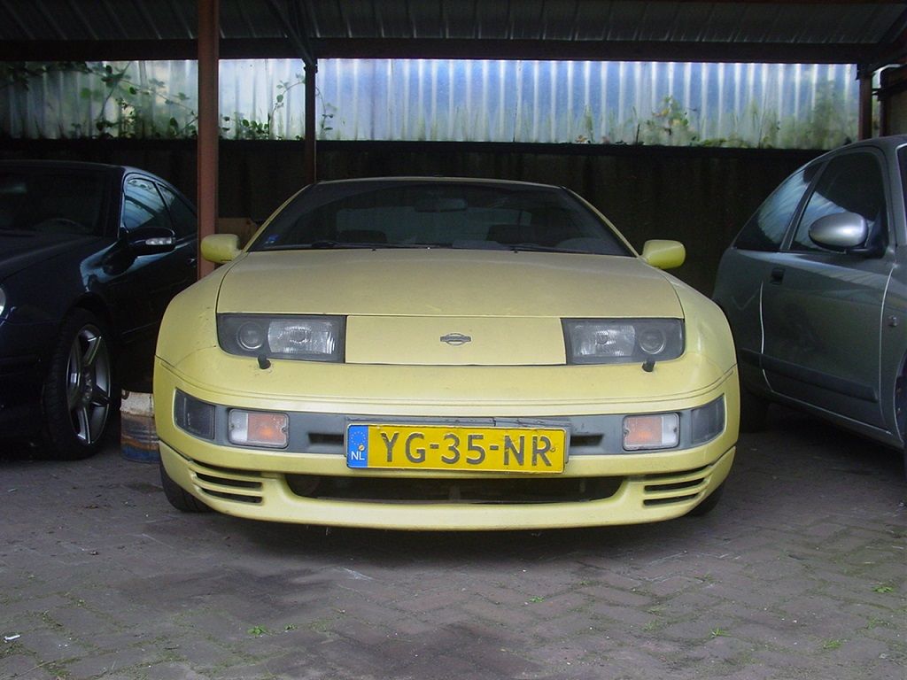

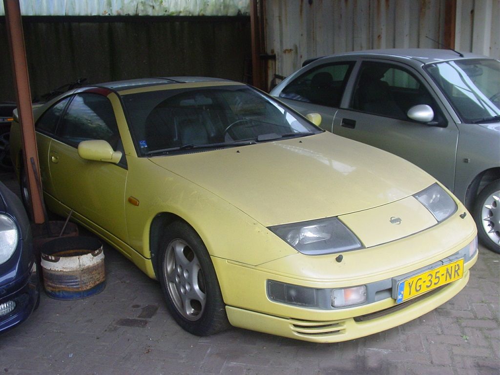

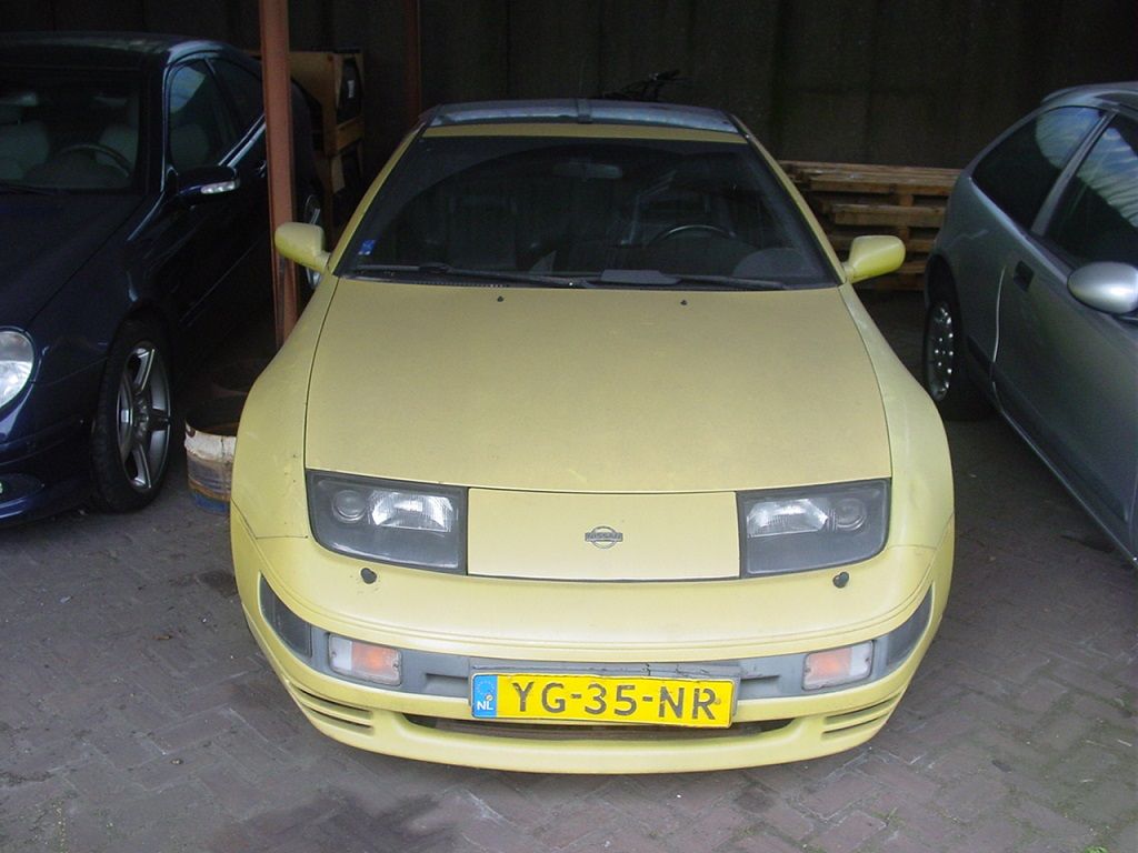

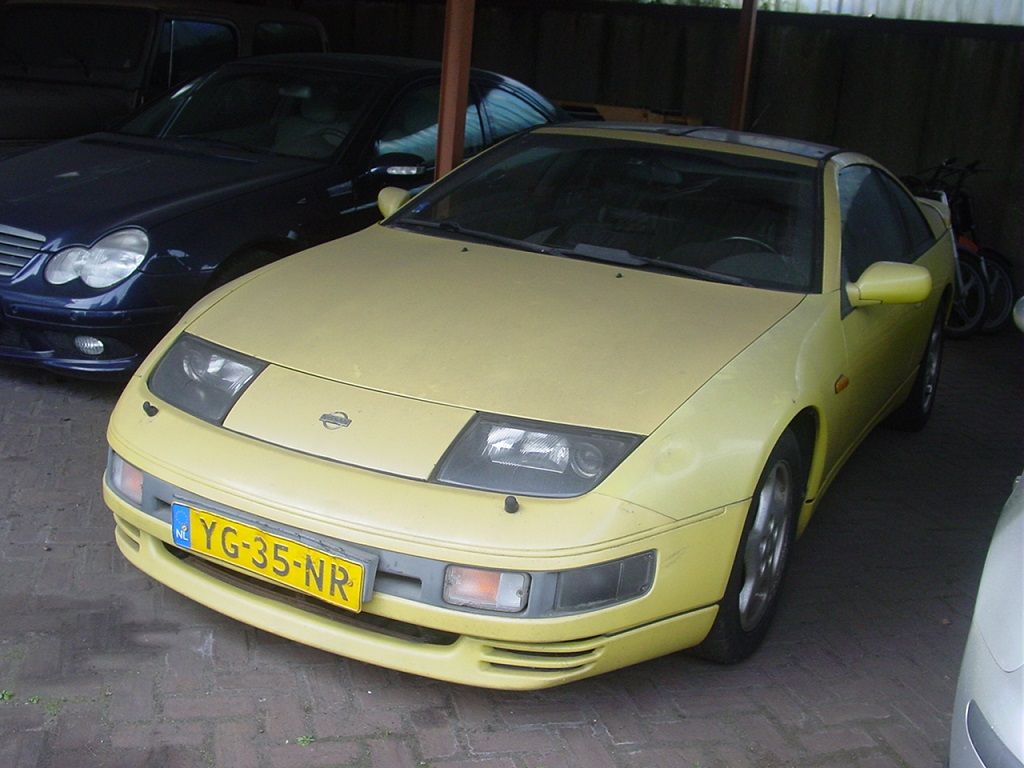

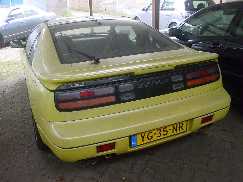

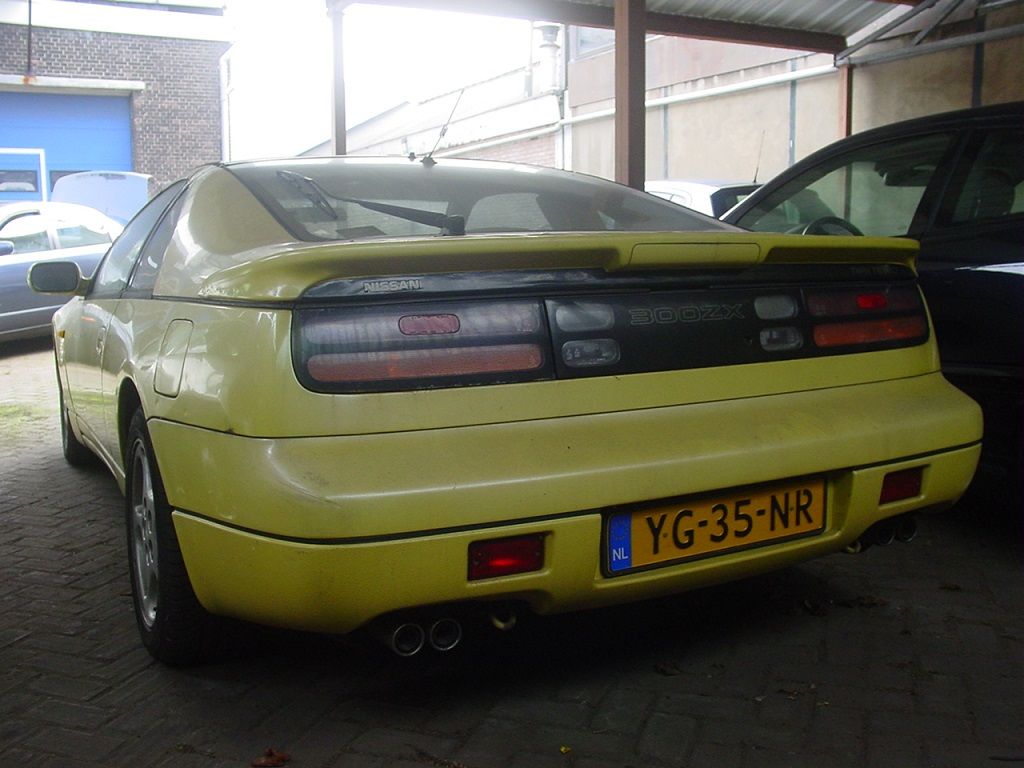

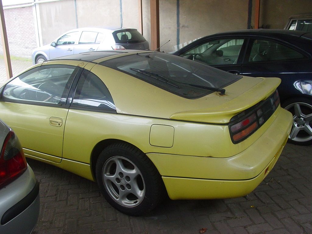

Today I went to someone who e-mailed me and offered me a 1990 Nissan 300ZX Twin Turbo with an automatic.
The car isn't used for several years and is parked outside (but dry from the rain).
THe body isn't bad, only some rust spots on the body itself, but the bottom is completely intact.
Just made a down payment for it and will pick it up later.
I also get another automatic transmission (restored) and engine with it. :)

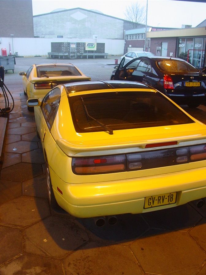

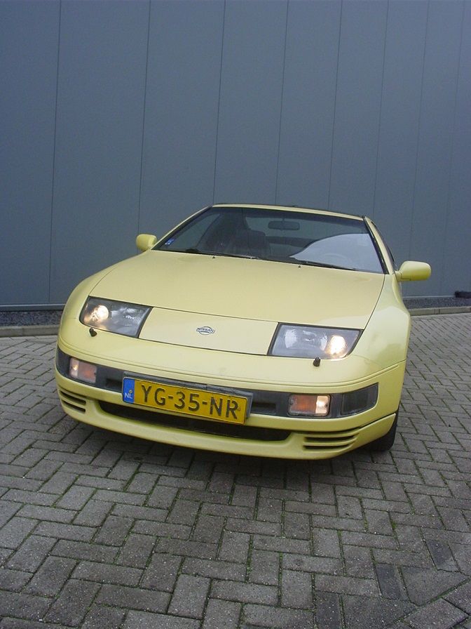

Today it was the big day, I could finally pick up my 1990 Nissan 300ZX TT!!
When I was filling up the fuel tank at the nearest gas station from where I bought the car, and was paying for my fuel, I saw something yellow parking behind my Nissan, it was another yellow Nissan 300ZX!!! (NON Turbo)
Well, that was something I could never imagen it would happen. :)
I drove the car back home (1,5 hour driving) without any problems at all, it looked or the car was used every day. (it wasn't used for 7 years!!)

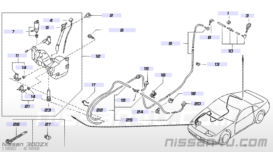

There is one problem with the car which needs to be repaired, else I can go to the garage for it's MOT, the wiper "sprinkler" doesn't work, not for the window, but also for the head lights.
The "funny" thing is, my burgundy Nissan has exacty the same problem.
Does anyone know what this can be???!!
I also couldn't find the prinkler pomp itself.
Congratulations on your purchase and great to see a Euro spec car back in good hands!
All three pumps (2 for front and rear windscreens and 1 for headlights) are mounted on the washer reservoir.
Item 7 is the headlight washer pump.
Thank you so much for showing where the pomp is!!!

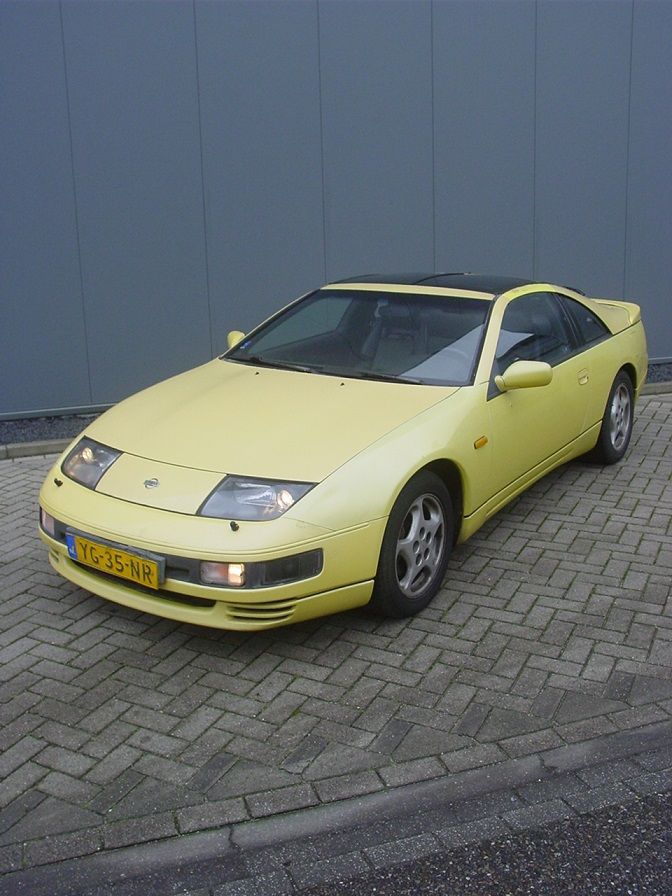

I polished my Nissan and all the durt from standing still from 7 years is gone now. :)
