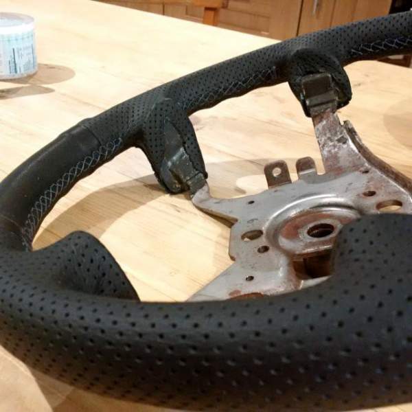

I gave the wheels some tests tonight. A couple of straight lines on the machine and then using the hand stitch to pull it all together.
First and second test:
Third test (getting there I think. Probably doing it wrong, but I don't see why it wont work, stretches around the curves well and holds tight. A bit of glue should help give it a reasonable lilfetime! only time will tell ).
Planning on putting a perforated section in the middle! :)

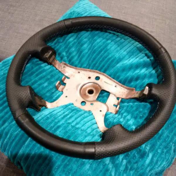

So tonight's work on the wheel. A quick test again with perforated leather, and then the pattern making and sewing... So far so good!
Now for the hand stitch and glueing... aka the scary bit.
Looks like a good job on the steering wheel there! A different method to how I do mine, but definitely looks the part! :thumbup1:
Nice work. Think you must have an eye for this sort of thing as if this is your first ever attemp at it I'm seriously impressed.

You're doing very well so far! :thumbup1:
I'd suggest making the seam allowance on the wheel joints a little smaller though, so they're not as obvious once it's all finished. Maybe trim them down to about 5mm or 6mm.
Yeah I agree, they are a bit imposing as they are!

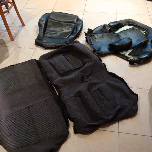

So received my seat covers to tear apart from hellraiser! Thanks mate. This looks bloody scary!!!
I intend to reduce the covers to their component parts, then make some patterns from calico. I will then pin that pattern to the seats to make sure everything lines up, and make any repairs or tweaks.
Then transfer the calico pattern to the leather and hope for the best...........

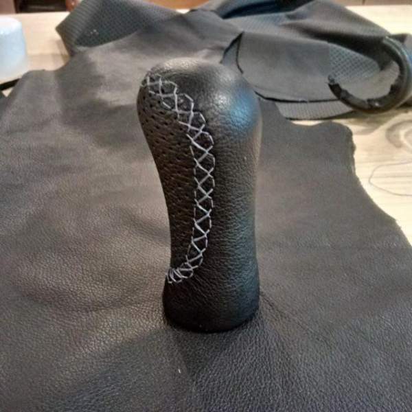

Gear Knob tonight... Not particularly happy with this one yet. Will probably end up going with a different kind of stitch as this one is a bit untidy in places due to matching up the thread count. See how it looks once the rest is done :) I might just replace it out for a nice simple Nismo one.
Your doing well mate. I was over gaz's last week before he sent them out. Gear knob looks bonza.
