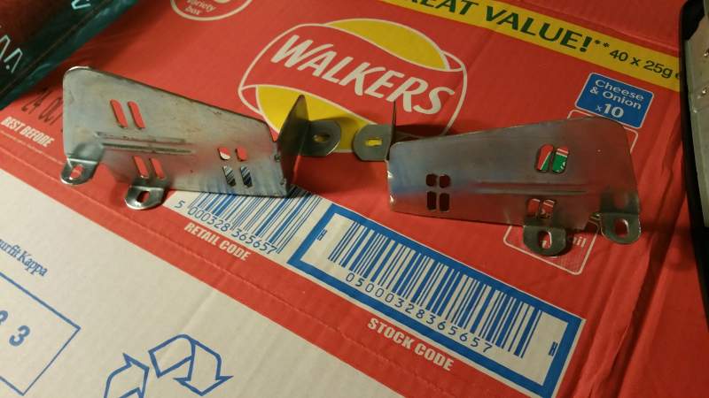

Anyway, I also got sent these two (rusty, again not impressed though it doesn't really matter) metal plates, but what the hell are they even for?! I can't seem to find a single way they fit the fascia that makes sense.
Any words of wisdom our there? But peeved with it all to be honest.
You screw them to the stereo, then they mount into the dash. The left one is the right bracket and vice versa, the lugs in the middle of the pic sit at the bottom and the top section as shown in the pic will point into the hole towards the bulkhead (the part pointing upwards)! Once you get it orientated like that, it should then become clear how they mount. You will need to select the correct holes depending on how you want the stereo to sit. Or as I did, make new holes to make it fit! I agree, all of these aftermarket double centre consoles aren't particularly good quality, however I believe to make a proper moulded plastic piece of OEM quality, would probably price itself out of the market.

Aahhh got it now! My problem was not looking at the car, I was trying to fit it too the fascia, not the car. I didn't think about it as with the single unit I took out the cage was attached to the fascia, not the car and the holes these brackets use weren't bring used so I didn't think about them.
Cheers!!
As Joel says, use the brackets to bolt the head unit inside the dash - although the OEM brackets will be a better fit. No drilling or messing about is required, the OEM brackets old the stereo in the right place
And if you're not using the "cage" supplied with the head unit, it should fit neatly inside the new DD facia without the need to file any of the plastic away - and you'll not need the plastic "finisher" supplied with the head unit either!

I didn't have any OEM brackets to speak of, must have been removed when the last headunit was put in, that's why I was confused with it as I wasn't expecting anything like that.
And yes now I'm not using the cage I have sanded it down a touch too much, but it's not too bad, it would have needed a little bit anyway as the unit by itself didn't fit either.
