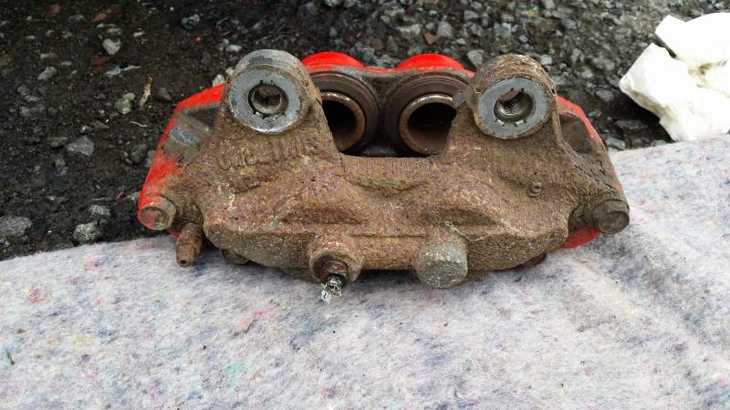

Yours are the cast iron calipers which to me were a cost cutting measure.
The alloy ones don't corrode like that and are lighter, don't spend the money on refurbing those. They are the same as the s14 calipers and not worth a lot.
I'm sure there are plenty of people on here who would sell you a set of the alloy calipers in reasonable Nick for not to much, I think I might even have a set around somewhere in the UK. I can find out for you if you want.
never thought about that so may buy the ones pete mentioned for now.

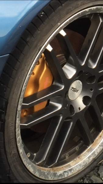

You're pretty much sorted so buddy, I may have my Brembo's and disks coming up for sale, they're GTR Disks with beefier Calipers than the GTR's, They're on the Z but have done feck all mileage since they were fitted in 06-07.
That's the only photo I have at the minute.

Been quoted £400 to get my calipers refurbished.
Stripped down, new pistons, seals and then painted.
The garage are friends of mine so getting discount but wondered if that is a good deal ?
[ATTACH=CONFIG]89565[/ATTACH]
