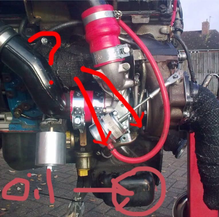

As pictured below, leak is Coming from passenger side of the sump. And you can see it running down the side of the sump and dripping onto the ground pretty quickly.
Am I right in thinking it's prob from the passenger side turbo oil hoses which I've labeled below with a ?
Now, before I get under the car, is this pipe easily accessed under the car? Can I remove it while engine is still in?
There's not much on that side. Turbo feed line, run from the front to the turbo. It's a pita to do the nut on the turbo up in situee. Sure it's not the rocker cover?
Check the dip stick tube, turbo return as well as the turbo oil feed line and the aforementioned cam cover, mostly do-able in situ with the dip stick tube been the hardest to sort out.

It's ok, it was my accumsump braided hose, was touching the downpipe, so must have gotten hot and split. New one ordered and will be relocated.
