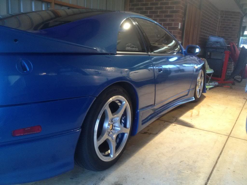

17" F-zero on a Z32 - they look rather underwhelmed.
Tyre choice has a lot to do with that though Si. So etching with a nice sidewall will make it look muscular rather than lost. I agree though 18" would have been better.
