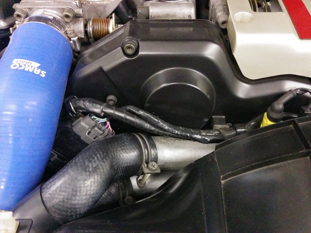

No ugly harness with the S2 PTU I have fitted. You going to carry a spare S1 in case of failure in the
middle of nowhere?
[ATTACH=CONFIG]88970[/ATTACH]
I'll carry the spare S2 that I have for that! :lol:
