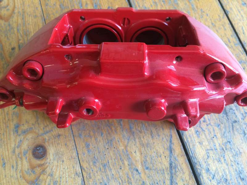

Right, I've just been offered a cheap set of freshly powdercoated Evo Brembo front and rear calipers, the problem is they were totally stripped down for powdercoating and now have no internals, pistons etc. Are they hard to replace?? are they expensive to replace?? Is it worth my while??

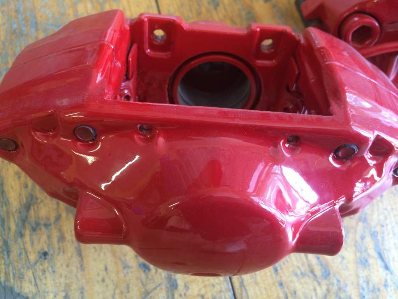

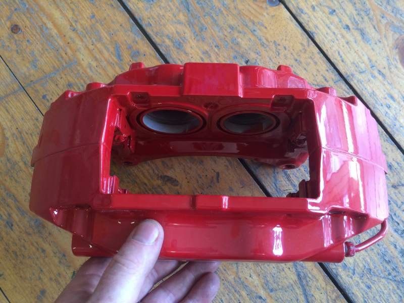

A few pics so you understand what I mean:yes:
Club member no. 779:thumbup1:
This is all I get, so the question is..What do I need to have these serviceable??
Assembly wise they are very simple. The pistons may cost a few quid though. It depends how cheap you have been offered them. The pistons apparently very rarely fail, it's just the seals. Mine cost £200 for the pair fully assembled but In used condition.

You'll need the pistons in those. They're about £35 a pop, so you'll need 12 in total which will be about £420. The seal kit from BiggRed is about £75 from memory.
Doesn't look like they have bleed nipples either. I'd recommend getting stainless steel bleed nipples. There are 2 per calliper - a set will run you £25. You also need dust caps. Genuine ones are about £15 - £20 for all 8.
If you're going this far, get stainless steel lines too. HEL ones are pretty good. They're about £80. Might as well replace the retainer clips also.
Thanks for that Si, I knew you were the man to talk to !! That comes in a £520 plus the price of the calipers!!! So basically, they're not worth getting!!
