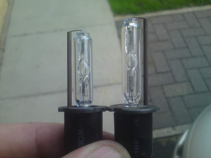

Perhaps you should explain the difference between the readily-available H3 bulbs and the less-common H3C ones...?
That's easy with a pic, H3c on the left, H3 on the right, so it's all how it sits in it's housing, the arc of the bulbs distance away from the shield, lens, etc.
As above. The H3C sits in the globe differently. The fitting is designed for H3C focus, so you're going to get more beam-scatter with H3 if you're running that on a JDM headlamp.
