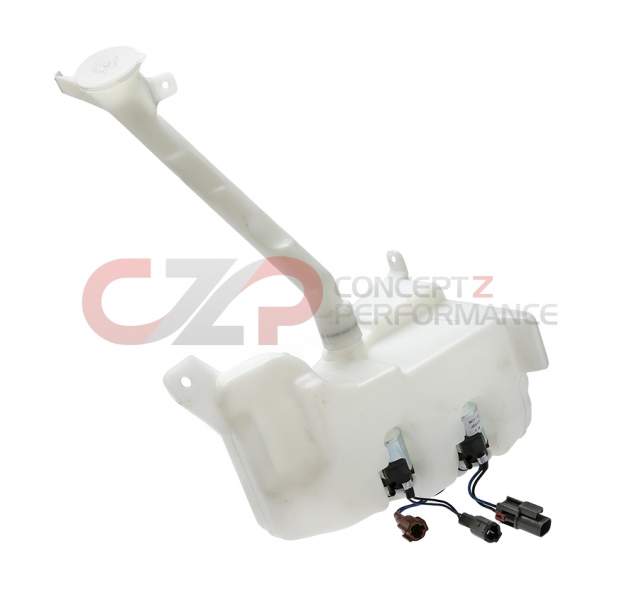

does anybody know if the washer bottle is different in height or shape with the headlamp washers fitted or not
reason im asking is whilst fitting the ash intercooler pipework im struggling to refit the washer bottle tank mine's a uk spec with washer jets for headlights...
rich
assuming the bottom pict is the headlight washers I wonder if the bottom of the bottle is lower as with the extra 1/2 inch pipework the bottle is in the way
by about 1/2 inch

hi peeps
rich

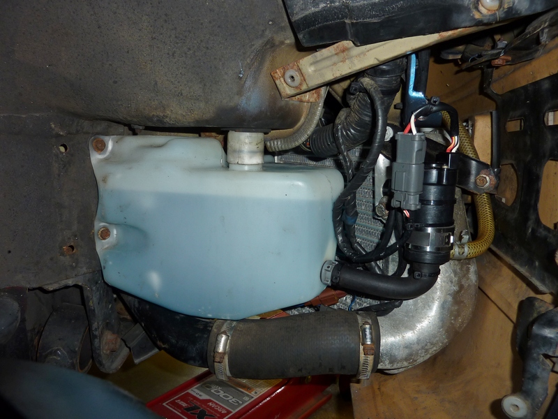

UK spec washer bottle is larger for extra motor. I changed mine out for the smaller jpsec type and used an separately mounted motor
for the headlight washers. The photo may help with your problem, let me know as I will be doing the same pipework later.
