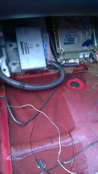

I then stripped back all the carpet in the passenger footwell and found it was damp so I dryed it all out and brought the sponge carpet base in to dry properly. After leaving it over night last night (again raining) the below picture is how it looked. Could this be the issue?
If the floor is wet, its ok when cold but as the ECU heats up it lifts the damp and shorts something?
