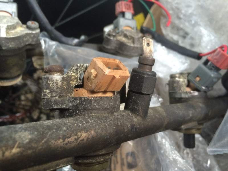

Hi guys, can anyone tell me what injectors these are?
I think I got them off John Dixon in 2010

They're an odd colour. Pink are standard Maxima injectors, buy these look more "orangey".

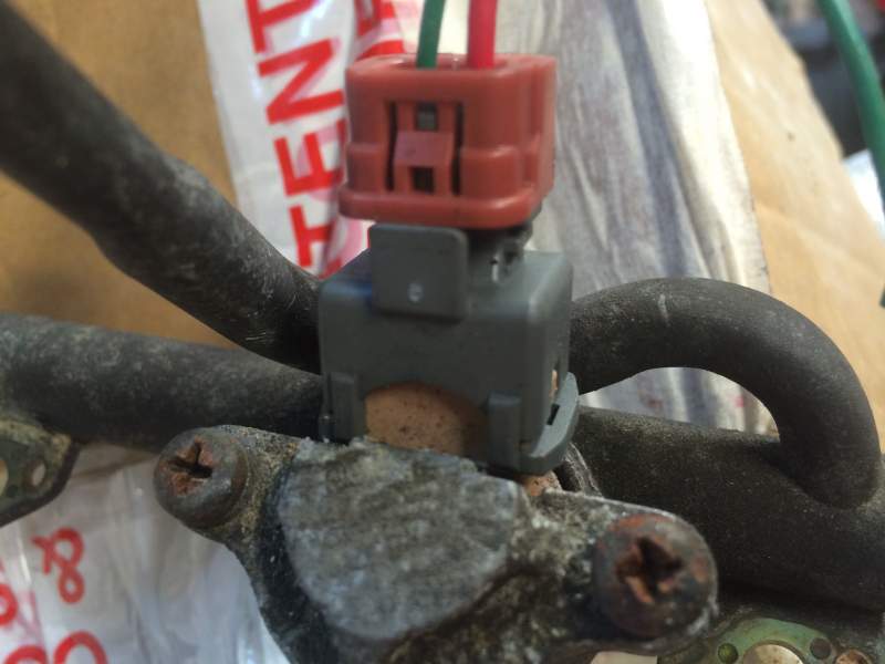

Another pic with the connector removed

I think they might be old JECS 555cc injectors and were probably yellow when new, but have oranged with heat.
Maybe an older version of these...

Why don't you remove one of the injectors securing caps to reveal the full view of the top. You don't have to disturb the seals and I wonder if the brand is etched out of sight under the cap.

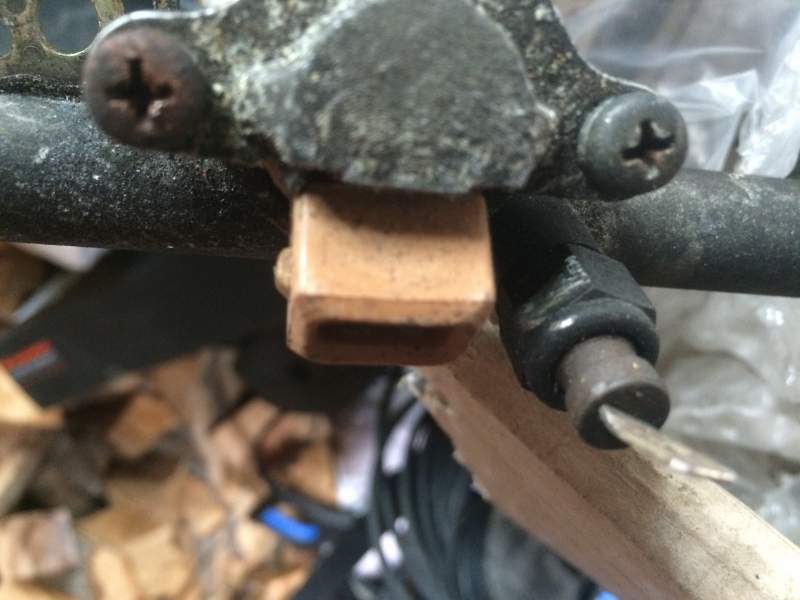

They're definitely not the ones from CZP, these have a square Bosch EV1 connector. I don't recall any yellow-coloured square connector sidefeed injectors, either.
Have you asked John about them? Or searched for the original For Sale ad if they werre bought via the forum.
