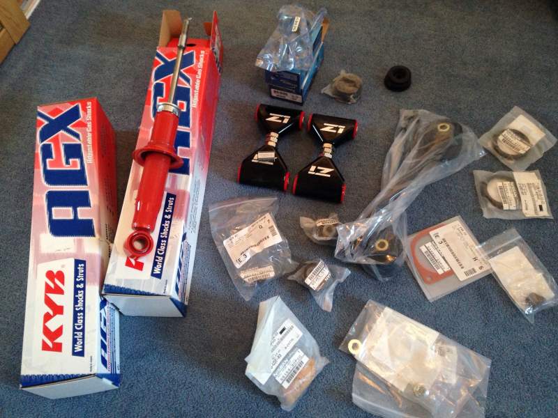

Like buses, 3 came along all at once! A new chip from Noel, some bits that JoelyP managed to rescure from MJP for me and finally a nice big package from Z1 arrived today.
I have been running solid Midori style suspension components from Powertrix for the last 8 or 9 years and they're just too harsh for me, they've also caused a lot of my standard bushes to deteriorate at quite a rate of knots, so I've decided to rebuild everything. One of my current KYB front shocks seem to have shat its pants and wrecked one of the rubber strut top mount bushings, so I'm just going to replace EVERYTHING.
No more solid joints! YAY! All the bushings on the rear knuckles are to be replaced, front lower arm, tension rods, the lot. I hope it'll feel more like the GT Street Car it was designed as rather than a crashy tack car.

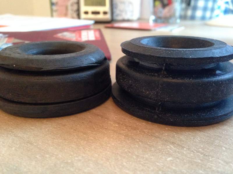

Here's an old bush compared to a new one. Granted, the old bush would have retained an amount of its compressed memory, but it's as hard as nails. This wasn't from my car, I want to pull those off ASAP to find out why one of them has completely failed.
Ooooh, you've some nice bits there Si. Are you going to leave the shocks red or paint them?
I fancy the z1 upper suspension arms, do you recommend them over other non OEM replacement parts?
You'll have to take some pictures with your new set-up once completed mate.
Not leaving them red. They'll either get powdercoated black or painted black. Red on the underside of my car would look awful if you were unfortunate enough to catch a glimpse through the wheel! :lol:
The Z1 FUCAs are about the same price as stock new upper arms believe it or not. You could opt for the NISMO bushes to be pressed in to your existing links. I wouldn't want PU or solid joints on the rear of the car as that's where NVH is most sensitive. Having these joints at the front will mean that they'll pretty much be maintenance free and more forgiving. Not as soft as stock, but not firm either.
