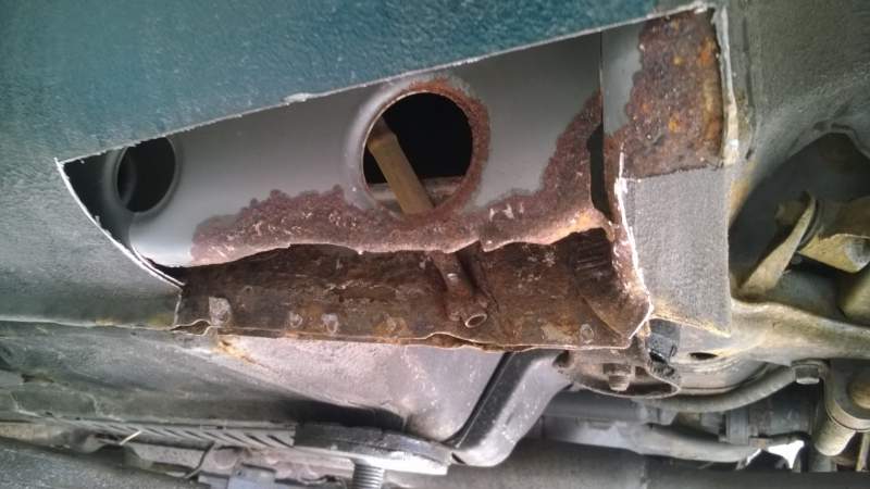

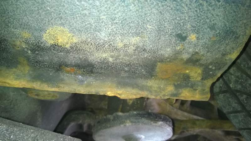

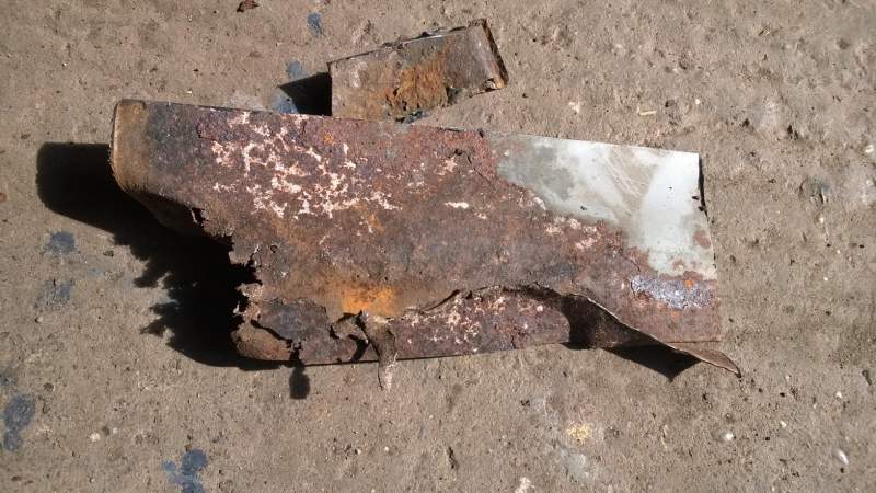

What looks like a little can turn out to be a lot as others have said....

And that damage was on my Green zed which had been undersealed twice and had an slight oil leak Which protected all exterior surfaces. But that part is prone to rusting from the inside.....
Full story is at http://www.300zx.co.uk/forums/showthread.php?178057-Restoration-of-the-green-Zed
