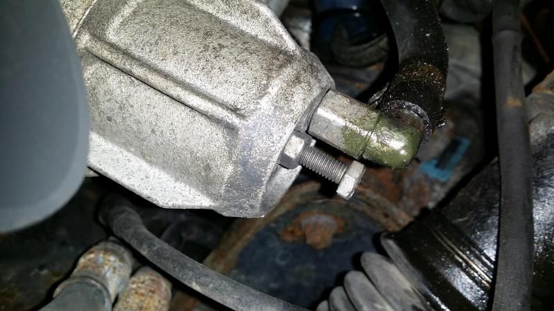

I know the ones Ive got have an adjustment screw if that helps.

This is the screw I mentioned, I'm not sure why there green snot on it though...
