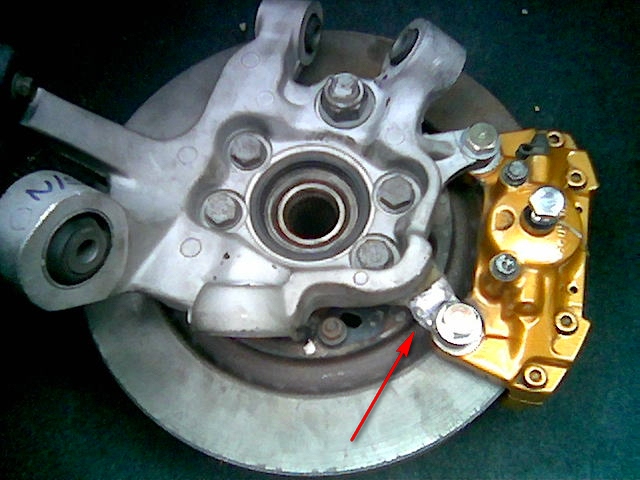

Yeah, personally that would always worry me, I know if done correctly the weld should be sound but I would just always have that doubt in my mind, a lot of work and potential worry for little gain I think.
Plus if the mot guy spots it it's a fail I believe. Illogical as all the other arms are welded but hey.
Not a failure providing everything is secure, as you mentioned, plenty of welds everywhere on a car.
It's a good point, but mine was done well (very neatly) and never failed.
Incidentally, I'm not the only person to have done this, there was one in Holland, Nend perhaps ? In fact I think the photo may have been of his not mine as it looks like the hub had been blasted and I don't remember doing that for mine.
