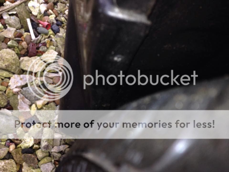

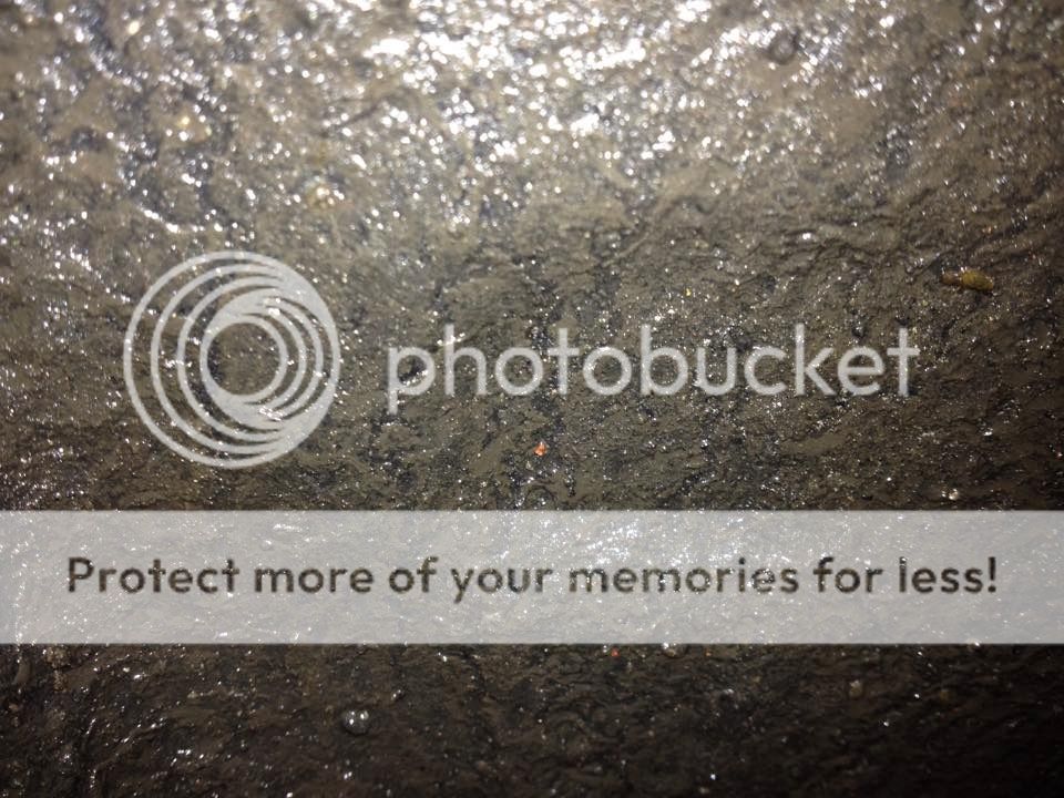

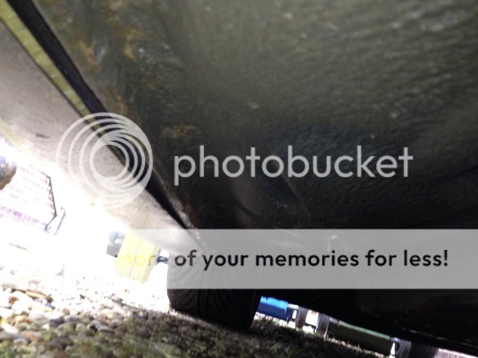

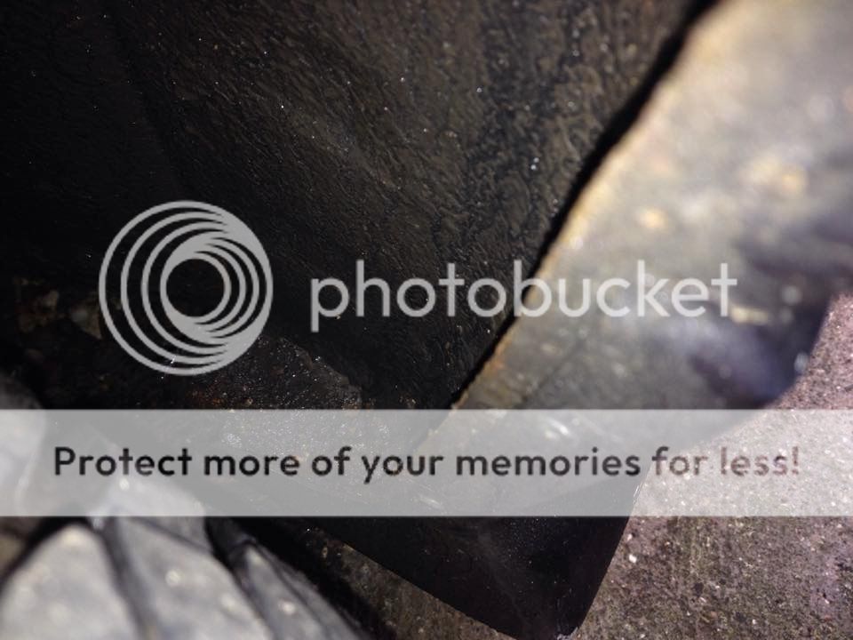

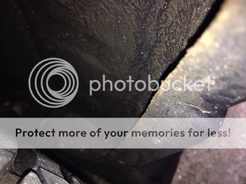

Looking at getting my first 300zx and tHe seller has shown me some of the issues with the car...
Not that clued up with bodywork repairs...
Will these be a nightmare to sort?

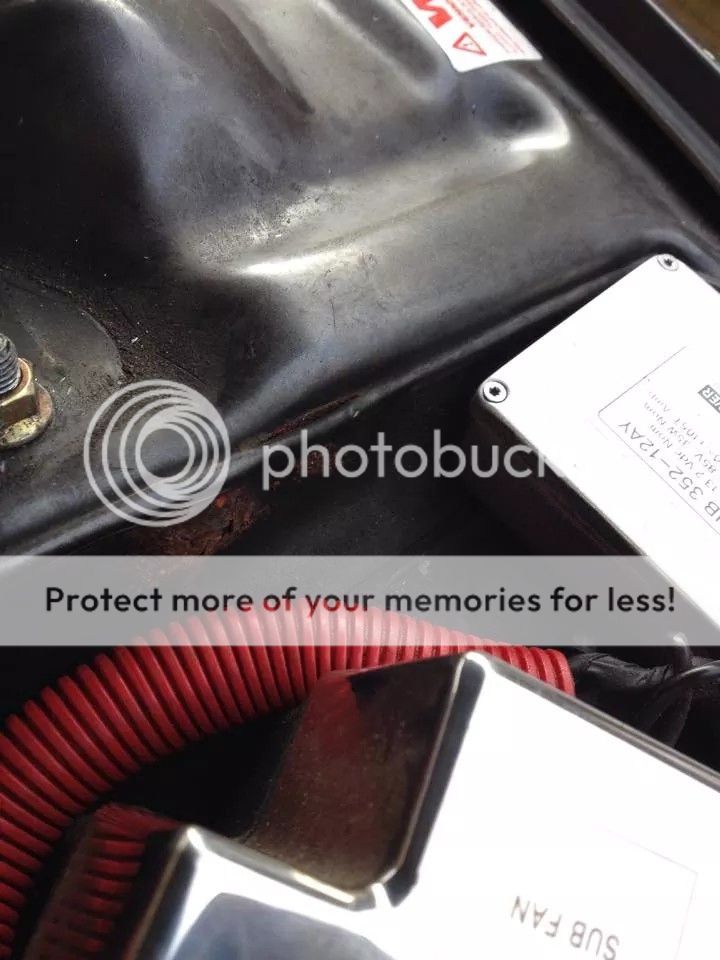

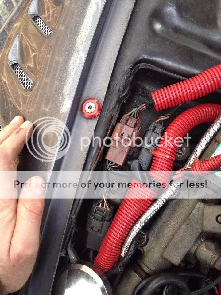

Steer clear, those will need welding eventually, the RH side looks like it already needs a patch...those wings and red bits - eow.
If that's the only localised rust I would say any decent body shop could cure that. Talk to Boldy at body mech on the traders section I'm sure he can guide you also I'm sure Jeff at Zed world will have done plenty of these.
I can get the car fairly cheap tbh, so I'll have a little money to throw at it :)
Just don't want to get involved with bodywork when it's a structural area...
Wings (and the rest of the bodykit) will be removed and swapped for standard parts! Not a fan at all of lairy kits...

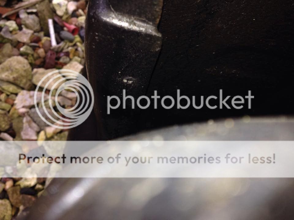

Doesn't matter how cheap it is matey replacing the inner and outer sills on both sides, which is a common problem, is both structural and not cheap.
My advice would be if the sills are shot walk away and wait for another.
However if it's just those couple of bits in the engine bay then it's worth a punt

That left hand turret is a fairly easy repair as welding goes. the skin behind it will more than likely be untouched (mine was fairly bad). On the right hand side i had that also as the majority of what you see is seam sealer, a wire wheel attachment will prob shift that and you could seal it then put some seam sealant back in.
The ones to watch are the sills...they are the nightmare.
The seller seems convinced is just surface rust. ..ie attacked it with screwdriver and it's still solid :)
Yeah after I removed all the seam sealant on my car there was patches of surface rust under the sealant so even the cleanest of cars could have some surface rust ;) However im pretty sure the pass side turret isnt surface rust. It will need welding but its a simple welding job.

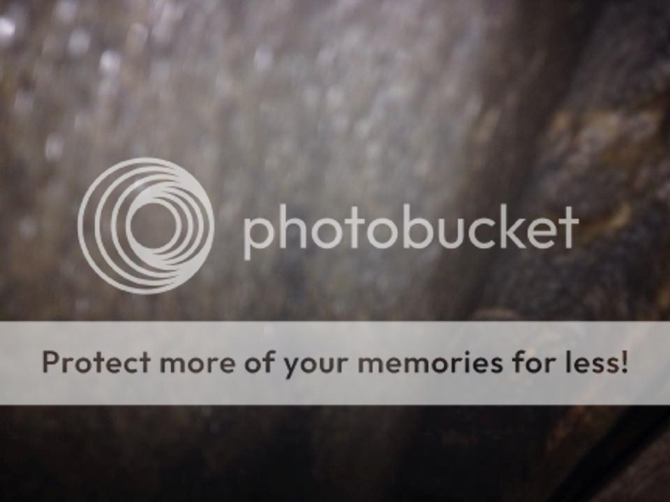

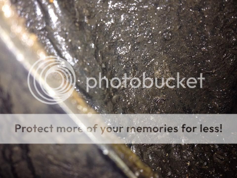

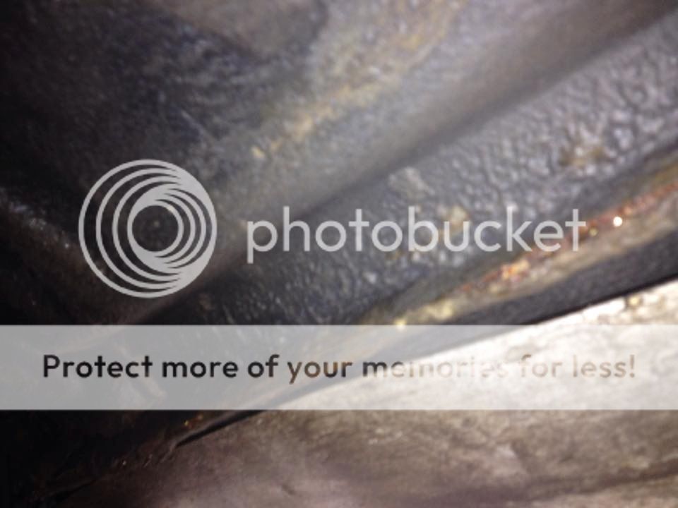

Quite a lot of winter slime on those parts - looks like it's about to break out along the same and corners of the floor pan. I wouldn't personally.
