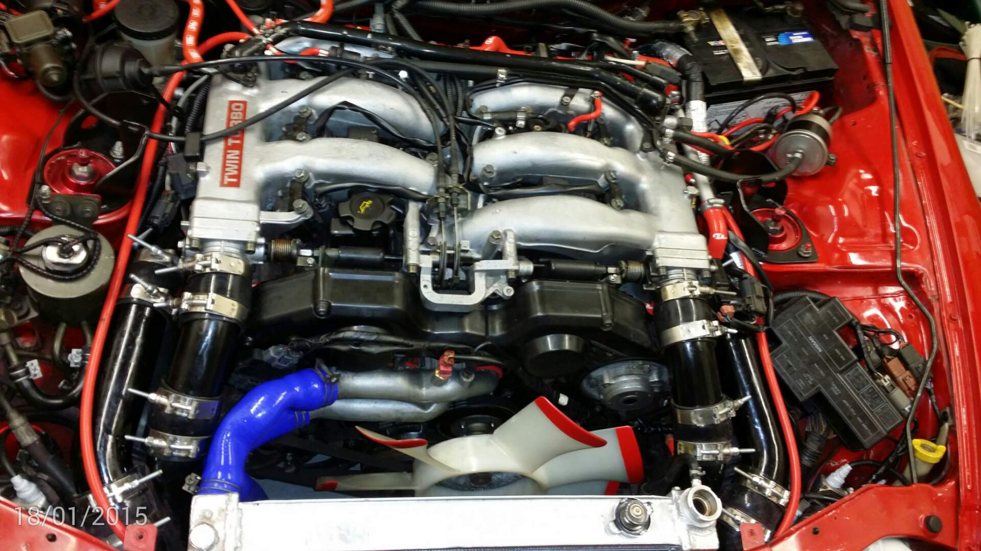

Will put some pics up in a bit. Its a bit shabby to look at but all the oily bits are back in now, mot Friday.
OK, see if this works, shared a few here: http://1drv.ms/15zIEl8
Some vids on youtube too if you look for 500zx but all really old. The pics are all at different stages too, the one with the 2 green air filters under the bonnet is the latest. Bit of a crap setup but one thing at a time!!

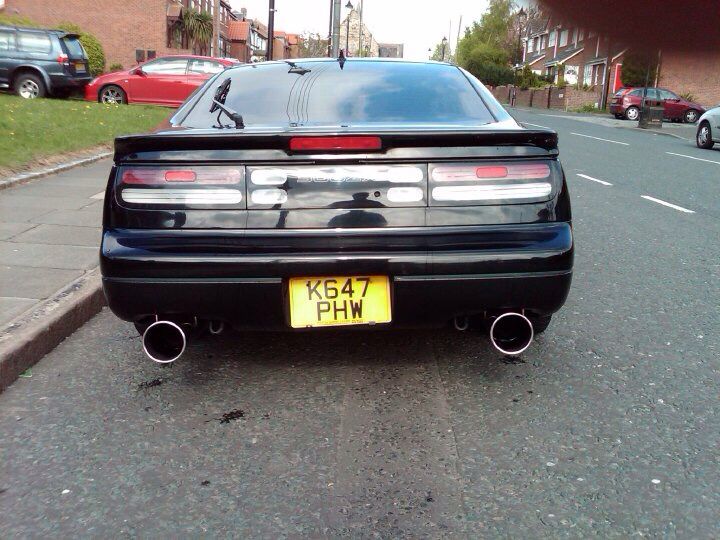

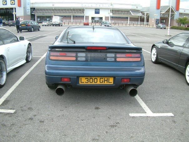

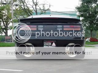

For a laugh at my expense as always, here are a few of my old exhausts:
This ones still just sat in the garage
This one is 'The Wheelborrow'
Zaustec - this was hug and very similar to the joke on Gary posted above
Veilside Evolution
