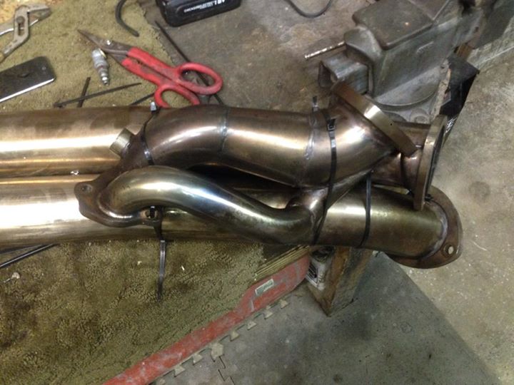

Guess what i now bought for my car. Well a pair of 3"AMS Down pipes and 3" Z1 Test pipes. And got some turbo outlet pipes thrown in 2.5".good a.
Tubs next.pics soon.

Some pics as and when i can get the uploaded.and yes Noel your rihht and it was Ian of whom i bougjt them of .
Ams 3" down pipes and Z1 3" rest pipes. Oh and some 2 to 2.5" custom built outlet pipes with a port for the iacv.in.
Just need some more 2.5" pipe work now all the way to the fmic.pics will come soon .when i can get a good enough signall.

[ATTACH=CONFIG]84909[/ATTACH]
.[ATTACH=CONFIG]84910[/ATTACH]

Let see if i get this right.and if not ill soon be corrected im sure. Firstly i must have miss lead people buy the post above.i now have or will when they turn up. 3" down pipes. And 3" test pipes.test pipes are called that cas they do not have any cats in them.from there im going to see if i can get the rest made up custom job 3" right through to the single exit i have. Most or at least alot of poeple go from the3" down pipes to the 2.5" test pipes and beyound. The reson for this so i understand is.the 3" dps help get rid of the gasses quicker and you get quicker responce and better for your turbo perfomance in the lower to mid range.going for 3" right through will see gains at the top end as well. But unless your tracking it it a unesserary cost. That said also unless you have very nice neibours like i do and do not live in a built up area there going to sound bloody loud but ausome to..
the test pipe was there so i took it otherwise i would have gone straight to 2.5" from my dps.but waste not want not.
As for the other 2.5" pipe i was talking about.well i was saying i have now got the fist part of the 2.5" tub outlet pipe from the tubs. These pipes are norm 2" standered. But going up to 2.5 " will help the tub spool quicker and draw more air mass more easy than sucking from a 2" standered set up.but this is i think quite exspensive i think.but again he wasnt making use of it cas his going over to a single tub setup so i had that as well. I hope i explaned well enough and the right information.
