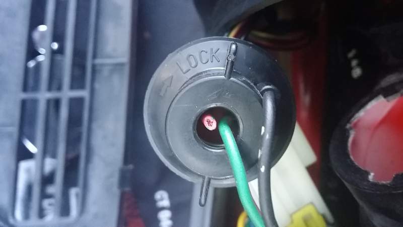

One brake light was out after changing bulb etc. Had a look and noticed the wire had been cut... don't know why? It's too short to spice into... looks like a new housing.

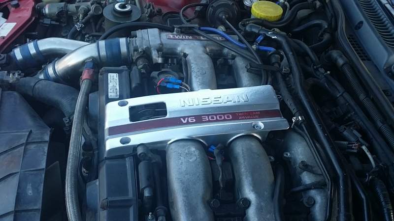

also I have chromed up the engine cover... looks nice :)

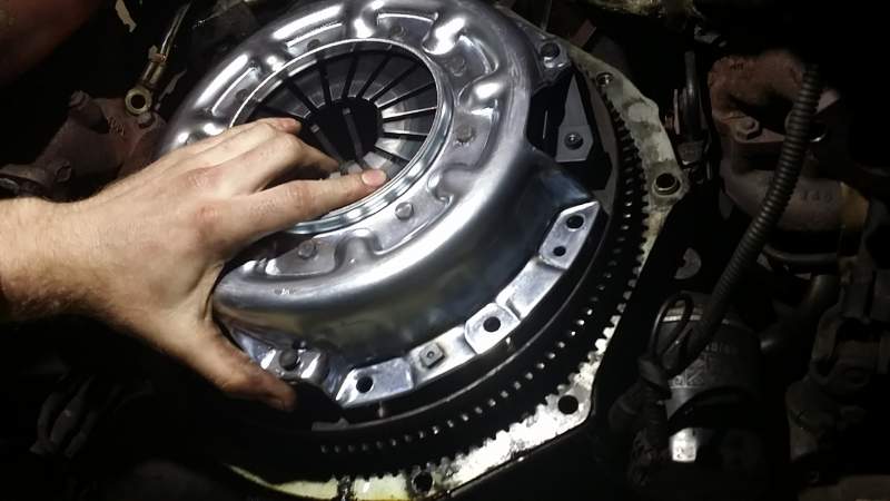

Got the clutch fitted today... or attempted. The clutch plate didn't even fit... The bolts didn't align up. Really annoyed. Getting a refund though :)
it was a exedy stage 1 clutch... anywhere I can get the same but by a reliable source?

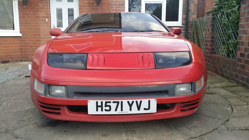

Here is how it looks at the minute with my fibreglass front cover. Just finished painting it... had to cut all holes out myself, hence the odd look aha

Mmm. Not wanting to offend dude, but I'd probably have spent some time tidying your car up rather than do what you've done; it looked nice in the first pics you put up. The stance at the back looked/s great! :) Appreciate it's your vehicle, but spending time on stickers and vented nose panels when all the trim is peeling. the tints are lifting etc etc....do you still have the original nose panel? Have a go at straightening that front bumper, or even get a second hand replacement as it looks like it's riveted together, an engine pan cover/support, redress/paint those roof trims etc. :) Just a more productive use of time for your project...? :)
Edited by Funkysi
Fully understand where you are coming from mate. Tidy the car up then think about other stuff. I do agree with you to be honest. I just get carried away aha

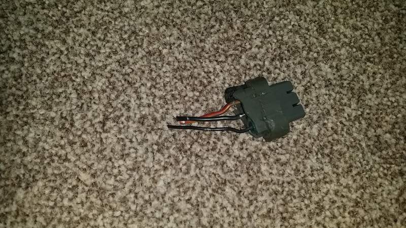

Poor starting, poor driving and big misfire... All because of this guy. Sorted now with a replacement connector, happy me :)
