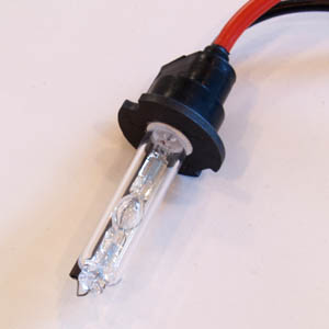

The HID's were the top ones, and the main beam were the bottom ones. (Looks like the Osrams are Halogen, sorry about that, always thought they were Xenons.)

Look guys, I'm sure its the right "H" bulb on the HIDS, I got them from Phutumsch on this site. The picture was just thrown there to show the scale of difference between the type of unit used, I didn't check to see the specifics of the photo, Sorry.
What I'm trying to find out is whether there is something different in the electrics feeding the 2 light units.

I don't have anything other than H3 HID kits so you have not been sent wrong, to just clarify you have H3, 55W and 5000k so you should have a wonderful dipped projector beam.
