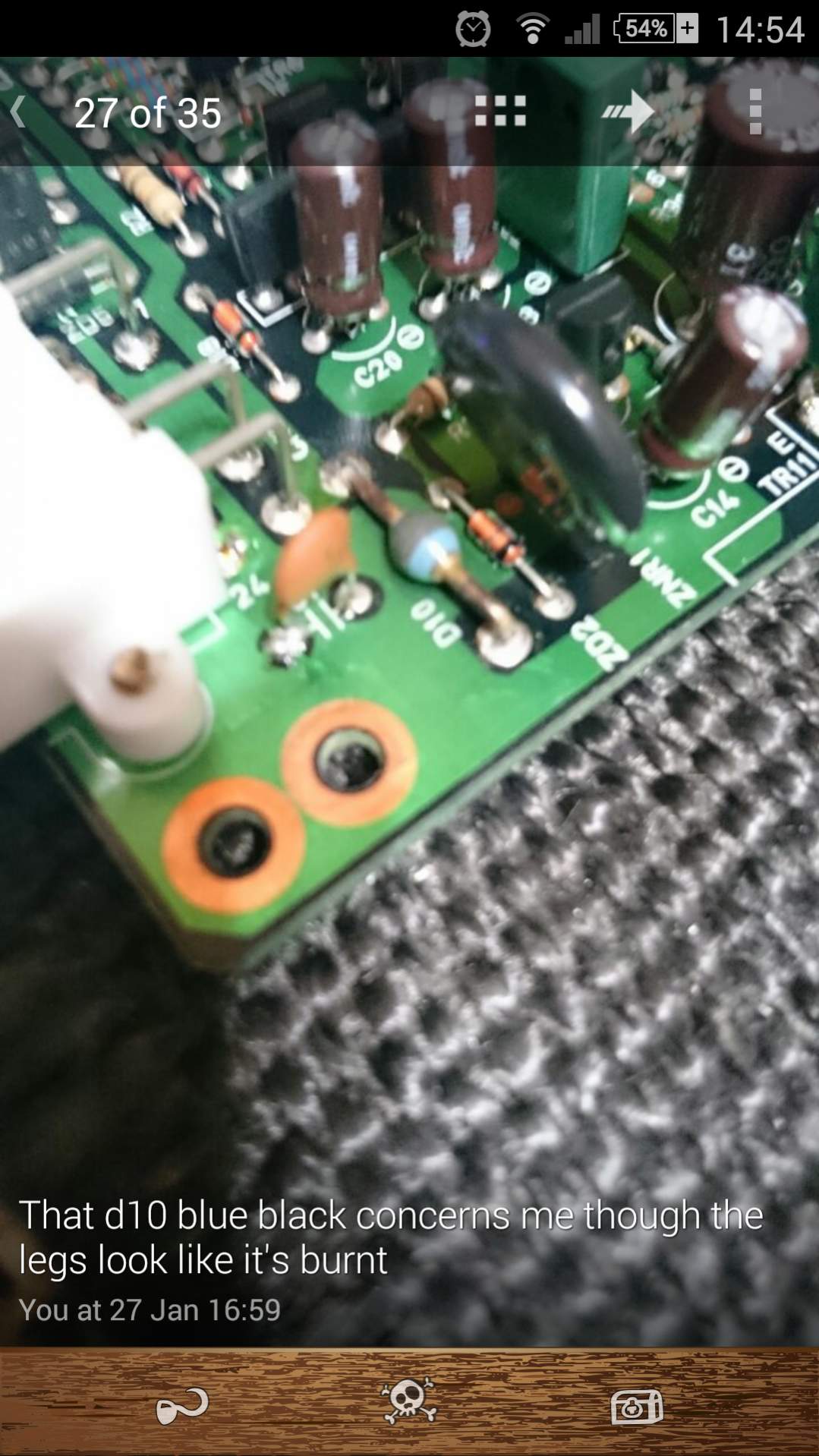

ok, so i resoldered the steering ecu but still nothing. Hicas light is on and no power steering at all even sitting at a standstill whereas before it was intermittant. I noticed one of the diodes? looks burnt. Would a bad neutral switch bring this fault on? Or even the steering pot sensor as mines crap and i can never get a reading.

Update..twas the hicas ecu. Something had failed in one of the components.
Luckily for me Mr Feeney had just the very thing lurking in a dark corner. Issue resolved.
