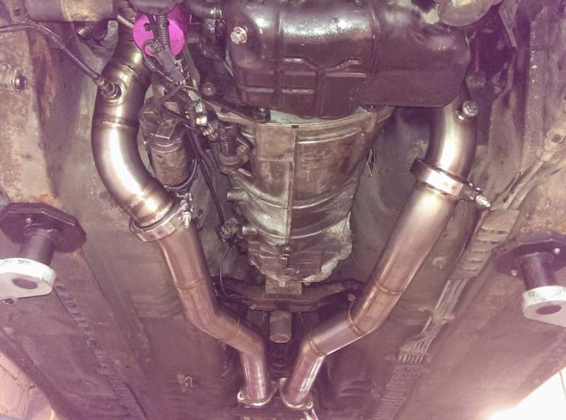

the red beasty is now at powerzed its having a new gearbox fitted, some niggly oil leaks fettled and a bad misfire diagnosed
turns out the misfire was a fouled plug on cylinder number 1 and she is now running shweeeet !! but ive opted to be better safe than sorry and Jim is fitting a new engine wiring loom , the oil leaks were on the steering resevoir connection and one on the oil cooler, the replacement manual gearbox i bought from Mark is fitted with a spacer from Z1 to shim out the starter motor, just the boost issue to look at wont hold boost past 1.1 bar and the rev meter reading 2000rpm at tickover.
while its there i am going for a new 3 inch exhaust system custom made by Infiniti exhausts as the one that came off apart from the tips which i really really liked , the rest looked like Frankenstien had welded it while he was blootered on whisky wearing a blindfold and using a pogo stick ...the passenger side silencer didnt even have a fastener mounting bracket on it.....i would put some pics up but it would just make me sad knowing what i had paid for it ....
it left Noz with 473 RWBHP 527 at the fly so im hoping to see 500 at the wheels minus the cat and with some extra bost .....go baby go !!!!

I had a good look around under your Z last weekend! :) Must say, it does look good. I did notice that exhaust! More holes in it than a colander! The car is in safe hands! :)
I had an Infinitiy exhaust put on mine recently when it was at Jim's they do a top job!
