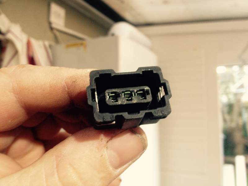

I got to the TPS upper connector and found it was a bit green in the connector side.... Cleaned it and slide back on...... Stalling seems to have temporarily stopped happening.....
Might be the cleaner helping make connection, so am going to route through my connector box of old connectors and see if I have one in better condition anywhere....
I am guessing this is a standard 3 pin bosch type connector as I found this number from on a website???
Bosch 1 237 000 039...... I Might go breaker yard hunting for one..... and take spare TPS with me to check fitment..... It would be handy to have a list of cars that have donor connectors we could use to replace our ageing ones??
