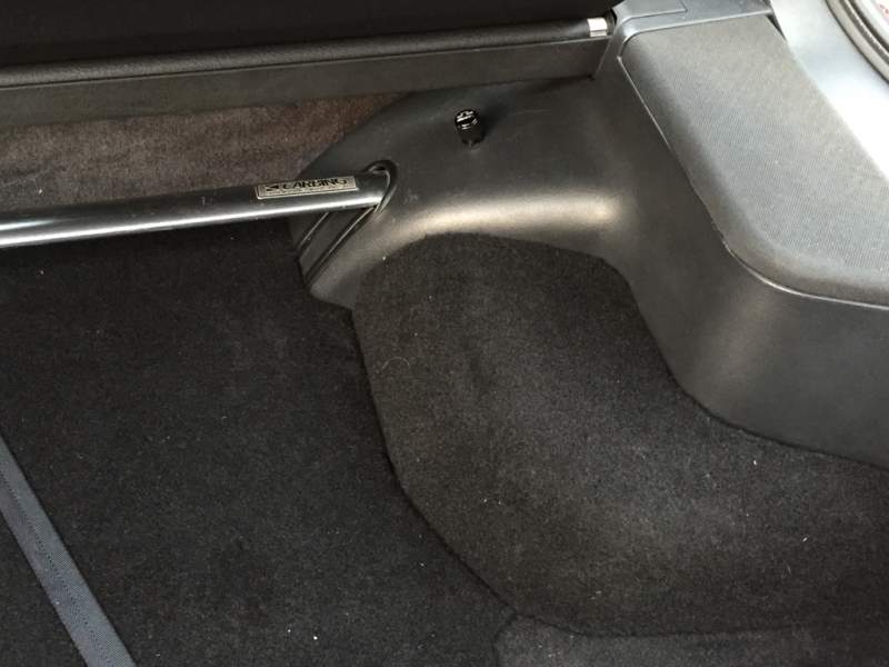

Have you got a picture of what yours looks like Richard?
I would drill a hole and bring the adjuster through It's only 5 or 6 mm you need and you can tuck the adjuster cable under the boot cover frame

I might have, somewhere, mate - but TBH it's not the tidiest job...... I always intended to stick a large washer over the hole to make it look neater, but just did not get around to it...:oops:

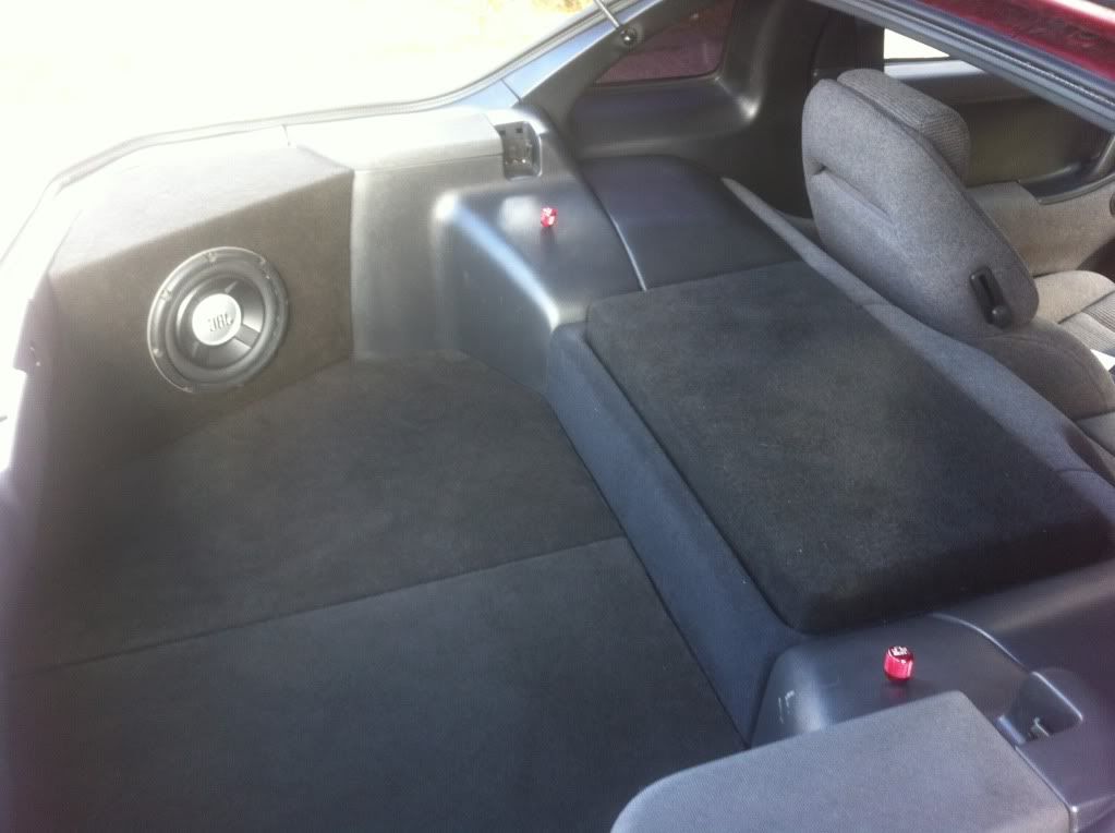

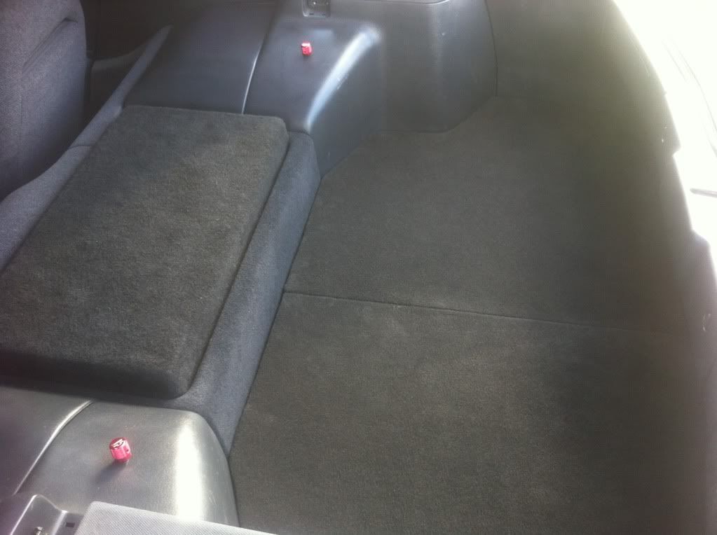

This is how mine looked with extensions when I fitted them .
Hope that helps, Daffy.
:sad: Daffy you have put me to shame, mine look like Jeremy Clarkson did it. On the long list of things to sort out I have just added "sort out the horrendous hacked up mess that is your boot lining Tom you scruffy pup" :lol:
They look really neat, not like I was expecting at all :thumbup1:
