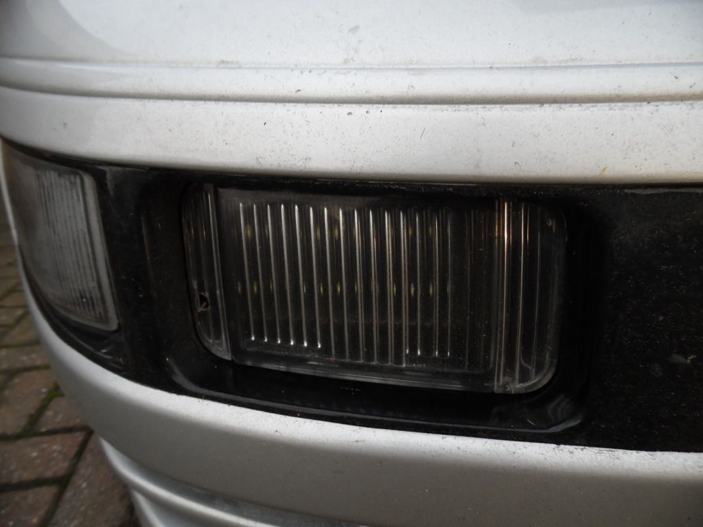

So, Mondo made the trip across to Lancashire yesterday (via Huddersfield) for some of Andy's hospitality and workmanship :)

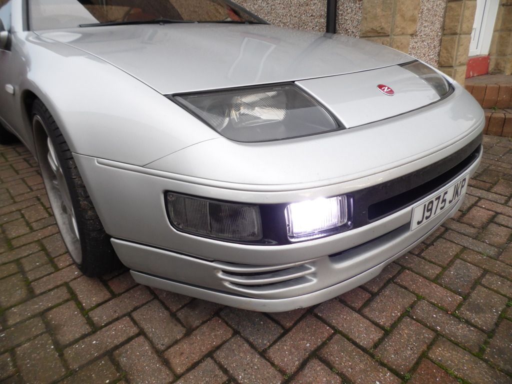

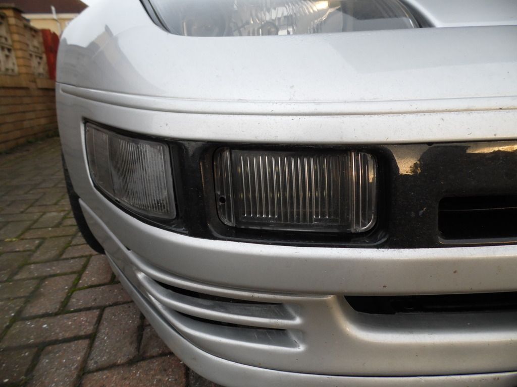

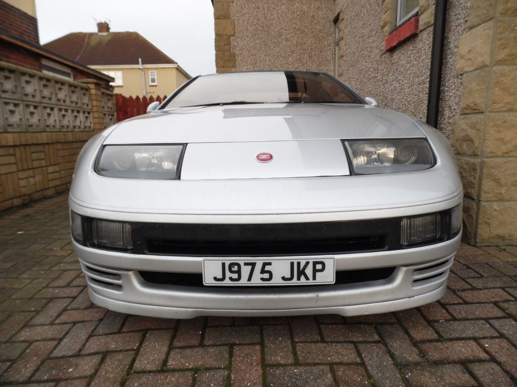

I'd already "smoked" the insides of my JDM indicators to help them blend in with my gloss black 'tache, but this then meant that the foglights were pretty prominent in their chromeness. A look reminiscent of a UK-spec Zed, someone said.
But I wanted full stealth on the front end, so me and Andy put our heads together and came up with these:
The full internals of the foglight have been sprayed gloss black (reflector and fog bulb removed), new lenses and side sections, and all secured with black silicone. The new internals comprise of a black-painted board with 6 super-bright LEDs mounted in each unit. So, as you can see, the entire thing just looks dark and blends in very nicely with the black 'tache and the smoked indicator units :D

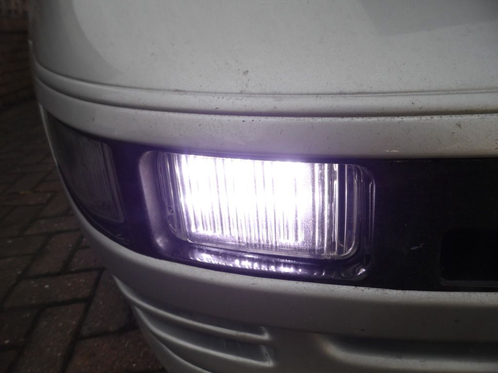

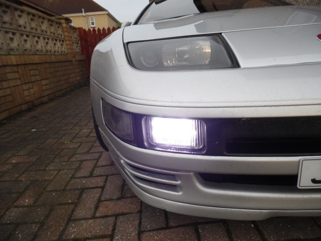

But! When you turn the sidelights on....
These are seriously bright and, frankly, look absolutely sensational! They really (in my opinion, anyway) update the front end of this car and don't look like any of those stick-on DRLs that you can get off eBay. Everything just looks factory, especially as the foglight lens diffuses things just enough that the LEDs are all but invisible when switched off, then hit the lights and BAM! - a nice bright white light that isn't dazzling to other drivers. :thumbup1:
I love 'em. Happy Mondo!

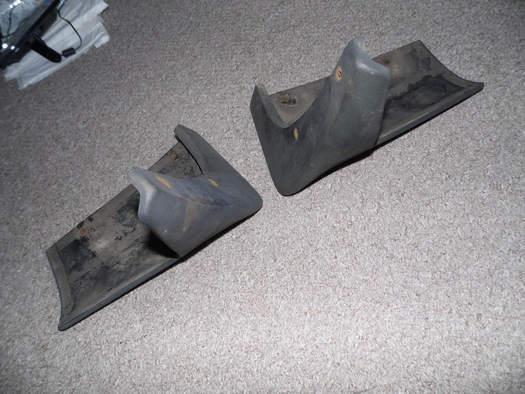

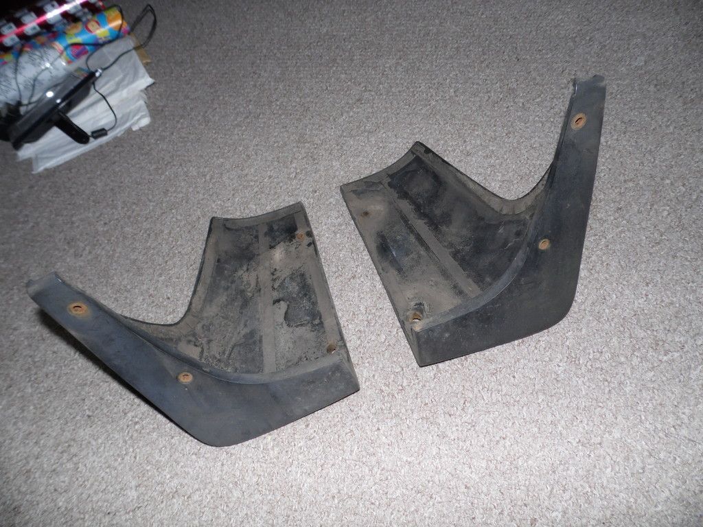

As you might remember, I hunted for ages to try and find a pair of rear SWB spats. After a couple of false starts, I managed to come across a pair on eBay so I snapped them up. One of them, sadly, was carrying a little bit of damage (2" split on the underside and damage to the top mounting hole) but I bought them anyway as they come up for sale so infrequently and I just had to have the proper ones for my Shortie.
The damage was repaired and then I had them prepped and sprayed when the full respray was done and that was that. You couldn't really see the issues but I knew they were there. And it always niggled me... :(

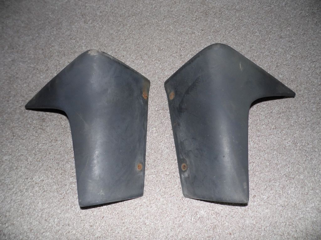

So imagine my delight when these bad boys landed about 15 minutes ago:
Proper OEM Shortie spats in absolutely superb condition! Not a mark or a crack or a split anywhere. :)
It seems Facebook has it's uses after all as that's where I found them for sale. So now I need to get them prepped, painted and lacquered, then fitted. And then decide whether to keep the other pair as spares or sell them to another Shortie owner so they can have the right stuff on the back of their car :thumbup1:
