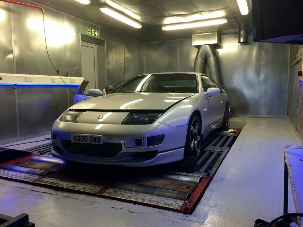

Going to surrey rolling road tomorrow with adl racing,
It's my new swb, that I'm taking,
13psi, fmic, z1 pg exhuast, chipped, afpr, decat, induction kit,
So let's have some guesses I'd like 340+bhp but will have to see

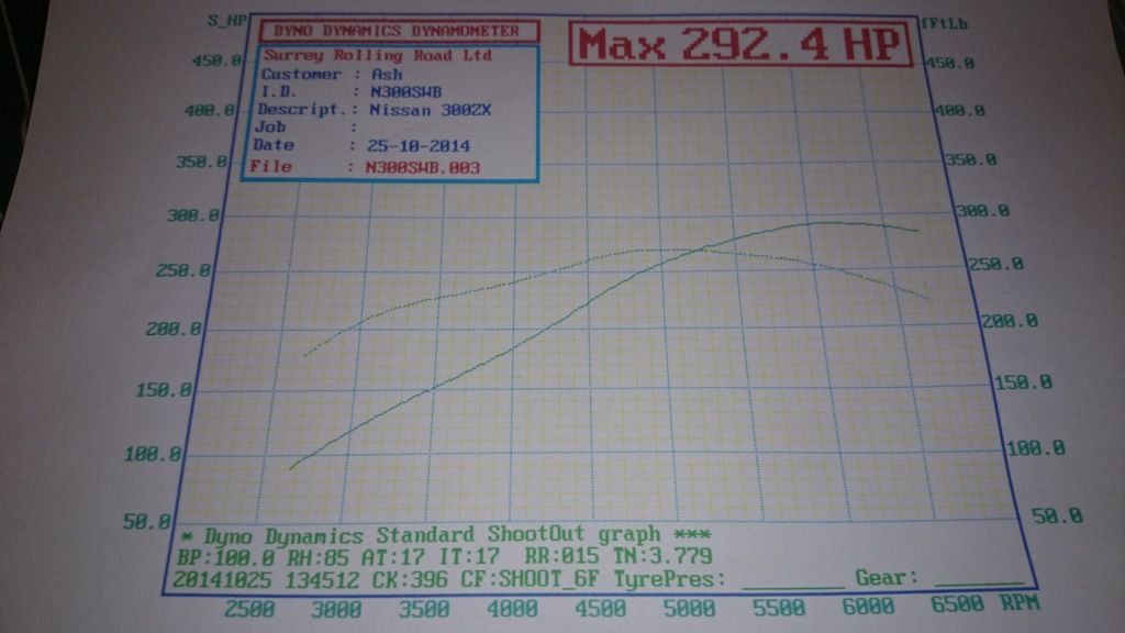

Well we're all wrong....
... It's a pile of poo... 292.4 bhp...!!!

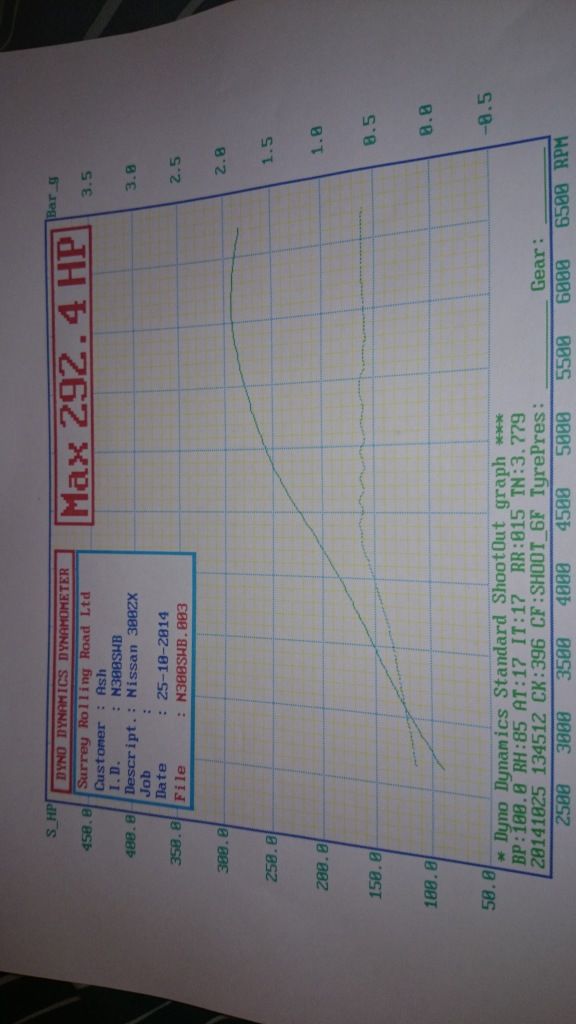

Afr of 10.2 so majorly rich, as boost built,
Profec b ebc played up only boost to 0.6bar even though it had atleast 1 bar all the way there, did it to me a few times on the way back too.
So now the "good " zed needs to be put right again.
Assume the chips at fault for the fueling, but no idea what's wrong with the boost controller...
Manual boost controller, remap, 400bhp.

Is the knock sensor attached? Boost solenoids in place & connected?
I worked with a car that would only boost to around 0.6bar with a Profec fitted due to the car being in safety mode (faulty knock sensor loom). Profec B Spec 2 are great, my favourite EBC.
Edit to add: In your case, as it does in fact boost to 1 bar, it may be that the knock sensor is picking up detonation.

Profec is controlling the boost, you can tell from the low-amplitude sin wave response of the boost graph from 4400rpm to 5600rpm.
Fuelling is appalling. Torque is down on standard. Can't make any assumptions about the timing or other mapping parameters without analysing the chip.
Maybe it is faulty. I've never had issues with them though.
What are the settings? Go through them and post the values in order.
Only other explanation (without looking further afield than boost controller and assoc. wiring/vac lines) is the car being in safety mode and with the boost solenoids being open.
Other than that, it needs investigating/logging to determine what exactly is happening. The richness & low boost indicate safety mode.
