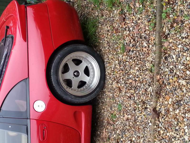

these will fill the arches
These arived today.therll fill out the arches better.then ill get the car set up and sitting right.

Dunno but it was to much before so this will fill it up nicely.before these there was a huge gap with the stretch 255 that were on there before.so the extra 20 mm width must also give some extra height in overall circumfrernce.
Nice, looks a lot better with some beefier tyres, what size did you go for in the end? Any arch rubbing on lock?
Nice, what size did you go for in the end?
there is a bit of a clue in the pictures in post 1.!!!
The 275 is 16mm bigger in diameter over the 255. A 2.5% increase
So there is!
That will hit the inner arch when you hit a serious dip and rub.

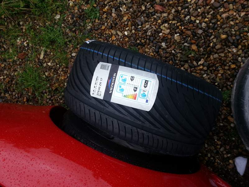

Sorry for the delay but the tyres got delivered on the day when i went to work. So i had to wait three weeks to see if they fitted.
we they did get fitted today and the fit like a glove.perfect and dont rub anywhere.
i know they need a clean as well but they fit a treat. And dont stick out the arches either.
so there we are.i managed to get this one right . 275:40:17.tyres on a 10,5j :17:/31.5mm offset.
