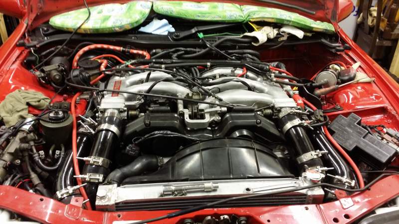

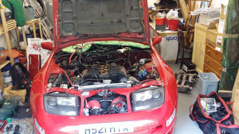

Problem one, rough running. Solution PLENUM OFF! I did this in 10 short hours :biggrin: yesterday.

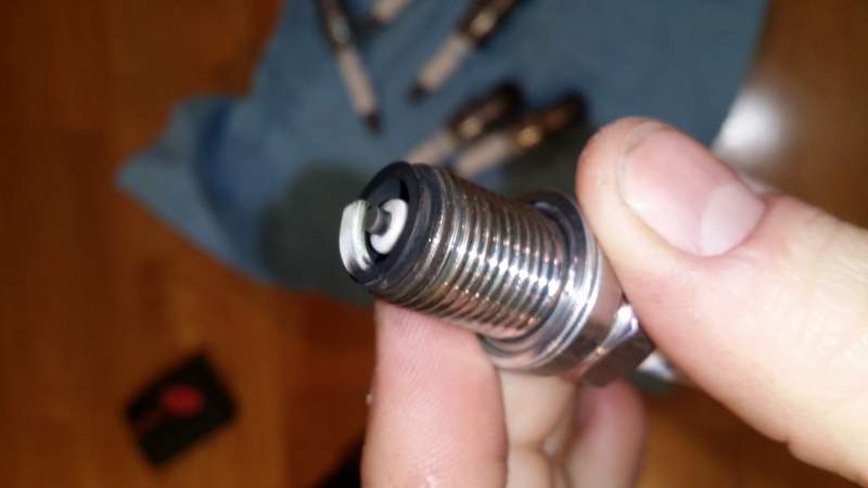

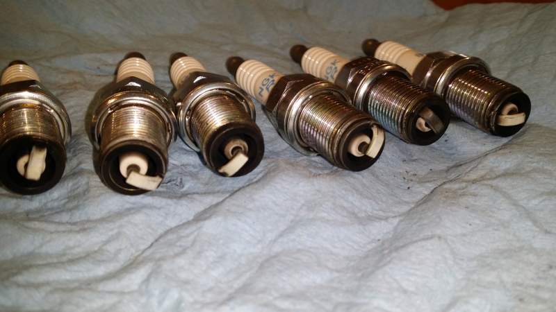

I am going to check all 6 cylinders have good injectors and good spark. Plus air leaks. And sort another bloody oil leak at the back.

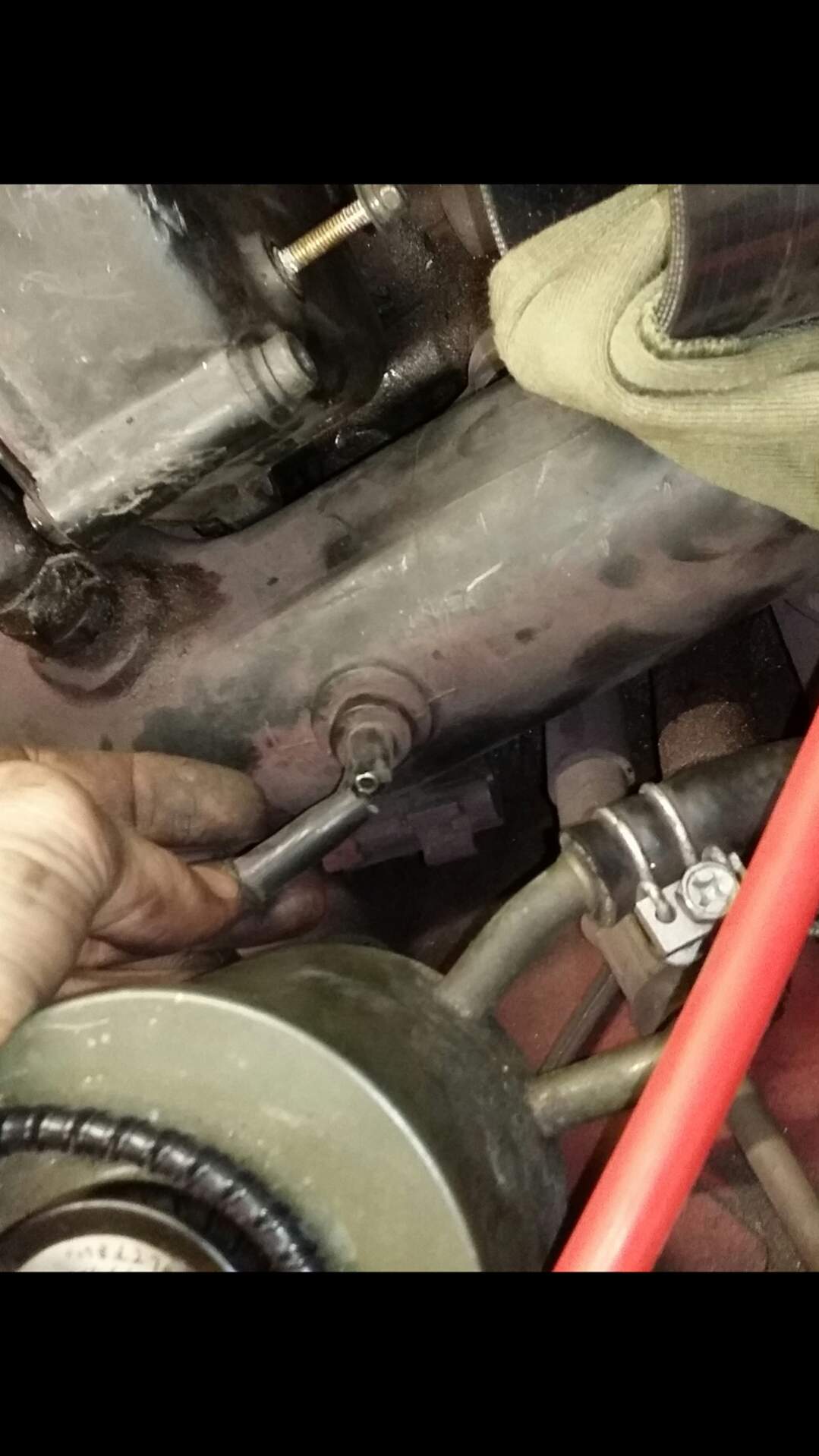

So, the oil leak appears to be pcv related, dripping onto the turbo. More on that later.

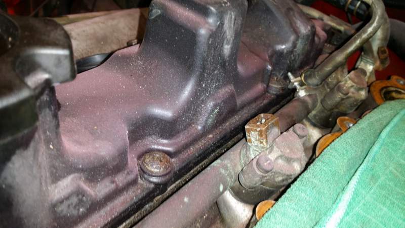

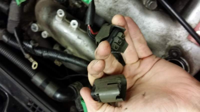

The injectors and wiring are dreadful!
So with that and things like temperature sensors I may have to get new injectors and a new loom??? Or just a partial loom advice on re looming please, or just getting new ends or whatever.

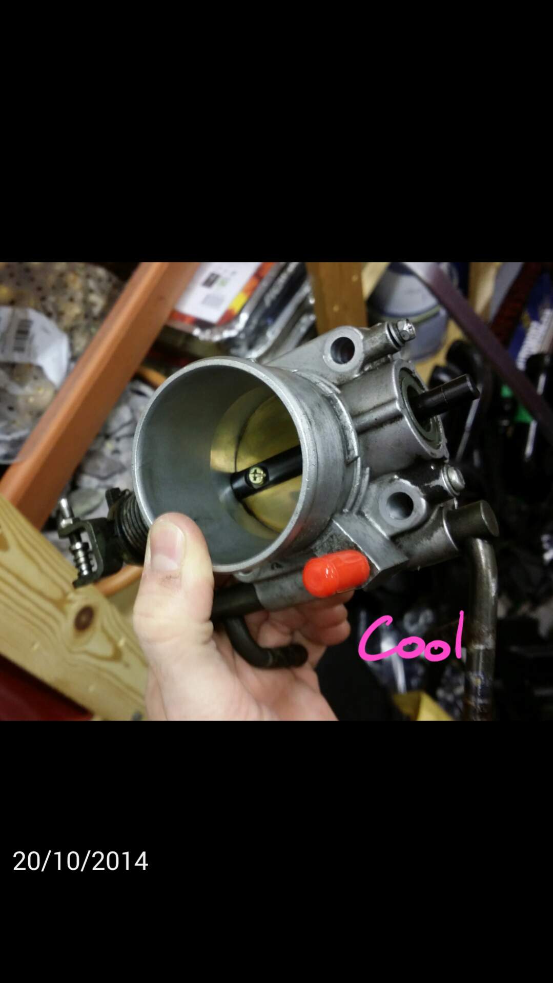

My IACV thing is in a state.

I got all new connectors and soldered them on, took a while but the difference was amazing. The car never ran so smoothly.

With the plenum off but everything else in, a full loom swap is possible then???

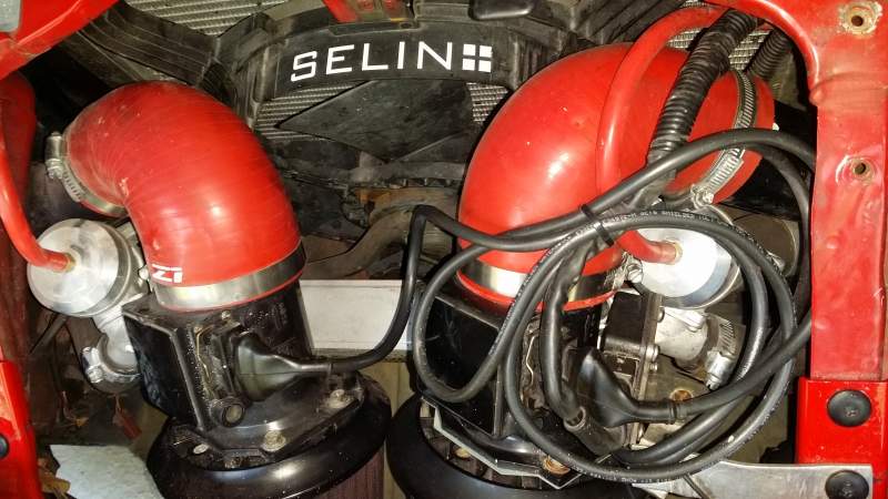

Tom, are your cone filters running separately or through a dual MAF unit?
Selin Dual MAF Translator mate.
They sell two, one with 9 inches of wire and one with 9 feet :wack: they only had the long one in when I ordered mine.

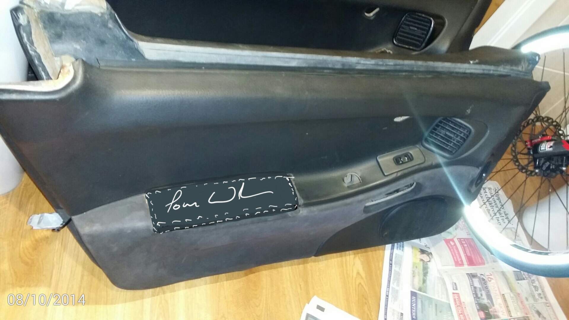

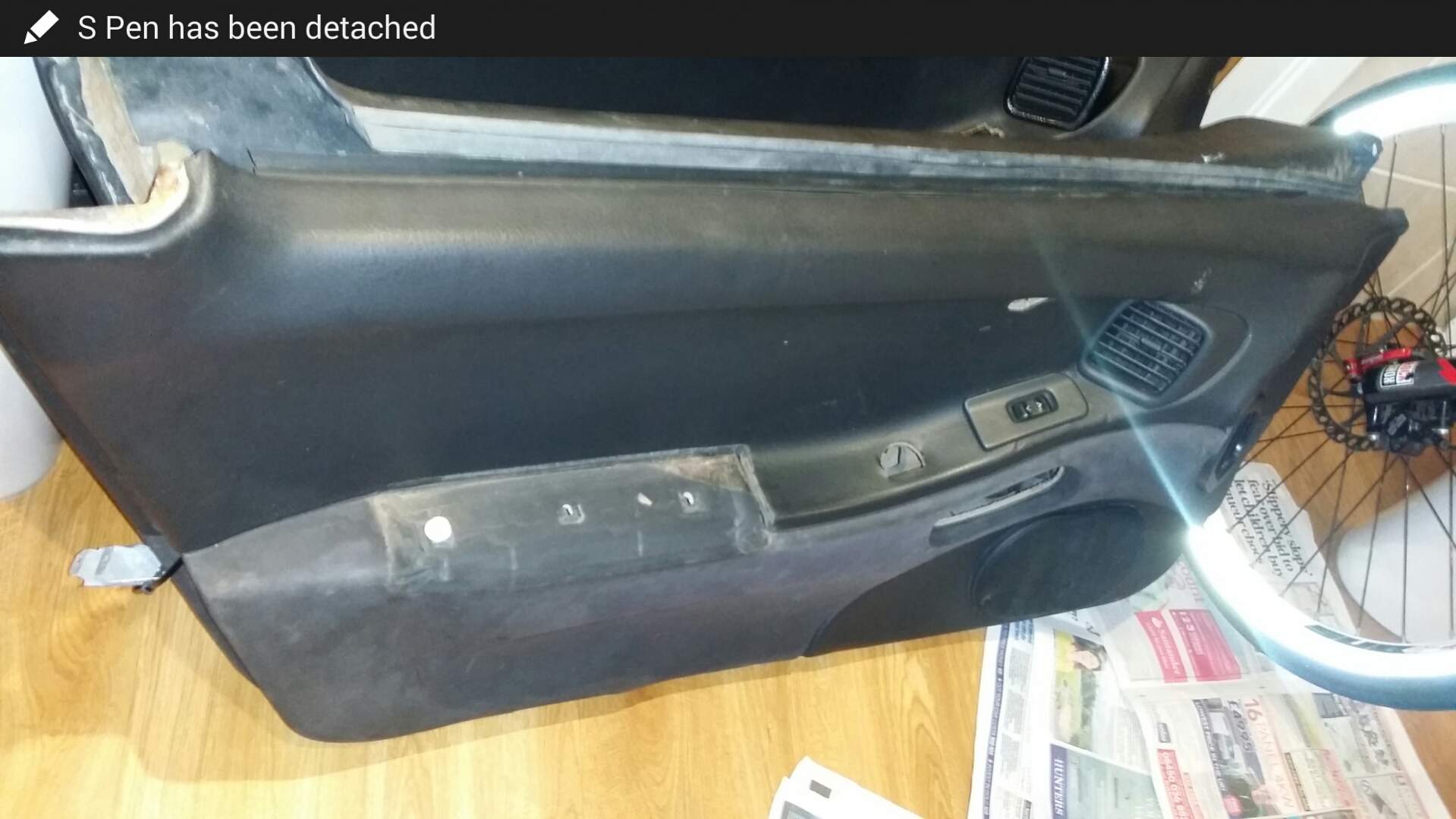

P.s. progress report all the door cards are off and laid out on the floor for a UK spec to Jap spec seatbelt conversion. And some TW designs arm pads.
Don't worry Si, they will look like Jeremy Clarkson made them :biggrin: I'll still have a set from you. But just to get the door cards in. I'll need to make a wooden inner bit and measure the mounting points.

I have found a number of potential problems.

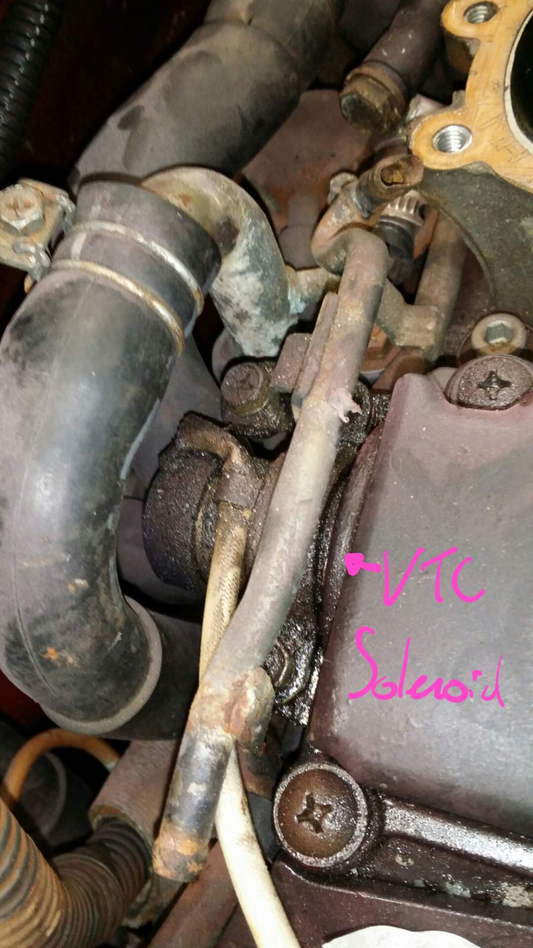

Vtc solenoids covered with oil (old oil I think)
Engine temp sensor corroded
IACV hoses hard, cracked

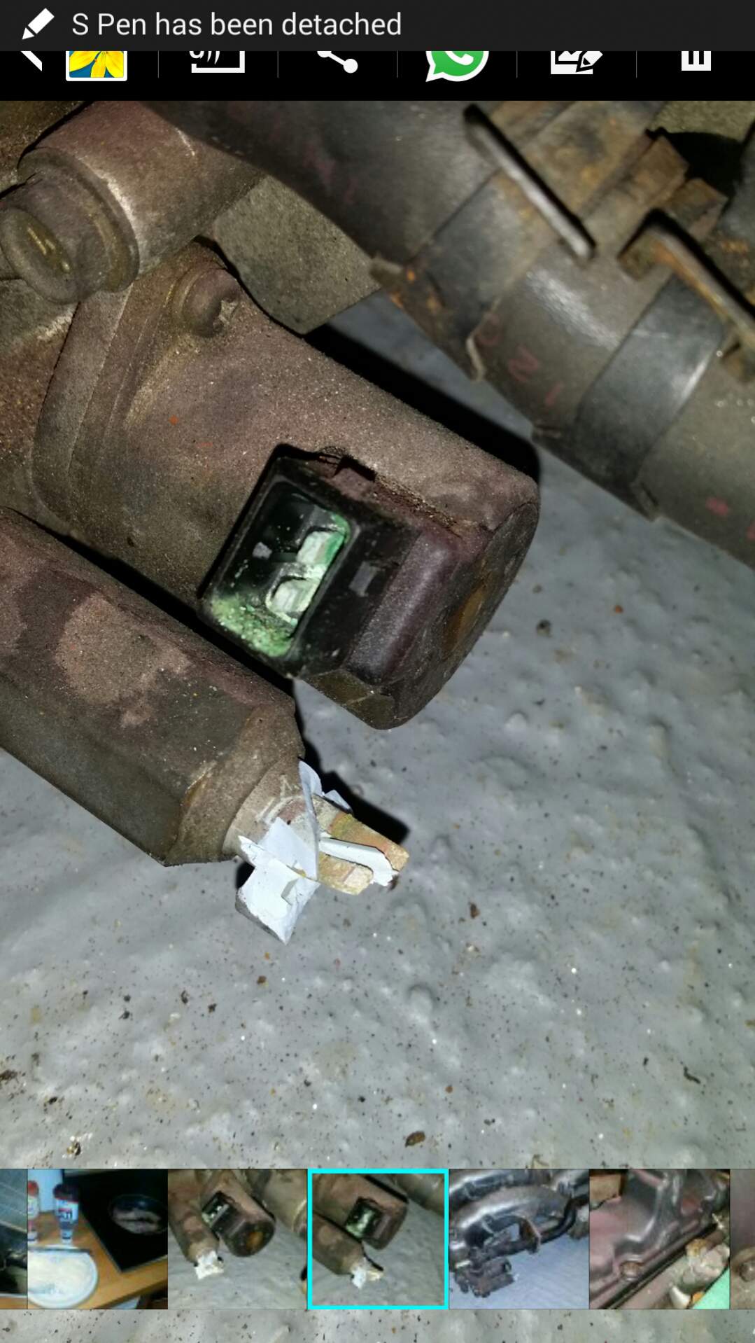

IACV electricals green
ground strap for fuel rail looks like a shoelace found in the gutter
pcv oil lines brittle and cracking
balance bar O rings can not be re used

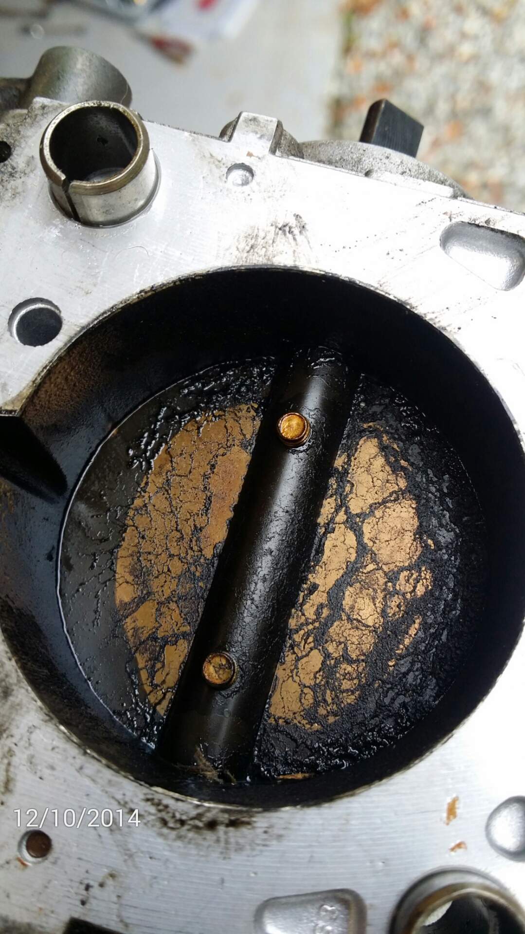

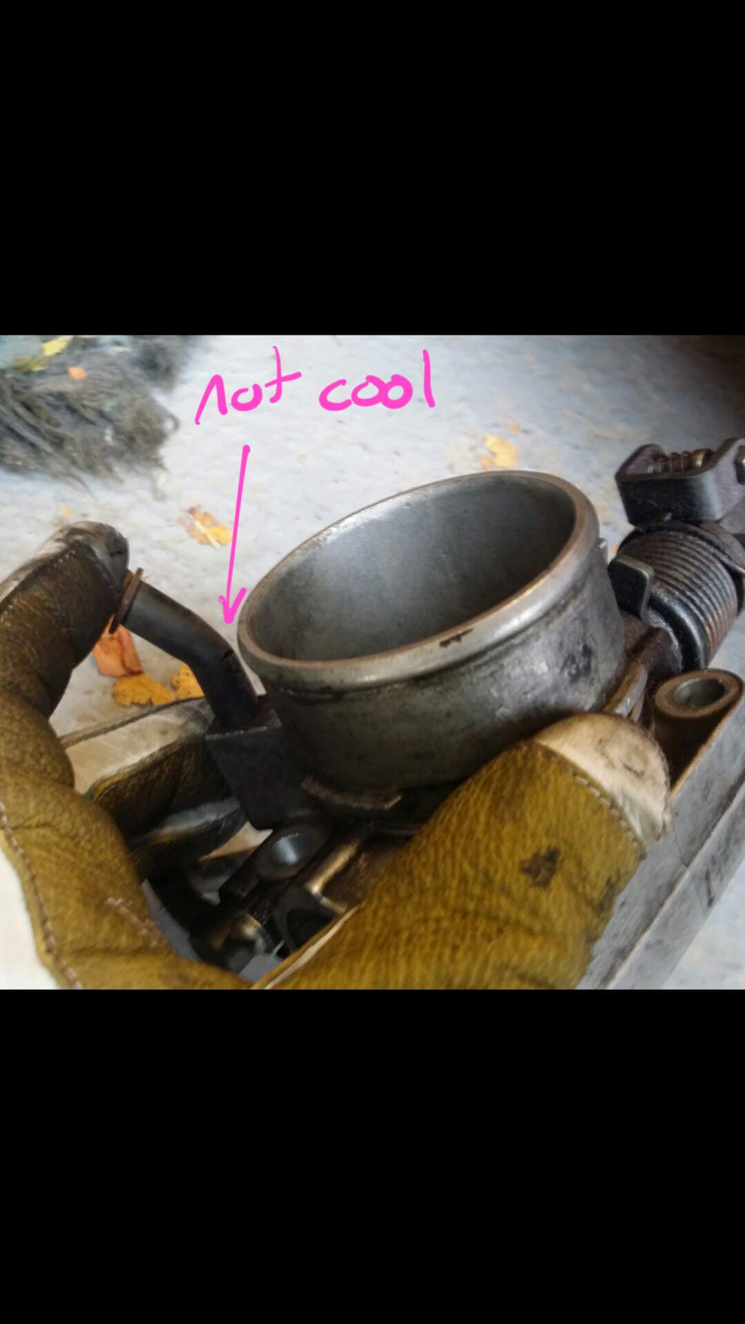

throttle bodies BLACK.
injectors connectors green
Split vac lines badly blanked off.

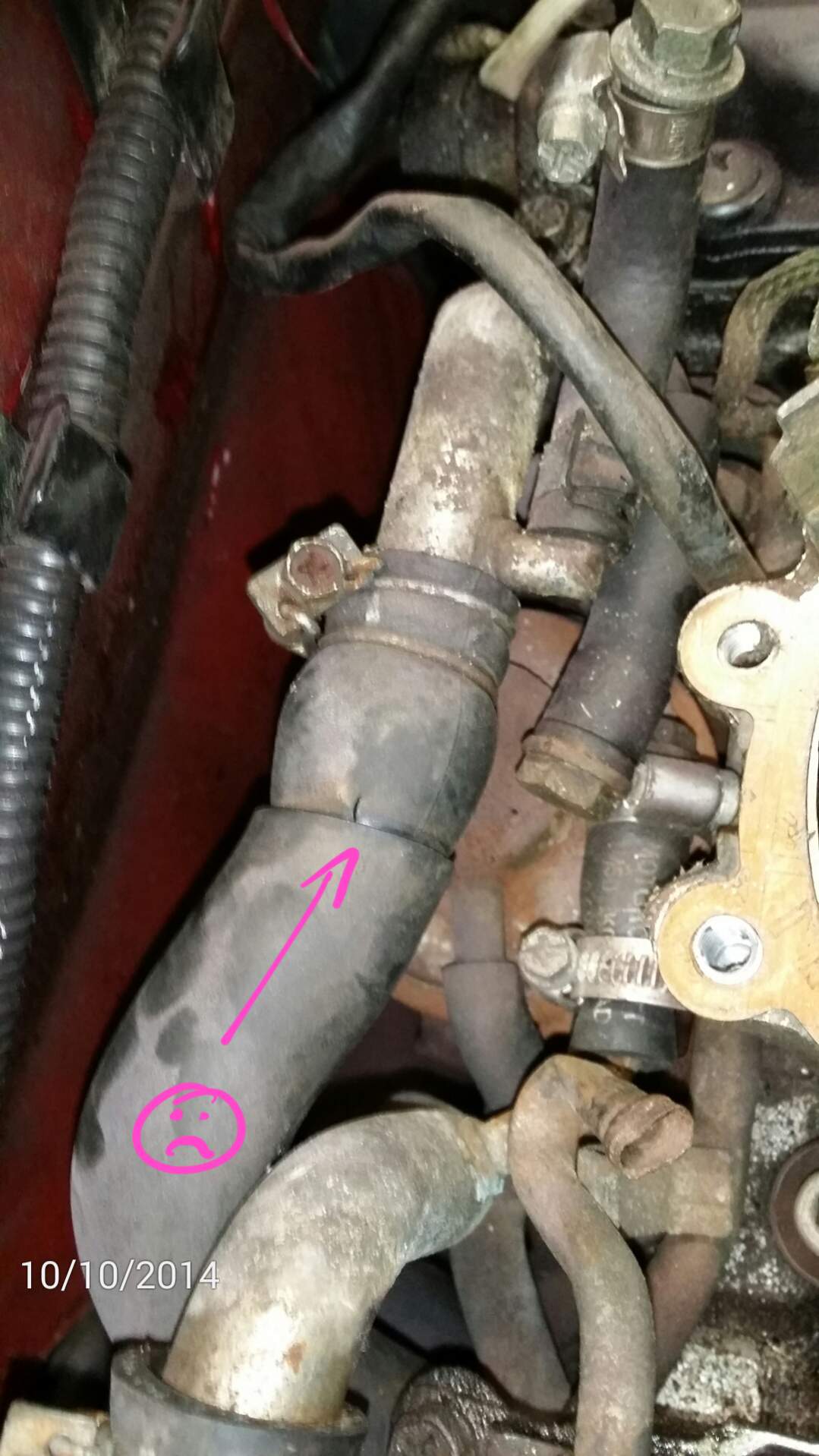

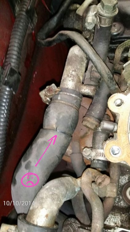

heater hose split

new plugs (bcr8es gapped to 0.9mm and fitted)

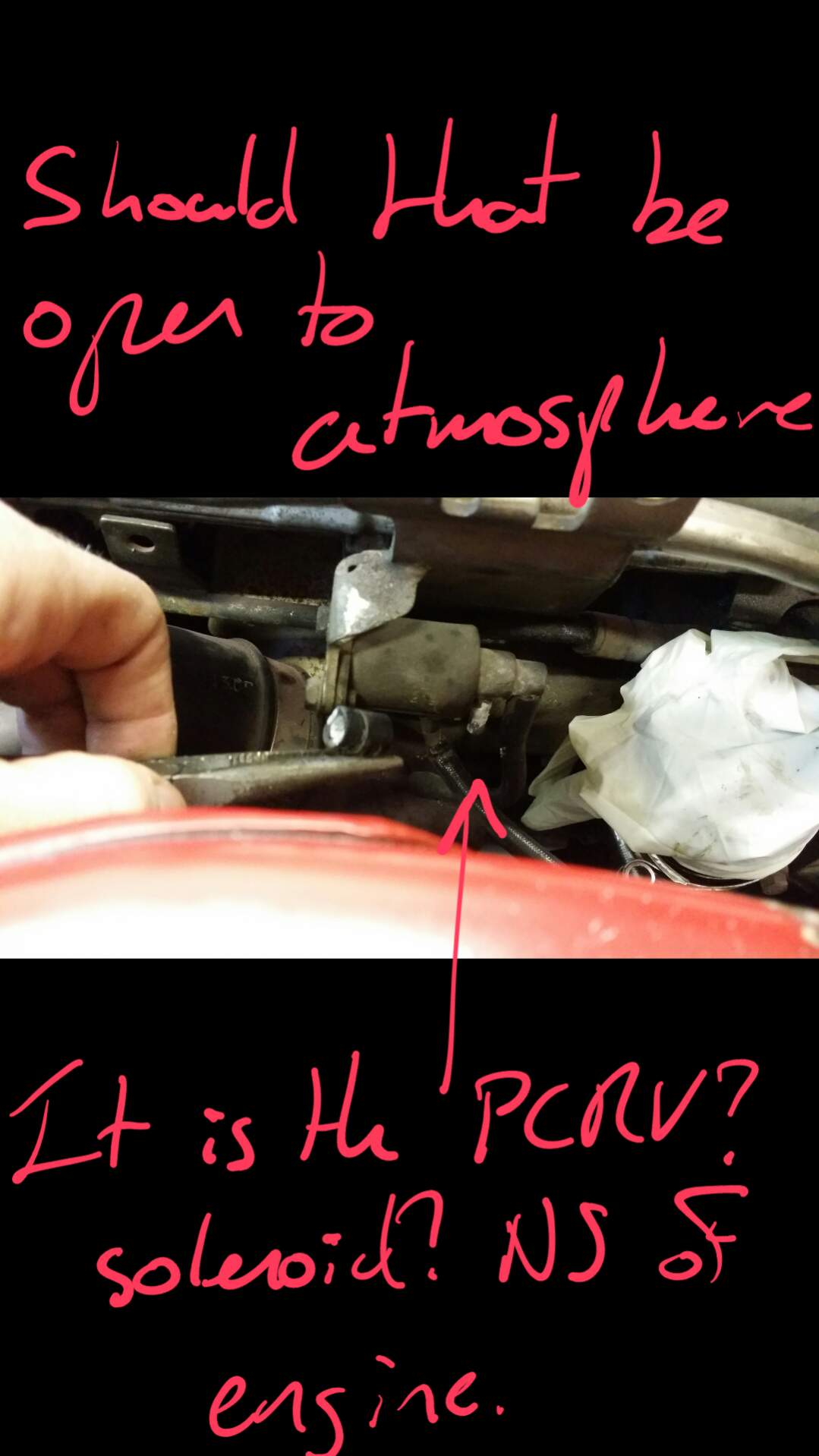

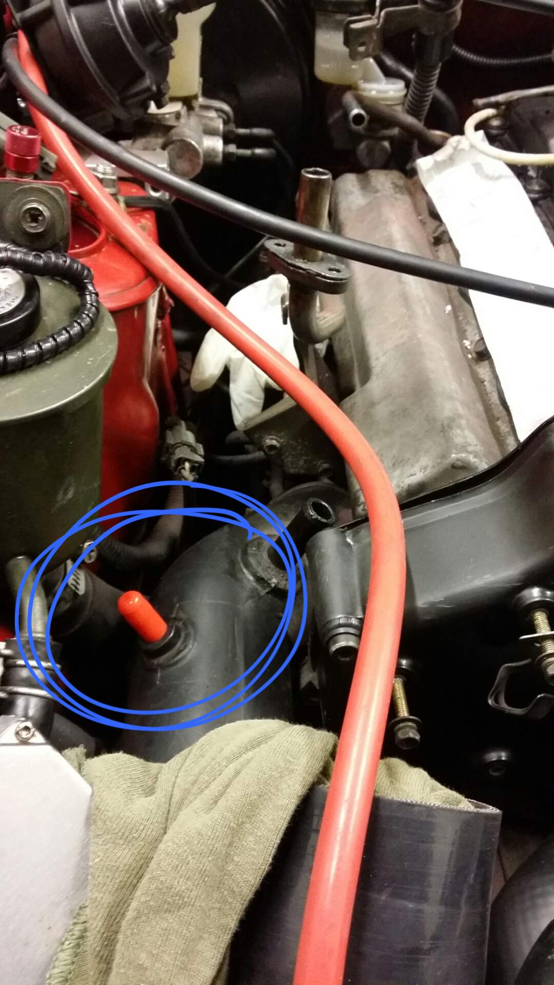

Anyway, yeah the boost solenoid, there is one each side, I thought it was a carbon canister thing, the left hand side one has an open port on it, should it be blanked off or run to somewhere?

Any ideas on the boost solenoids?
