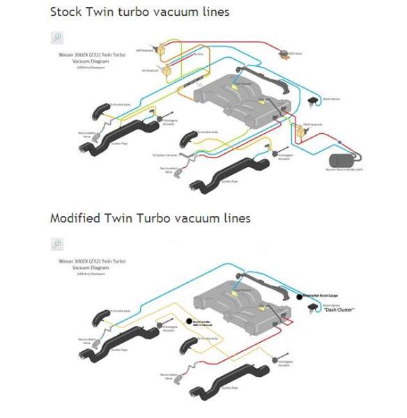

EGR and AIV solenoids are in that corner from factory iirc, it could be one of those two not deleted properly. Before you go crazy, try to trace what the other end goes to, I bet it either goes down the back of the block or into a hard pipe on the drivers side of the plenum.
iff its sucking then screw a 6mm bolt down its neck to seal it up for now...could also be giving a boost leak untill you find its reason to be living:)
