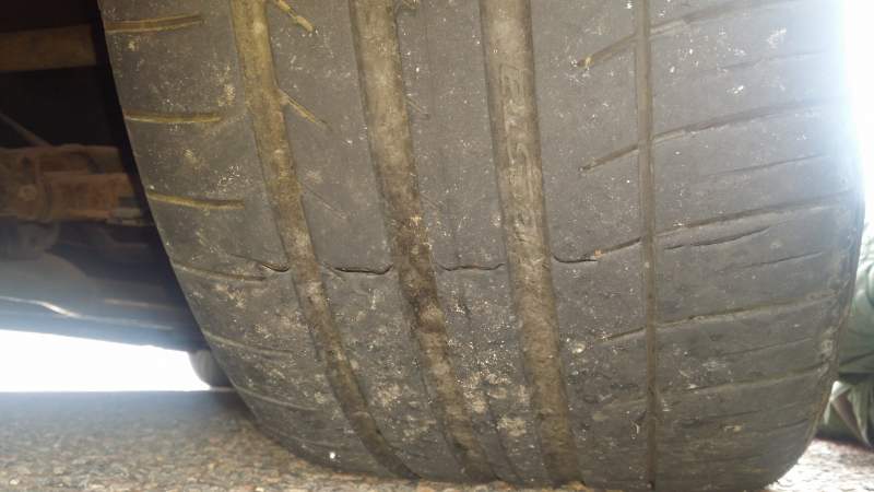

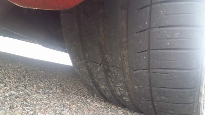

please have a look at this for me
Tyre damage.
With my numberplate being legally cheeky, I was checking my tyres to make sure I was well prepared for a roadside discussion with the fuzz when I saw this.
:( what is going on there? Have I run over a beer can? I wouldn't be happy to continue driving with a back tyre like that!
Looks like it hasn't gone as far as the lowest part of the tread. I'd probably change them anyway though, but I don't think they're dangerous.
I know :/ difficult one, it isn't tyre wear is it, it's damage from something like a bit of metal? I can't rember anything, I avoid cans etc, with it being a back wheel it would have clattered on the underside whatever it was.
I don't really have the money but if it blew out I'd be kicking myself. Bugger.
More thoughts guys, wait or change?
Yeah, probably run over something that's just damaged the tread not the tyre shell. What's your current tread gauge say? Looks like you're 2/3s to 3/4 worn as it is. You could always buy some good part-worns.

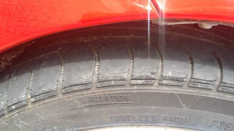

They are all above the wear markers, the fronts are cracking and one of them has been bitten by the arch (not by me) I was gonna get a pair of vredestein ultrac vertis on the front, but two rears too would be too much.
Yeah :blush: I know, I will wait a while on the rears, swap them side to side as the inside is wearing a bit quicker than the outside. But I hate cracked tyres, they've gone off quite quickly those fronts.
No they were second hand rubber and already chewed up, price was right, theyre getting sorted now, not ideal I know.
get em sorted mate there asking for trouble

I will get some brand new fronts, I know you can't mess about with rubber, those cracks have quickly worsened and those grooves were in the tread block not the carcass. The rears... might have to wait, 2 front tyres are cheaper than, 6 points.
