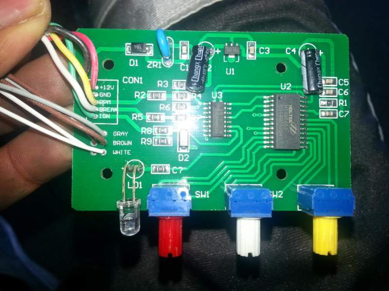

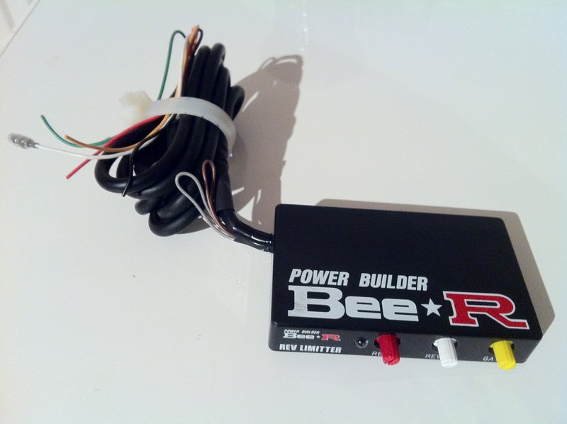

The fake in question:
The genuine article:
FAKES have long looped wires with no heatshrink. Other differences include how far the LED protudes from the casing, the colour shades of the 3 adjusting knobs and the position of the screws on the underside.

Thanks again Noel. I have been looking at a few so called genuine ones on eBay and some of the sellers even show the insides(circuit board s) saying that this is what a genuine one should look like. I opened up my one and the boards are identical, so these copies are pretty bloody good.

You mean eBay ID "semiconductor01"? Although the item is stated as being in USA, he's based in Poland. They are most likely snides too, and he's sold 522 of them. He sells Chinese Takata racing harnesses and A's Dev daughterboards (copied from H Dev). Been around for years, started up when I was on SXOC. The picture he's posted on his listing is of a FAKE item, which is why yours looks identical ;)

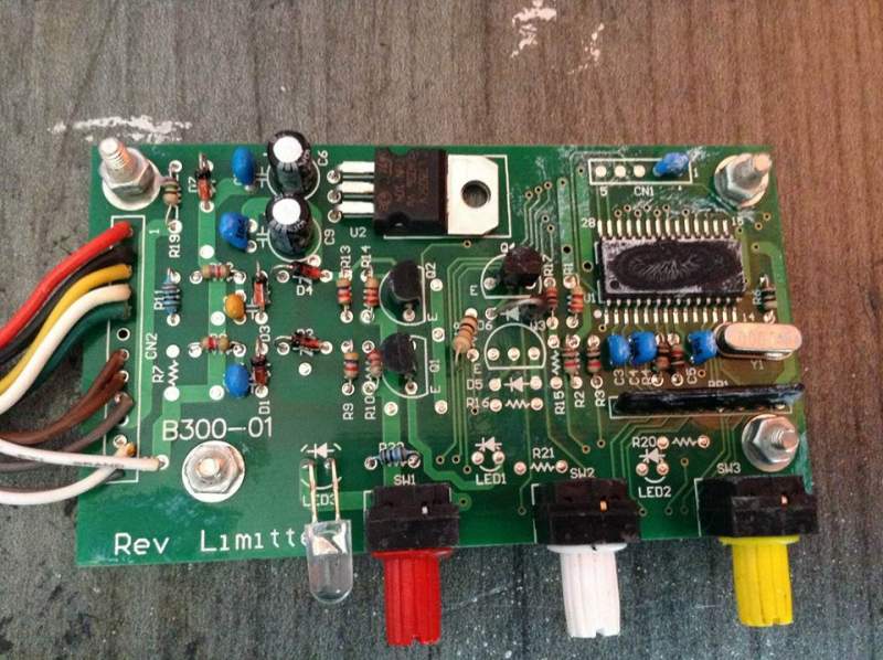

See here for confirmation of what the FAKE units look like on the inside: http://www.supraforums.com/forum/showthread.php?717306-BEE-R-rev-limiter-on-7MGTE-help
A guy over at DW opened up a genuine item: http://www.driftworks.com/forum/engine-drivetrain/173036-fao-electronics-types-modifying-bee-r-not-fully-cut-when-above-specified-limit.html
Blue switches: Fake
Black switches: Genuine (for now...)
There are different versions about, though, maybe Bee*R started less populated PCBs with an additional IC to cut down on assembly costs. The more I look into this, the more it seems that most people own Chinese replicas. The ones in this thread will have been bought from the cheapest supplier, even Chinese replicas have varying levels of quality. If you're buying Chinese, don't automatically go for the cheapest version. Some Chinese items even come from the same factory as the "official" items. Also, replicas sold at official prices no longer appear to be replicas, which is typically the way when a popular item is first copied. Then the price war starts, and soon it's obvious which ones are fake!

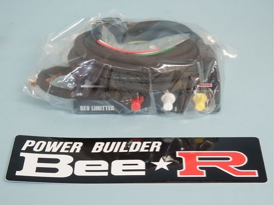

From the "Bee*R Super Website" :lol:
An illegal copy of our product was found.
It include low quality parts and wrong CPU chip.
Illegal copy can't work correctly and malfunction occurs in the system
cause fire or fatal accident in use.
We added serial number to product since 7/1/2013.
Also modified appearance.
Please send photo to us,we check it and make judgement genuine product
or not.
To prevent copy products ,we can't open the exact details of modifications.

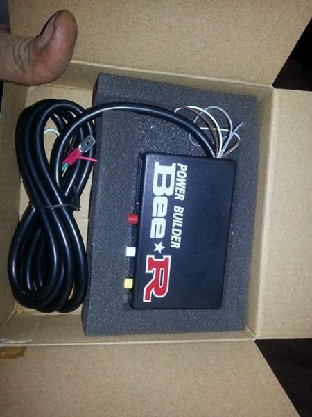

Opened mine up today, it's real, black potentiometers and identical circuit board
Mine came with instructions and the sticker.
And also didn't come for the seller in question.
Thanks for the pictures etc, would have taken it off had it been fake
