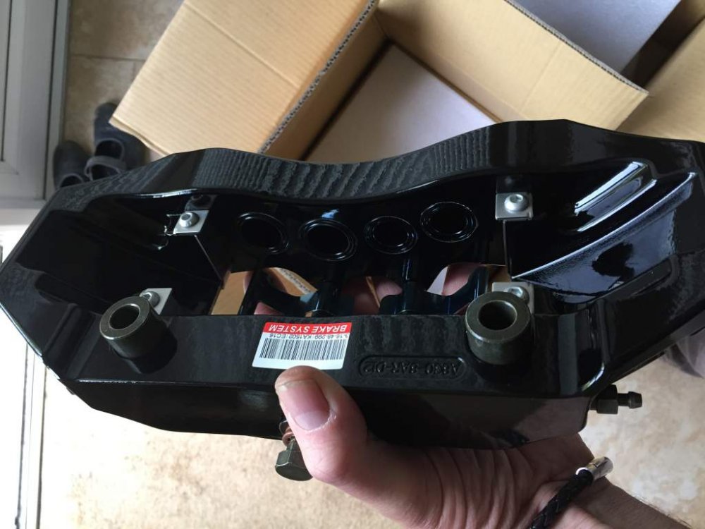

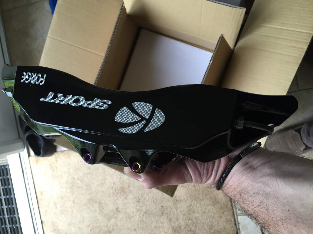

Next upgrade arrived today, looking to fit them over the course of the week. Once I have the Brembos off, the nut on brake hard line is proving stubborn, so I went out today and bought the correct 10mm flared brake spanner. So fingers crossed it will give up the fight!
I went for 8 pot setup on the front with 356mm disks, and EBC Blue stuff NDX pads.
Awaiting the rears as there non available from stock in the UK, and are being shipped from Japan.

i have the very same front and rear just waiting to go on car when its back from paint very nice
The flare nut spanner will help mate. An open ended spanner on those soft nuts is a recipe for disaster.
Cheers Stephen. Will be tackling them Wednesday night.
Anyone on here ever applied heat to the nut?
I know brake fluid is flammable, just wondering if anyone had ever tried it?
I've done exactly that when I changed the brake pipes on my Volvo. I put some wet rags around the lines to keep everything cool and applied some heat with a blow lamp. Worked a treat along with some wd40.

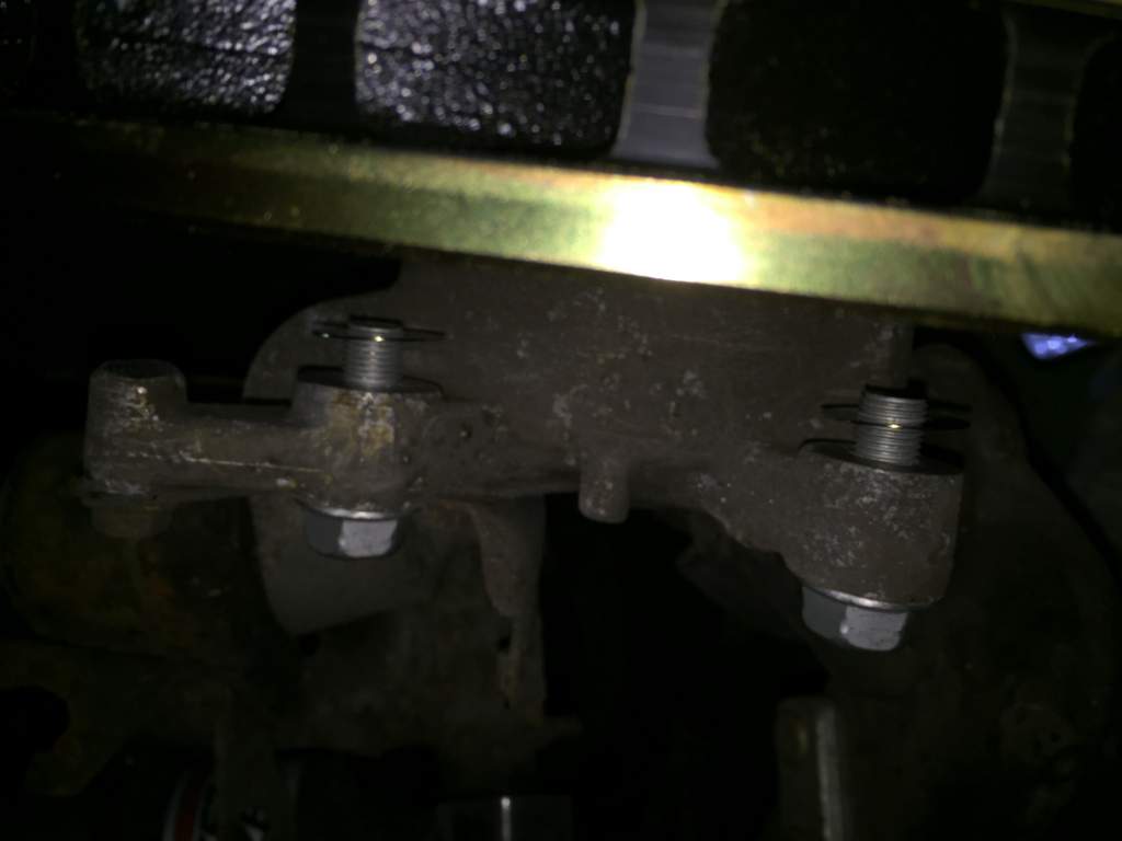

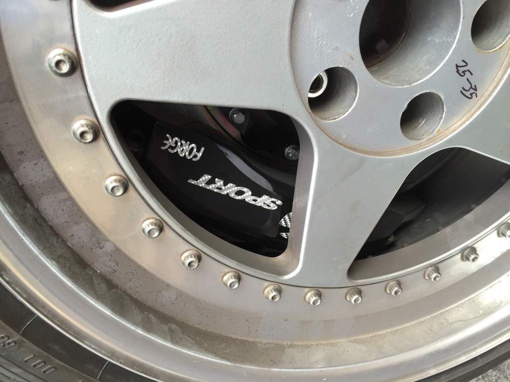

Well the K Sports went on with out any issues. The 'Jnglisg' instruction leave a lot to be desired though.

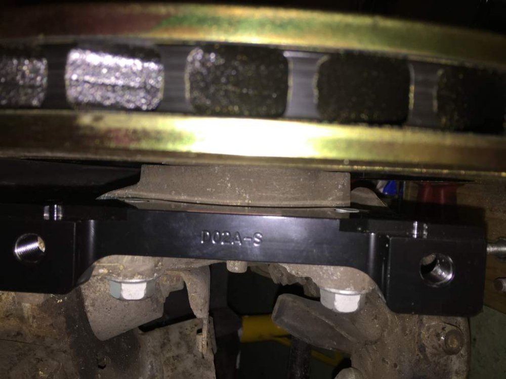

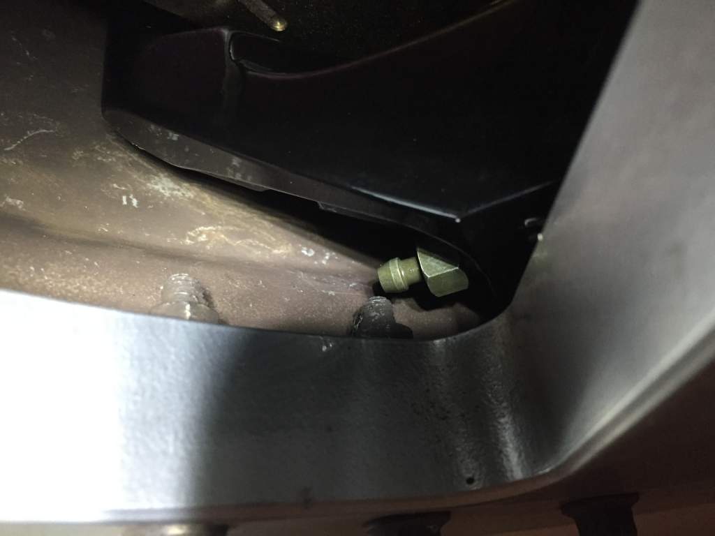

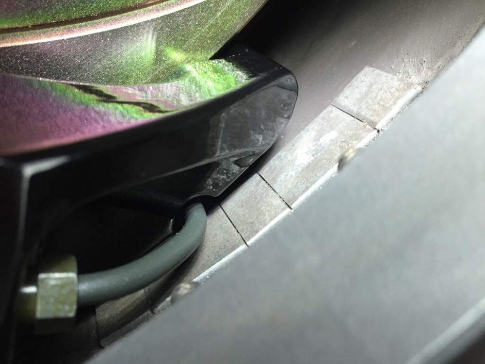

The longest part was ensuring that the disk was in the centre of the caliper mouth. As you have to build up everything check the gaps, and the strip down and add a washer, then build it all back up again. This can be altered using washes supplied in the kit, by adding them between the hub and caliper adapter bracket. I ended up with 1 spacer on the N/S and 2 on the O/S.
I had to take a file to the small area above the top fixing bolt, as it was preventing the adapter bracket sitting flush against the OEM mounting point.
Bracket on below
Caliper on
Edited by bigh

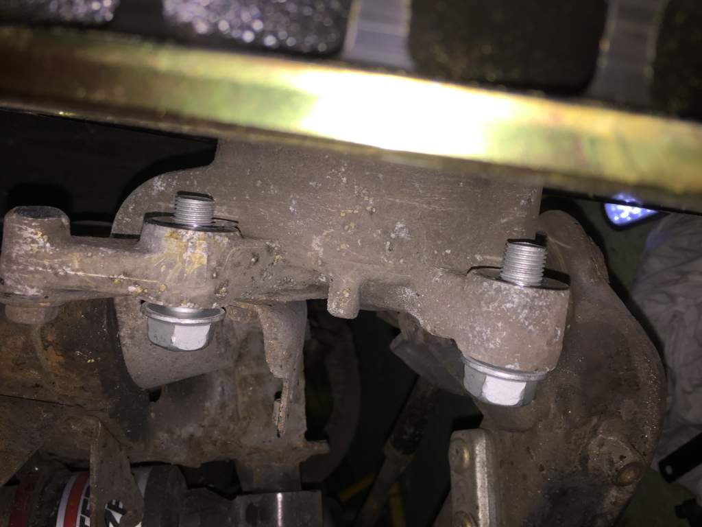

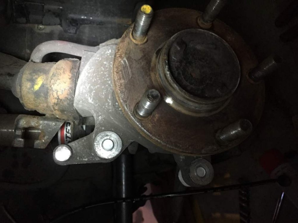

Yes borrowed one from my neighbour Andrew
Had to add my 5mm spacers from my Brembo setup, as the tolerance was a bit tight for my liking, (this is without the spacer)

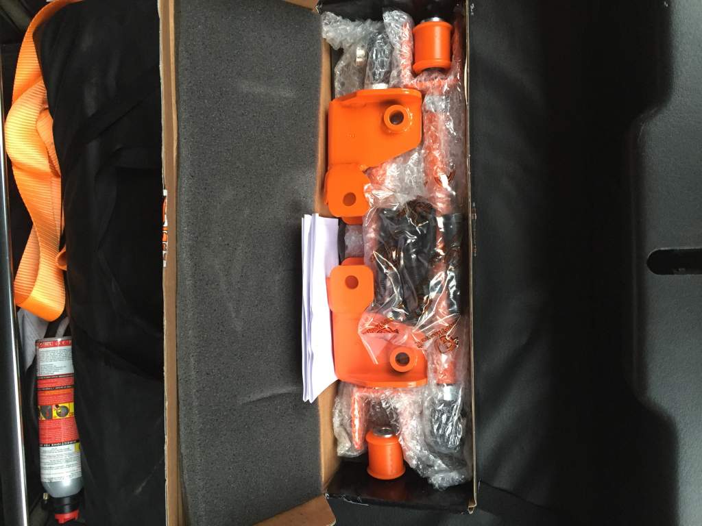

These are arrived today (thanks Josh) little project for the winter months.
Driftworks Hicas Eliminator
[ATTACH=CONFIG]98069[/ATTACH]
Hopefully you're HICAS ball joints come out easily! They were a b**** for me!
