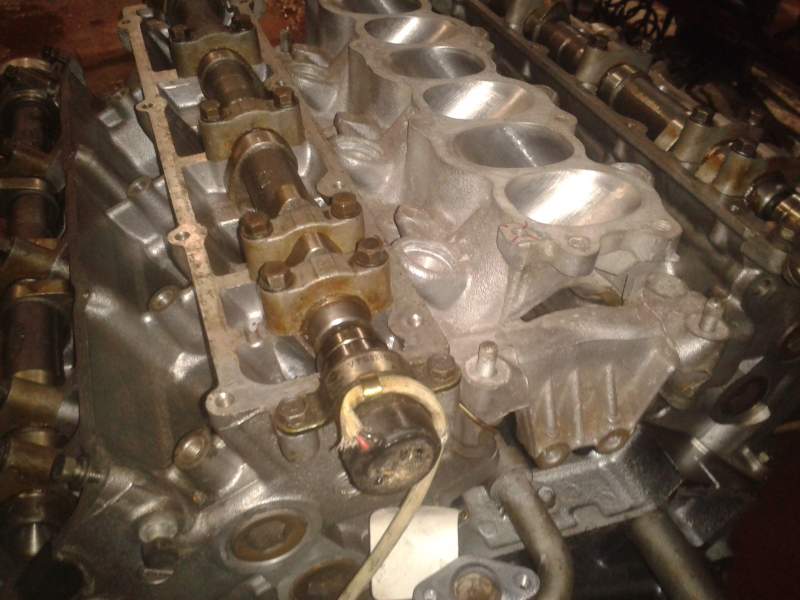

It came with forged internals, Wiseco pistons, Eagle rods, ACL Duralite white metal bearings ARP main con rods and head bolts, Tomie 260 degree camshafts with solid lifters & harder springs, SARD 850cc injectors with a Border fuel rails/ new Turbo's, s/steel manifolds, new oil pump, heads polished, exhausts ports and valves shimed & lapped.
Didn't look all that great mind when it finally arrived to be honest, and I still had my doubts as to whether I had done the right thing in buying this.
After stripping down the engine as far I was prepared to take it anyway,
I wasn't going to attempt to go much further, so I thought it would be best to get this done properly!

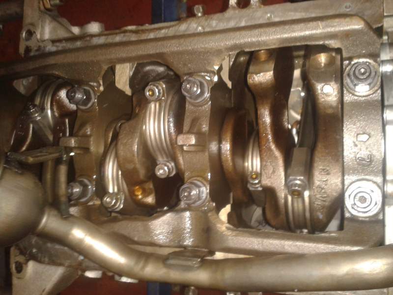

Just a little update...... well it seems like that my concerns regarding the standard of build were justified.
Once Jim had removed the pistons and rings etc he found that cyl 6 had a chipped scraper ring installed. But things got far worse once he checked the bores, they were way to big!
The compression ring gap was 17 thou, should be 3 thou and the scraper rings had a whooping 25 thou! Also the crank bearings were smeared with what looked like regular grease no sign of any graphogen, this engine may have fired up if I had left things as they were, but it wouldn't have run for long or sounded pleasant either.
Luckily for me Jim had a used block in good condition that we could get re-bored to the correct size to take my pistons etc. So another delay in the the scheme of things but at least this engine is going to run as sweet as a nut!

Unfortunatley the heads were machined to the same crappy standards of the block, i.e no allowance was made for the shims. So we started again with new heads, with correctly fiiting valves and Jim had the shims machined to match everything. As Jim put it " if we would have started this up as it was, it would have rattled it t*ts off". So everything is now in place for the install.

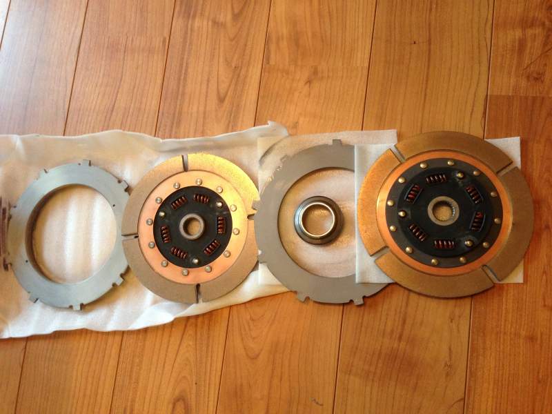

My new clutch plate etc arrived yesterday :thumbup1:
OS Giken clutch complete

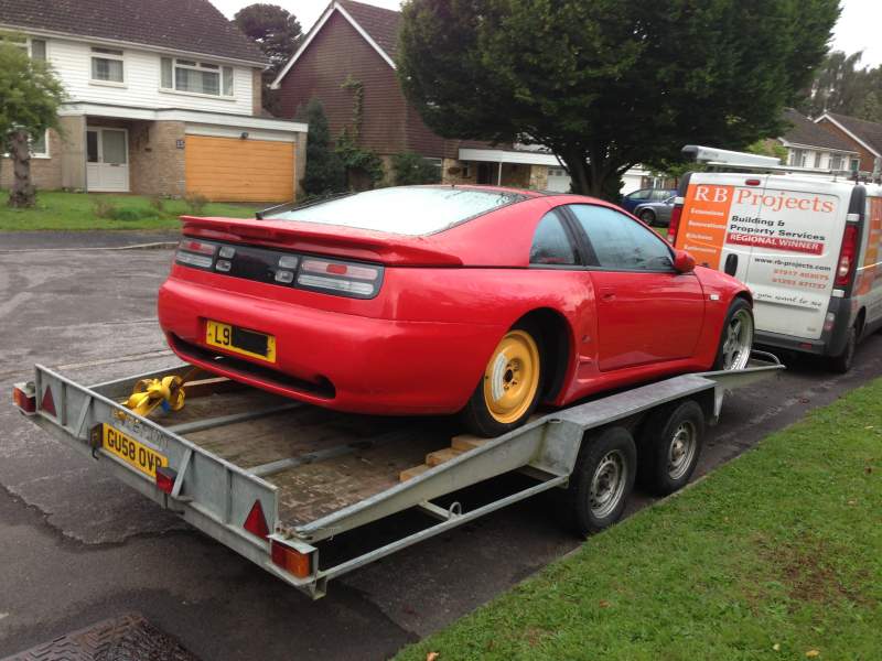

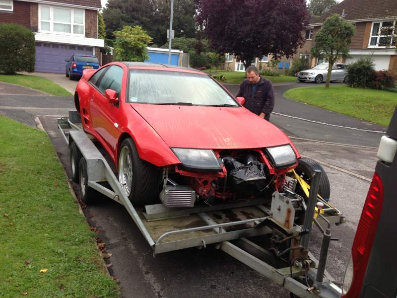

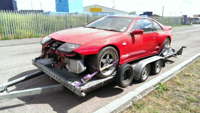

Car loaded, and on its way to PowerZed to met its new power plant.
Being a wide arch even with the spare tyre on it was a very tight fit! By the time we reach Jim, the rear tyre had lost all it's air due to being push so hard against the side of trailer.

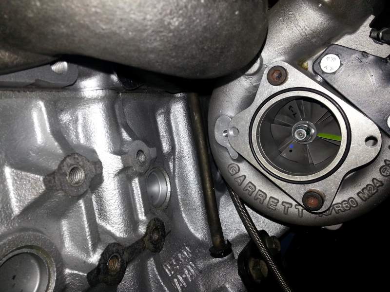

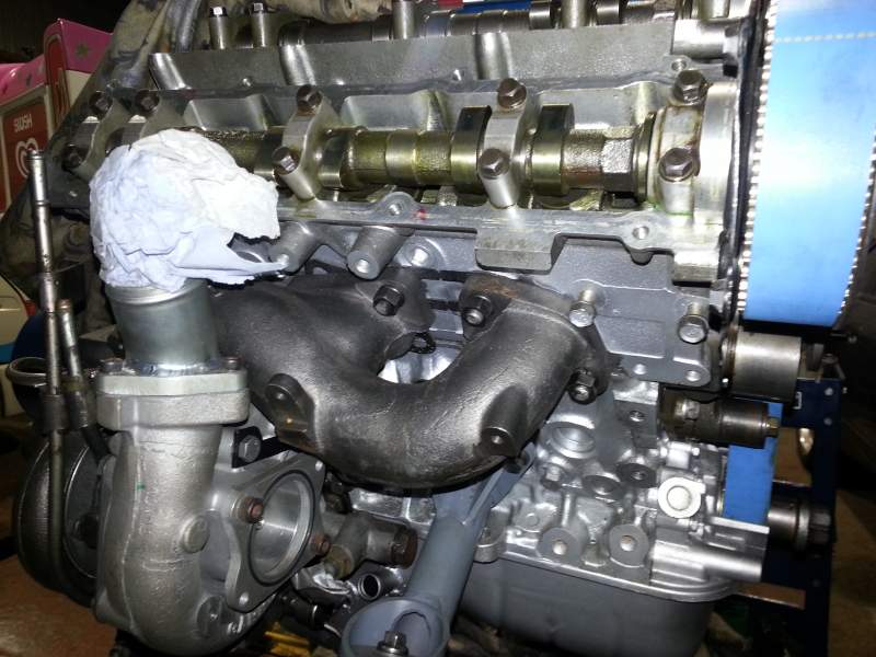

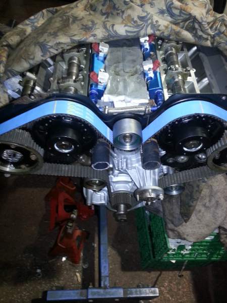

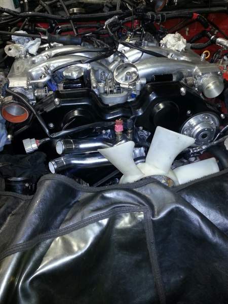

Some more pictures of Jims work on the re-build.
Sorry more pictures of Jim's handy work.

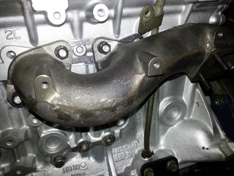

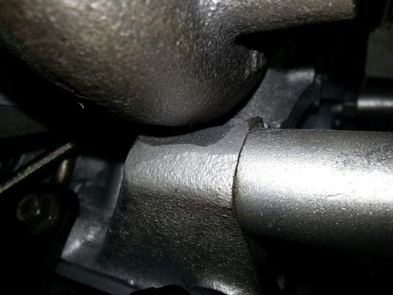

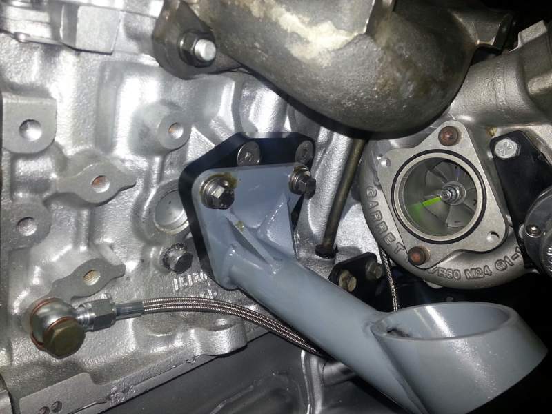

Tight fit! even with the BDE mounts Jim had to get the grinder out
Out with the old and in with the new :clap:
Noz working his magic
[ATTACH=CONFIG]81101[/ATTACH]
Edited by bigh
Yeah I was impressed when I saw the BDE engine mounts! Sure was a nice build, had a good nosy whilst Jim had it! :)

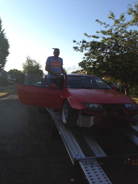

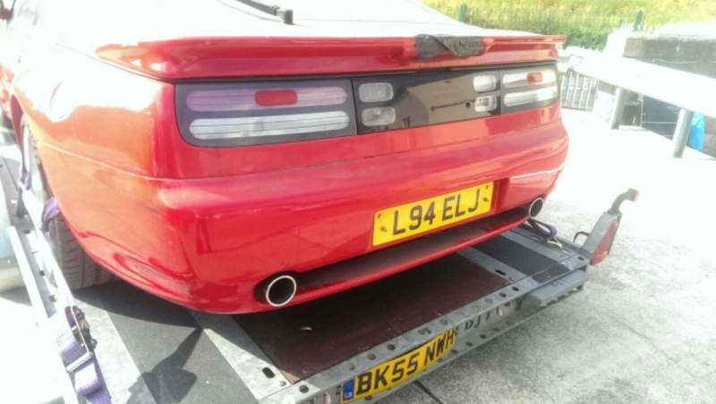

Just last week whilst will Jim has been away, the car was already to have the final part of the works carried out, the last section of the exhaust.
As there is no "off the shelf" solution for a wide arch in either 2.5 or 3" system I thought this was going to be a major problem to sort. But Jim said that a very reputable firm near him could do the work. (Infinity)
Seeing as the car is 250 miles away from from me (round trip) and Jim has no way of getting it to Infinity, I figured on hiring a trailer to move the car.
This is where I would like to say a HUGE thank you to Jaffa :thumbup1::clap: as he trailered my car car to Infinity and back again to Jim's workshop.
That really is appreciated, and just goes to show again how great this forum is helping out fellow Zed nuts. I hope that I can repay the favour sometime Jaffa?
Now with a complete 3" exhaust, 4" tail pipes.
I haven't hear it yet, but according to Jaffa it sounds good... so thats good enough for me.

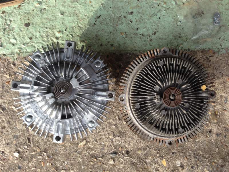

and the first job was to replace the viscous fan as the original was acting up. Bought a 'pattern' from MJP for a fraction of the cost fo the OEM unit.
