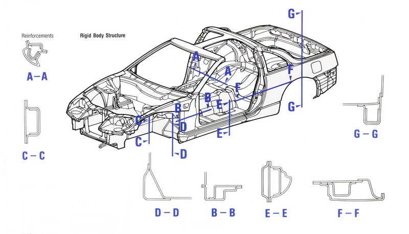

This diagram shows various cross-sections including the sills:
You are a font of Z knowledge!
