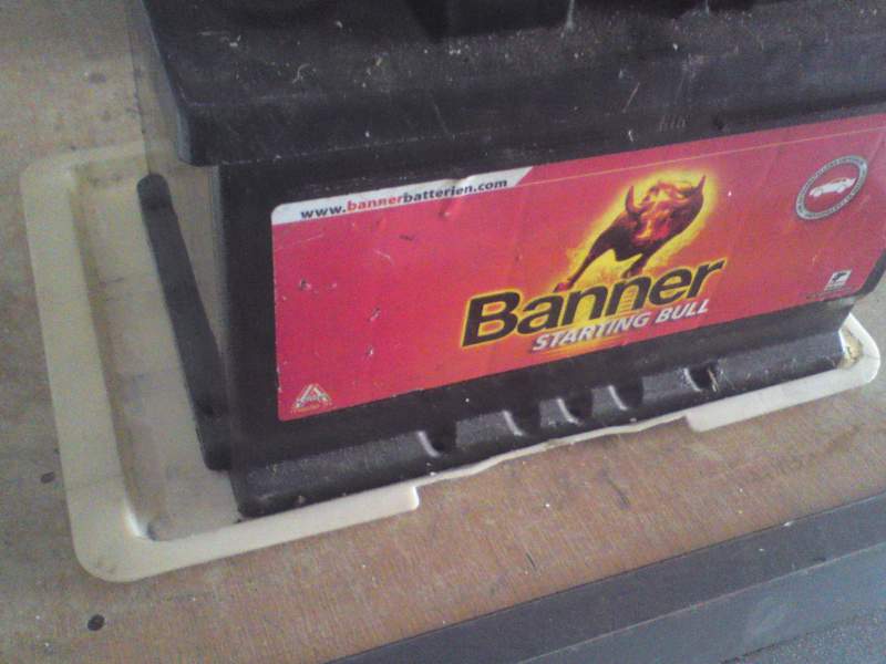

Not sure how it come about but approx four years ago my local garage fit me a Banner battery very similar if not a 068 type, it was the one down from the one they should of fit really according to the catalogue but it owes me nothing, as for most of this period I have been adding and fiddling with the car so hence flattening the battery on a constant basis and this took it's toll.
The size of this Banner was 240mm in length, 175mm tall and in width, I think the one for my car they should of fit was 190mm or 202mm tall - enabling the stock clamps to fit.

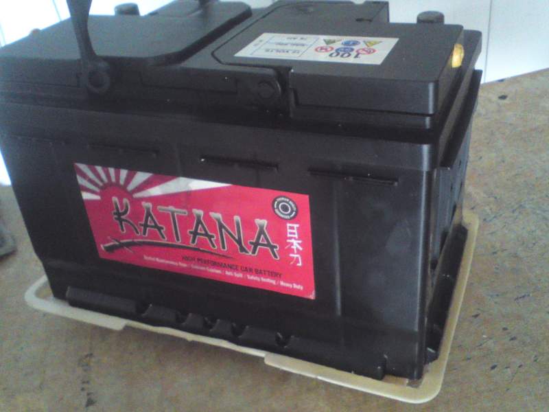

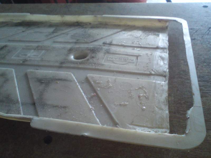

Below is a pic of said battery on the tray, please note I have removed the fins on either side of the tray - I noticed I could buy a bigger battery length wise.
I could of crudely chopped the end off completely on the tray but in my wisdom I cut this out with dremel attachments.
The new battery now fits on the tray and gives me 690cca and capacity 76aH, it's a Japanese Yausa battery apparently, hence the rising sun logo, is a 096 type which is also 100 it seems and cost me a bargain £47.00 delivered, the equivalent one in Halfords is over £100. The size of it is 278mm long and again 175mm in width and height, it is also possible to buy a battery with the same dimensions but 190mm tall. This extra height will put it nearer the earth strap cable as with my 175mm tall one it only just reached and was nearer once the battery tray was turned 180 degrees, 175mm it could be argued is better as the battery can be tilted and lifted out easy not fouling on the scuttle trim.

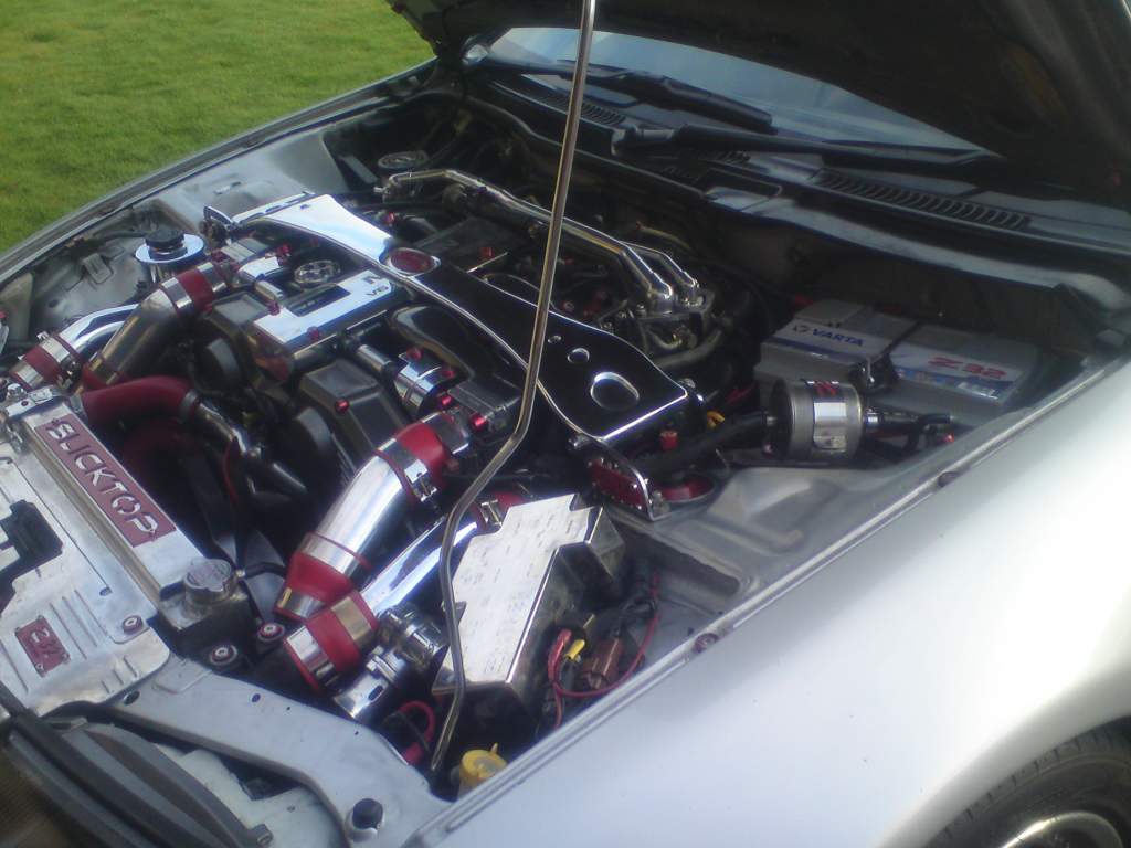

Varta have the common blue batteries, but call me anal - blue was never an option for my red engine bay, they also have black - admittedly this would be ok but the E38 100 type silver dynamic is what i have gone for.........this also happens to be the battery they recommend for highly equipped cars, my merc has a varta for instance and that battery in the boot is a monster and has never given me any concern in years.

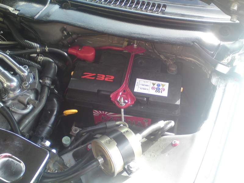

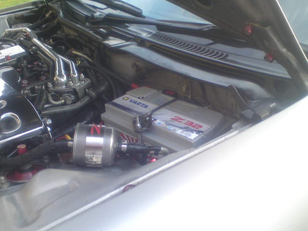

I got the one below for £65 locally, they can be bought on ebay i notice for £65.85 at the time of writing.
I do like the 'low' dimension of these at 175mm height, btw 175mm wide with a length of 278mm which fits lovely again on my slightly adapted tray.
Plenty of power 74ah with a massive 750 cranking amps, tested already of course and as you'd expect very lively.
I've added my voltage display thingy, swapped about the varta sticker so it faced the correct way and added some of my own - trying to inject some red onto it.
I also cut so i get the terminal covers on, positive side needs a shade more work as it vibrates a bit proud but i think these tidy things up a little.
The top clamp has also changed colour to match better from red to dark grey, being this is a shorter battery i have to use threaded rod you may notice.
