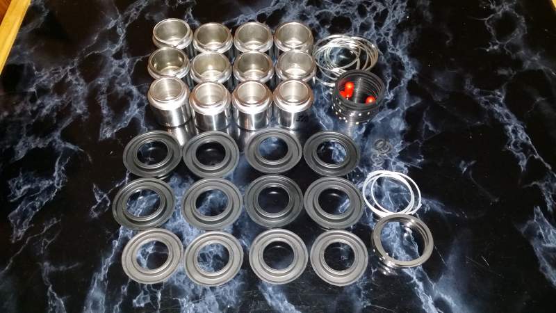

There is quite a good video in YouTube about 300zx brake rebuilds I seem to remember. You can't go too wrong just make sure the bores are clean and go easy on installing the Pistons so you don't pinch a seal.

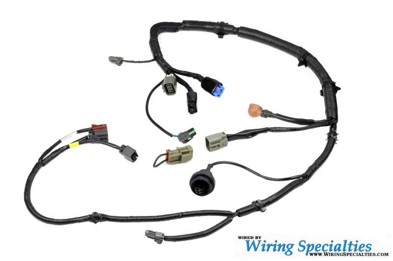

The plug with a loop of wire on it's own? That's a fuse, it lives in that little box up by the brake master. I believe it's labeled engine constant or the like. You can't miss it it's one of a kind, first time I saw it it thought it was some Heath Robison production.

The plug on its own is actually part of the kit from wiring specialties and just figured out its to be plugged into the inhibiter loom.
The manual conversion was done years ago but the wiring specialties loom takes care of like of the neutral switch and reverse lights
with proper plugs rather than hacking of connectors.

The boot retainers on for the Sumitomo callipers are hateful things.
