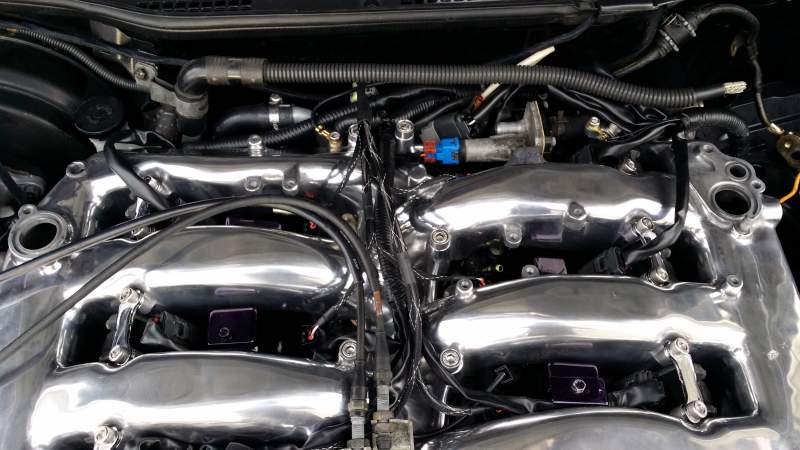

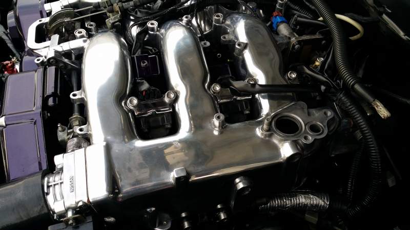

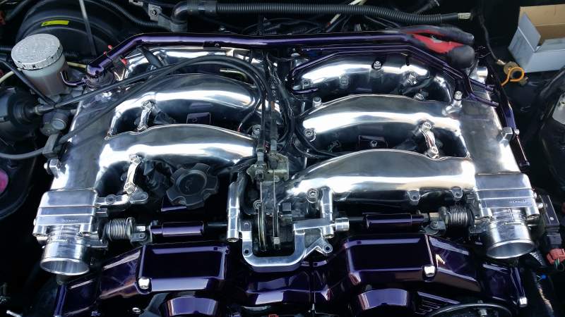

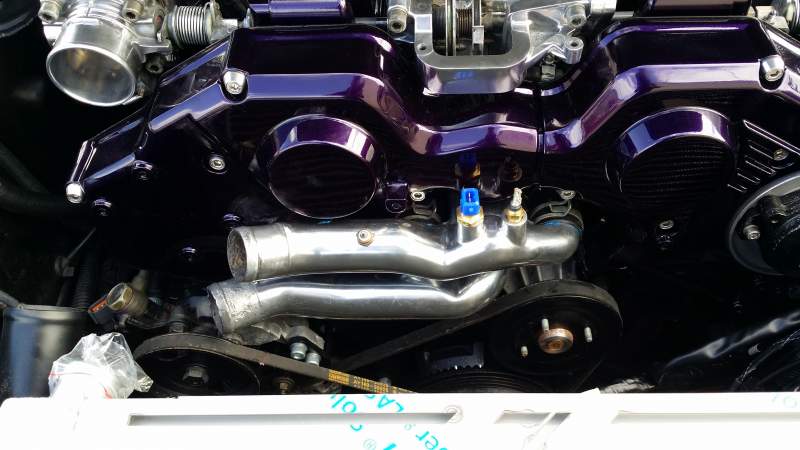

Got a fair few hours done today at the garage.
Managed to fit all my new polished bolts for the coil packs and plenum :

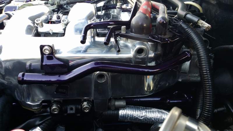

Fitted my new wiring harness bought from wiring specialties :
Also test fitted my new z1 polished hard pipes, although I now have an issue as z1 sent me incorrect
clamps for them and it will cost too much to send it back and I bought them nearly a year ago.

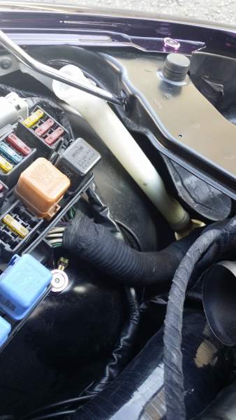

You can also see from the pic above I have a buggered battery loom as the end snapped off and its now too short.
So if anyone feels like donating a loom to me or an easy way to fix this let me know.

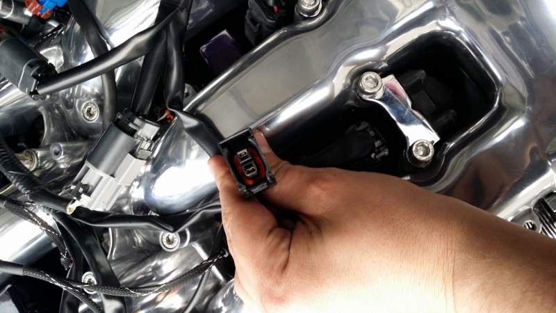

lastly anyone help identify this plug on the loom ?
There is one either side of the plenum and my old loom never had them.

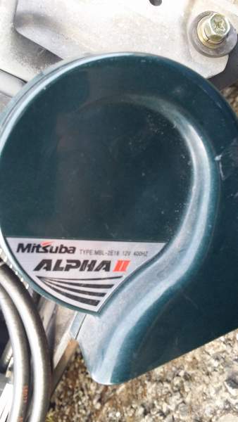

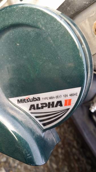

problems with horns, got two of these horns and I can't mind if the second terminal on them has to hook to ground or not.
Anyone seen these before ?
They also seem to be at two different frequencies so I'm wondering now what they sound like together.
Got them both of my last breaker and were better looking that the oem model.

i have a large crimper mate if you knew the size of the cable you could get a straight through crimp and heatshrink over the top of it. I use it to crimp much larger cables than that
if that's the bit your talking about that is lol
Edited by zerocooldel
To be honest I broke this a few years ago and had a temporary fix by joining the cables but it was with a screw
clamp and I never liked the join and it didn't look too professional and I could never find the same gauge of wire.
Not even sure what the proper gauge is but what you suggest could be the fix if I can get some proper sized cable.
we used it to crimp ends on mains cables 120mm thick, problem with screw connections is the loosen with vibrations over time the crimp would be solid, you could renew the length of copex that runs along there and keep the heatshrinked join inside the copex. if its 20mm copex I have plenty of that, I also have various cable I could compare it with my car if we don't know the size to get a good math
Loving this thread, you are doing an excellent, inspirational job.
Just wondering if you have done anything to that lovely manifold to stop it oxidising. What's the preferred method - anodising, plating, painting...or elbow grease as and when??
Elbow grease it will be and a little patience in doing it each time.
I was so hoping that would not be the answer!

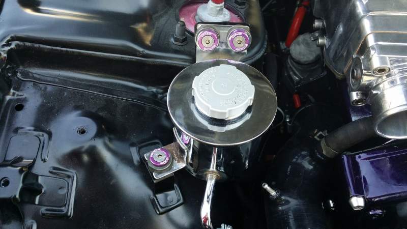

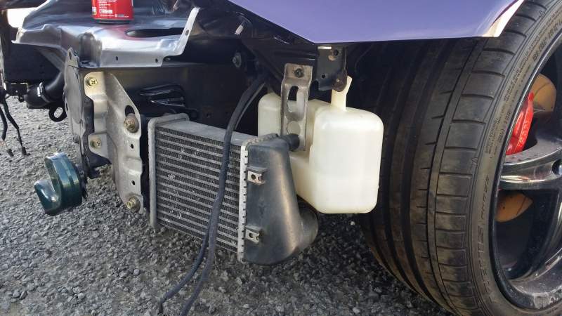

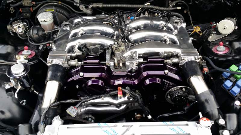

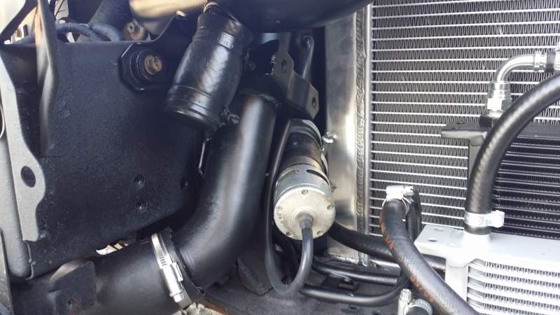

Another few hours done today in the sun and managed to get a couple of more things ticked off the list.
Firstly the radiator expander tank which I nearly forgot about and found in a box.
Then found the filler spout for the main washer so attached that too :
While I was doing that the wife kindly bolted up the pas pot
And finally hooked up the dump valves which i'm sure Si would approve of, lol
[ATTACH=CONFIG]87981[/ATTACH]
[ATTACH=CONFIG]87982[/ATTACH]
Iff its plastic mate its going to need its own earth (second terminal)

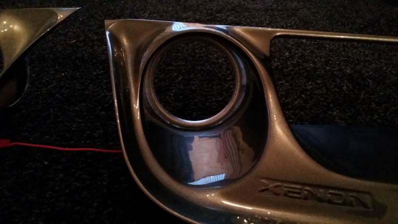

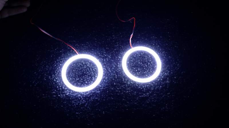

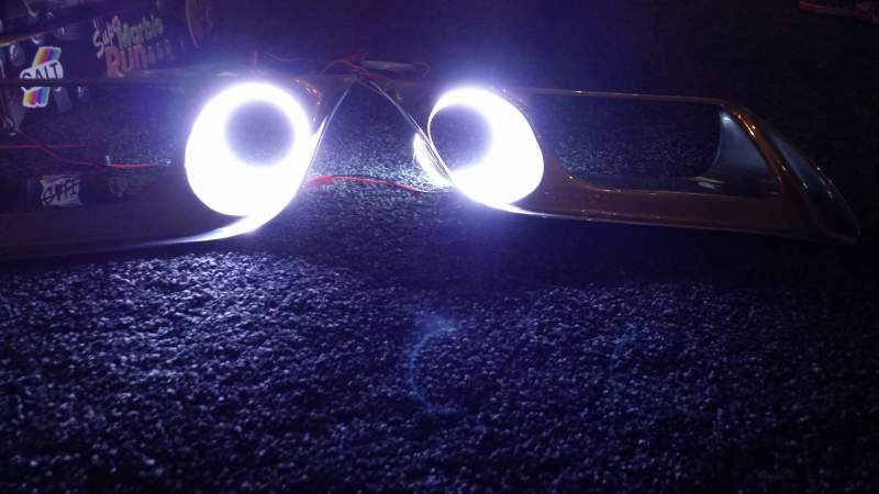

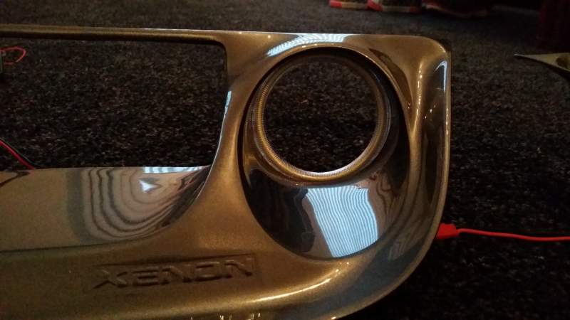

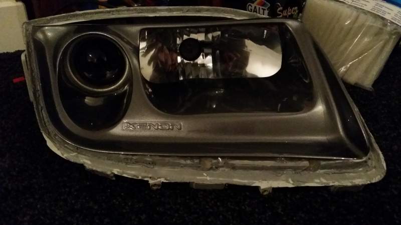

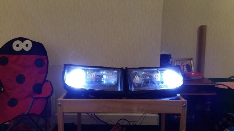

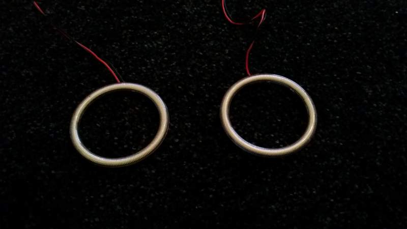

So my new halo's arrived at work today and I'm mightily impressed by them.
They took about three weeks to arrive but when powered up they give of an intensive bright white light.
Used hot glue to fix them in place then powered them up and got the wow factor.
They are not a perfect fit so they are balanced on the back then glued together but that is mainly because
the inserts themselves aren't perfectly circular which is a shame as the they would be a perfect size.

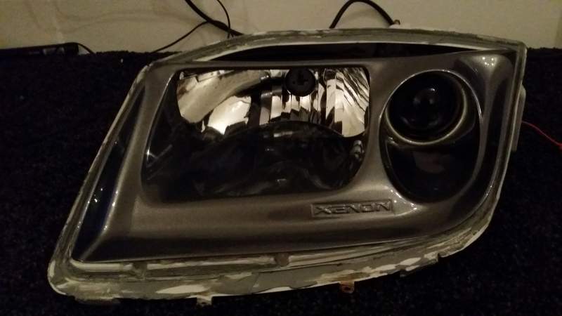

next job was fitting everything back together which was a wee bit of a struggle for me to get
everything aligned and looking proper but I got there in the end.
Sealed everything up with a special primer and epoxy made for windscreens which was a bit messy.
Only thing I regret is that the epoxy can be seen from inside against the white plastic which I wish
now I had painted black for a better finish.
Altogether for my first headlight rebuild this was good for me.
