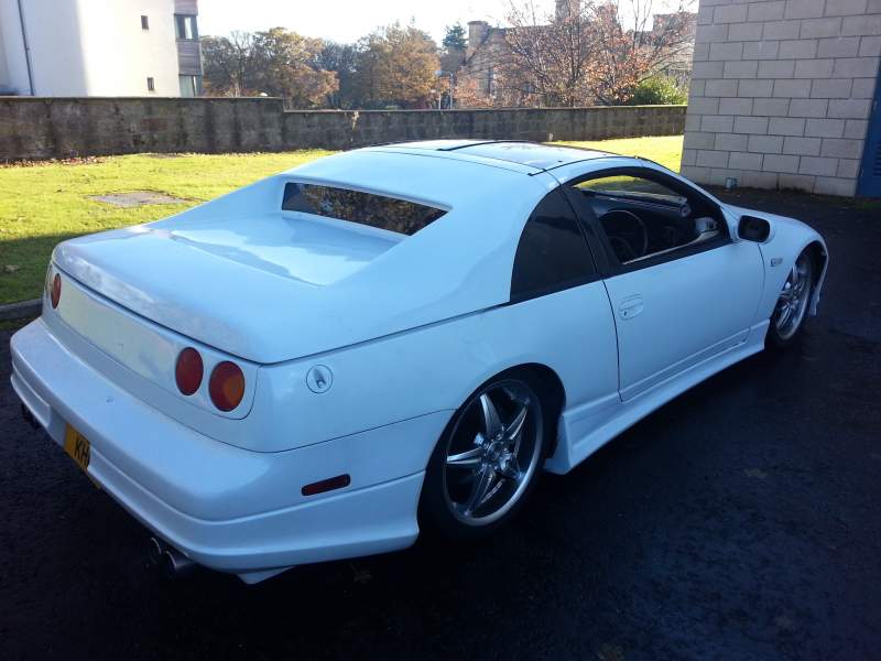

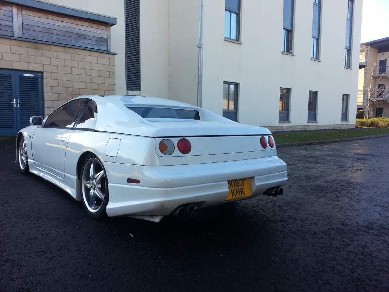

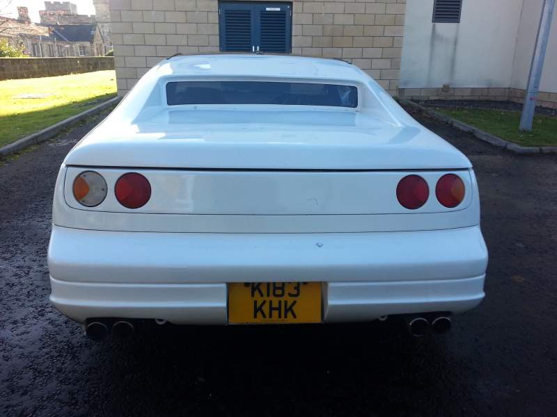

I used to have the tailgate 'tub' on my old blue Zed. It fits into the existing tailgate, in place of the glass. It had a small perspex window. I would imagine it is quite a bit lighter than the original glass but have never tried to weigh the two
It does not fill up with water, unless you happen to park on a hill facing downwards :laugh:
Incidentally, the visibility out of the small rear perspex window on my old Zed was a lot better than out of my stock tailgate I have now!

Tub looks naff
