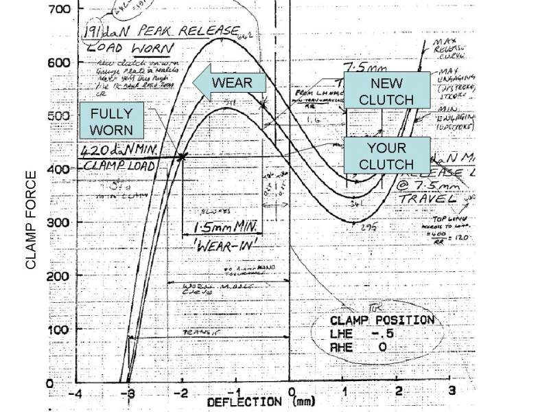

I once had a job as a OE clutch designer and designed landrover clutches amongst others. Without going to technical, the clamp force is shaped like a bell. Starts low, increases and then decreases to the point that it slips and you need a new clutch. A new clutch is designed with a balance between clamp force and clutch life. If you get it wrong, you'll not be able to drive a new car up the ramp of the transporter. Aftermarket clutches are usually copies or designed with less OEM support so things such as tolerances may be unknown and assumed.
What I'm getting at is the more it slips, the more it will wear and therefor increasing the clamp force untill it stops slipping.
Does this make sense or shal I draw some pictures?

I think it does, as it slips it is running right allong the "lifespan of clutch" axis to the bit where it works properly. Then eventually it will wear out. So it is a self solving problem.
Yes, assuming its not something elce.... I'd suggest just to keep using it and if it does not get any better, then look into what elce is could be. I'll try to dig out some old technical drawings with the graph that shows how a new clutch clamp force is just a bit more than a worn one.
This may help with understanding my earlier comments:
so as the clutch wears, the force increases and then comes back down. This is all due to the unique characteristics of the diaphragm spring.

Wow, proper engineering notes ther thank you.
