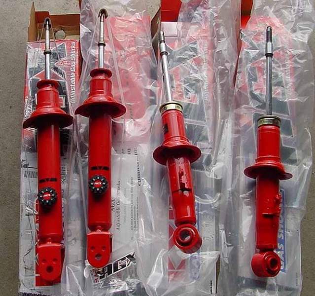

First thing I did before I fitted my KYB adjustables was strip off the yellow and paint them satin black. Which wisecrack thought that yellow was an awesome colour for suspension components is beyond me.
The driftworks stuff is orange, orange...
Yeah, worst idea EVER! If I ever buy any Driftworks stuff, it'll be going straight to the powder coaters before it goes anywhere near my car.
