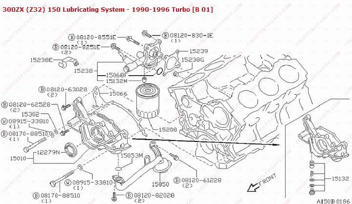

So I've had a pesky oil leak for some time now, it's got to be dealt with. Sadly it's in just about the worst place possible, the oil filter tree. So today I started, I've learnt a few things already.
It's damn near impossible to remove the top bolt of the starter motor without a 1/2" UJ, I say damn near, I did manage it.
Next up the top two down pipe bolts also require a 1/2" UJ (guess what I'm off to halfords for tomorrow afternoon)
In summary, the actuator arm completly blocks the top bolts of the filter tree, and the bolts to remove the actuator are also in a PITA location, hopefully removing the water pipe will allow access.

I take it from the picture you used some sort of sealant on refit? I haven't as it doesn't say anything about it in the manual, also I didn't have any in stock. All im worried about now is the tree being on square etc as obviously there's not enough space to torque them up. I just nipped all four up, then tightened them off, there about 12-15ftlb the FSM recommends I believe, which isn't much.
Actuator clip and 10mm securing bolts still to go.....not looking forward to that I'l be honest.
To be honest I done a complete engine rebuild a few year ago after my main bearings went, I stripped everything including the oil filter housing and refitted using the nissan gasket as manual shows.
However this failed, so speaking to a good mechanic friend about the failure he suggested not using the gasket in case the mating faces aren't square to each other.
He gave me the sealant which he uses on race engines that he builds, so I went that direction.
Hope I haven't given you a dilemma.

Damn blast and feck! It leaks, leaks like a sieve! Currently in the process of tearing it down, much faster this time hopefully. Gotta get some RTV from halfaurds. Can I/should I re use the brand new gasket, with the RTV?

I didn't use the gasket at all just the gasket sealant and all seems to be ok, just be aware that you have to get the bolts tightened up fairly quickly otherwise the sealant will dry and unlikely to seal as intended.
Use the highest temperature gasket sealant you can get.
Yeah I got hold of some 350 degree copper stuff made by Loctite, im going to re use the gasket combined with the gasket. Dry time is 15 minutes, so im going to start with the top one lol, the other three are easy in comparison. Get them nipped up and tweak them off afterwards.

Right this morning I measured the depth of the block thread and the thickness of the lobe on the tree, the two bolts of roughly the same size were roughly 2mm too long, this after the gasket thickness leaves a gap between the two mating faces of 1mm. That doesn't sound right...so I cut 3mm off, chamfered the head and ran a die down the tread.
Then reassembled the whole lot with copper RTV, got them all done up. Actuators back on, but that will do for today I've got too much to do elsewhere round the house.

Sounds like you have cracked it Steve with trimming the bolts:yes:
I'm shocked it sealed as well as it did. More bodged work from the derby based scrapyard. I'm not counting my chickens just yet though lol, I was confident last time...
