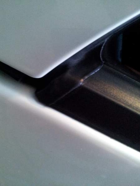

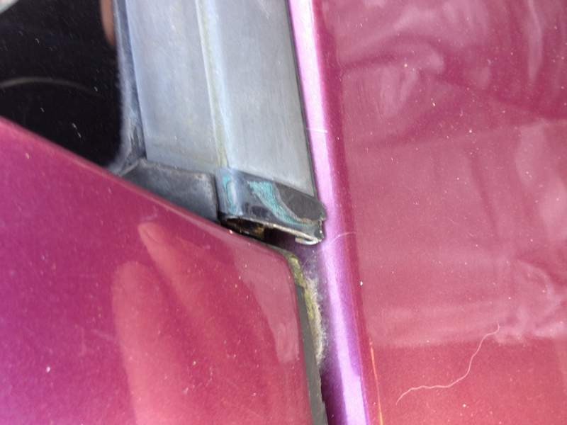

Well today I was doing some bits to the boot trim and noticed someone has pulled off the end of my O/S rear quarter window rubber...... was there last week.....
and the N/S lower window trim is bent out as though someone has tried prying it out...... Sooooo annoyed as these were in reasonable condition......
Now it looks horrible.... why would anyone do this.....
Anyone have these that I could buy???

They're actually bonded to the rear quarter seals, so if you bought some, you'd have the same issue. Best bet is to lay masking tape over the bonded seal area and use black silicone. Smooth it off with a wet finger and take off the masking. It should leave you with something that looks like it did when it was new.
For reference, it should look like this, moulded into the seal. Generally, when you'd replace the lower trim, you'd peal up the bond and reseat it on the new trim (non-OEM as Nissan will only supply you the rear quarter complete). Your seal has broken leaving you only one option which I stated above....otherwise it's new/replacement rear quarter window time....

That doesn't really make sense. You have to repair that area with sealant and nothing else. That actual seal is bonded to the rear quarter, you have to slice it off with a knife and it messes up the seal as it's rubber/metal composite or are you talking about the lower trim?

It`s possible someone thought about popping your window russ..stupid but they generally are. If it`s any consolation i`m in the same boat. Mine just rotted off. A silicone repair looks like the best option
