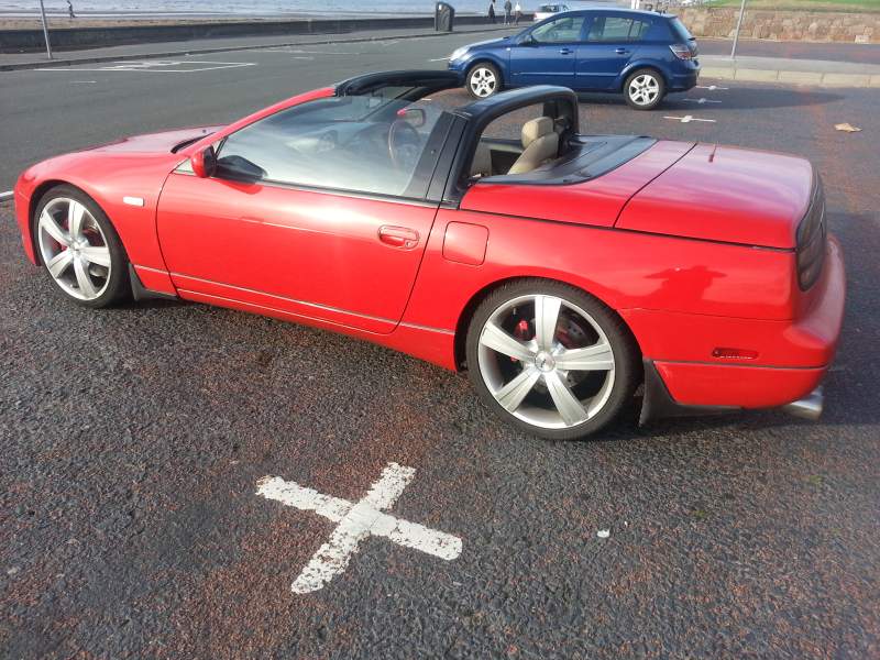

They don't look too bad, but that's probably because they are thin. Normal chunkier ones will look silly.
doesn't the handling get worse with anything over 18"?
Look again, look real hard. It looks stupid! :lol:

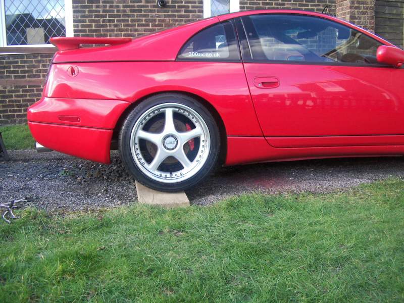

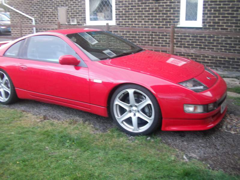

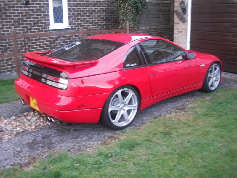

Fab Tanks, what style of wheel are you thinking of getting, got some 19" six spoke wheels I'm thinking of selling,
Pictures of them on my SWB Slicktop.

Sorry dude I was asking fabtanks. I'm sure those wheels will sell easily though. I think they've been well received ever since Apache fitted them to his. Offsets will help a prospective buyer but in this case your pics show exactly what fitment they're getting so may not be as relevant.
